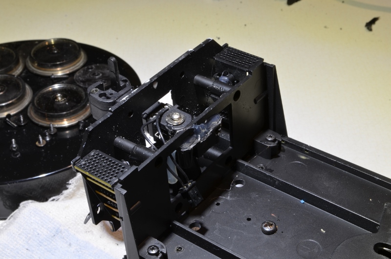

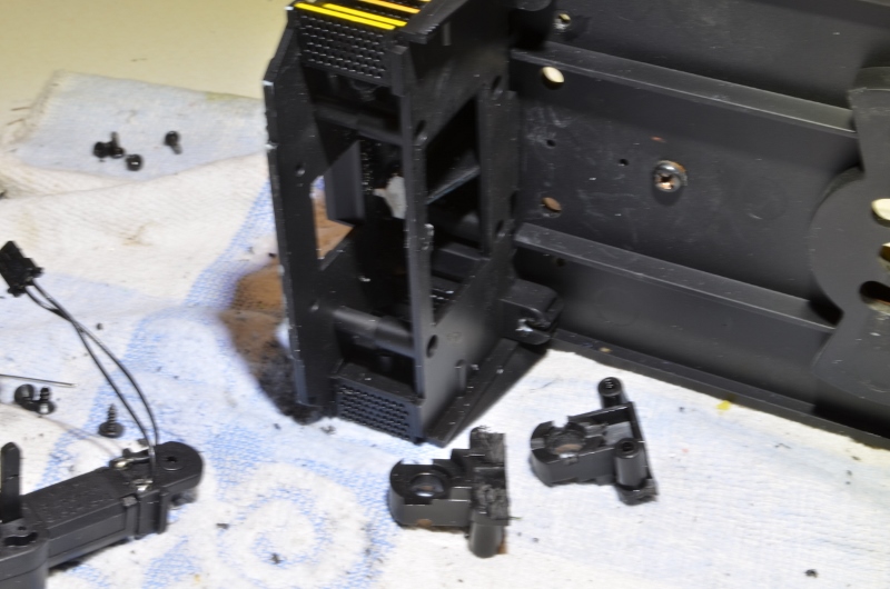

I like the ability of the MTH engines to be able to drop cars anywhere on the layout. I think that's what is one of the biggest features in O gauge. When upgrading other brands of engines to run on my layout, I still wanted that ability in any engine I chose to run and in any position in a consist. Adding the MTH couplers to USA trains engines was fairly easy. I believe I just screwed them onto the screw mount stand on those engines, using their spring mechanisms to keep the couplers straight. Mounting them on the Aristo, there is just a bit more to it.
First, the coupler post gets cut flush so that it protrudes about 3cm from the bottom of the frame. I then modified some coupler mounts I had from a MTH car. They get cut in a plus design flush to the hole so they'll sit flat on the Aristo posts with the posts stiffners locking into them. The bottoms of these pieces gets a notch so that they will fit around the rear pilot piece as they're screw mounts won't work. Hopefully the pictures will help clear up the descriptions.
The MTH electro-coupler doesn't get touched this way and their return springs will keep them straight.
blogentry-10-0-75512600-1365978417_thumb
One other thing that needs cutting is the pilot above the coupler so that there's clearance for the taller electro-coupler. After mounting, I used hot melt glue to help reinforce the assembly. Make sure not to bond to the coupler itself.
