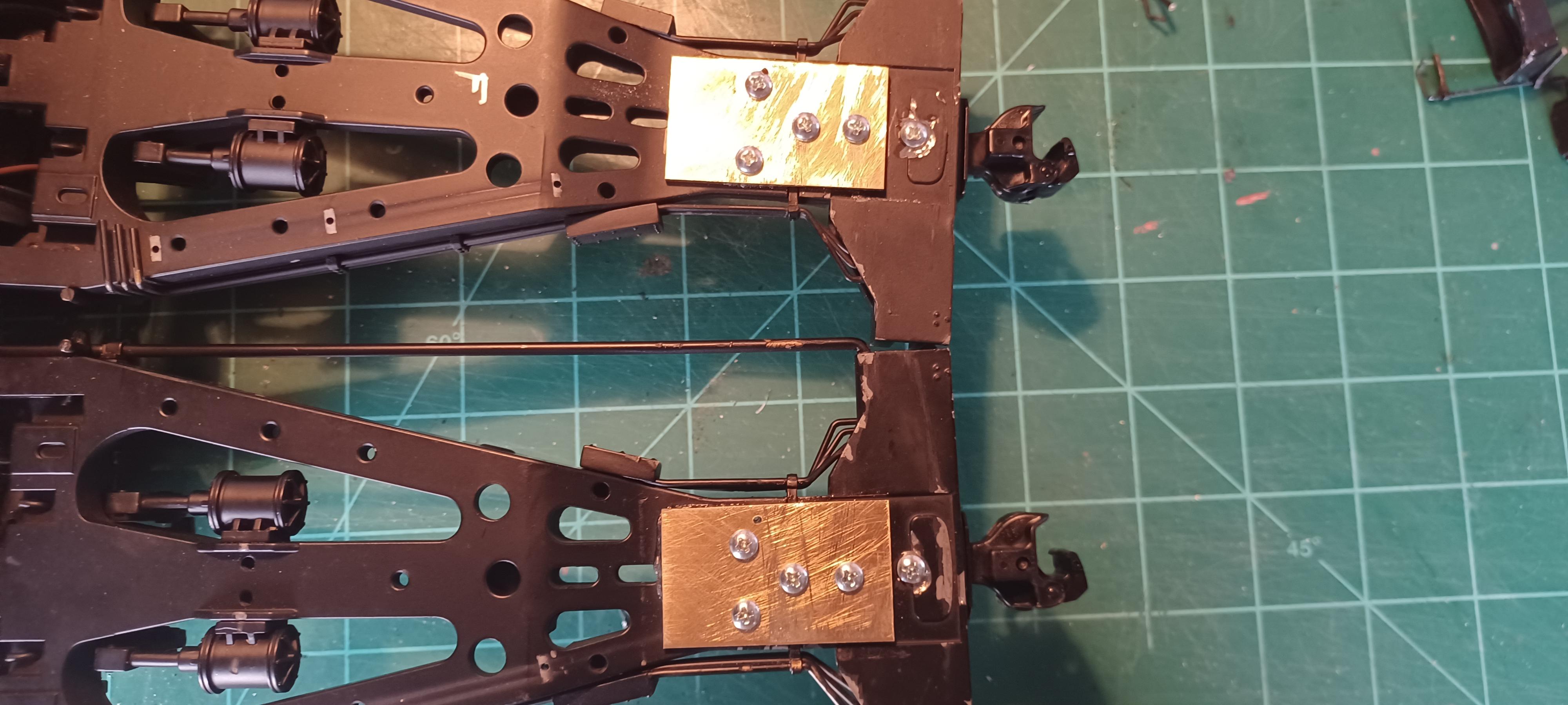

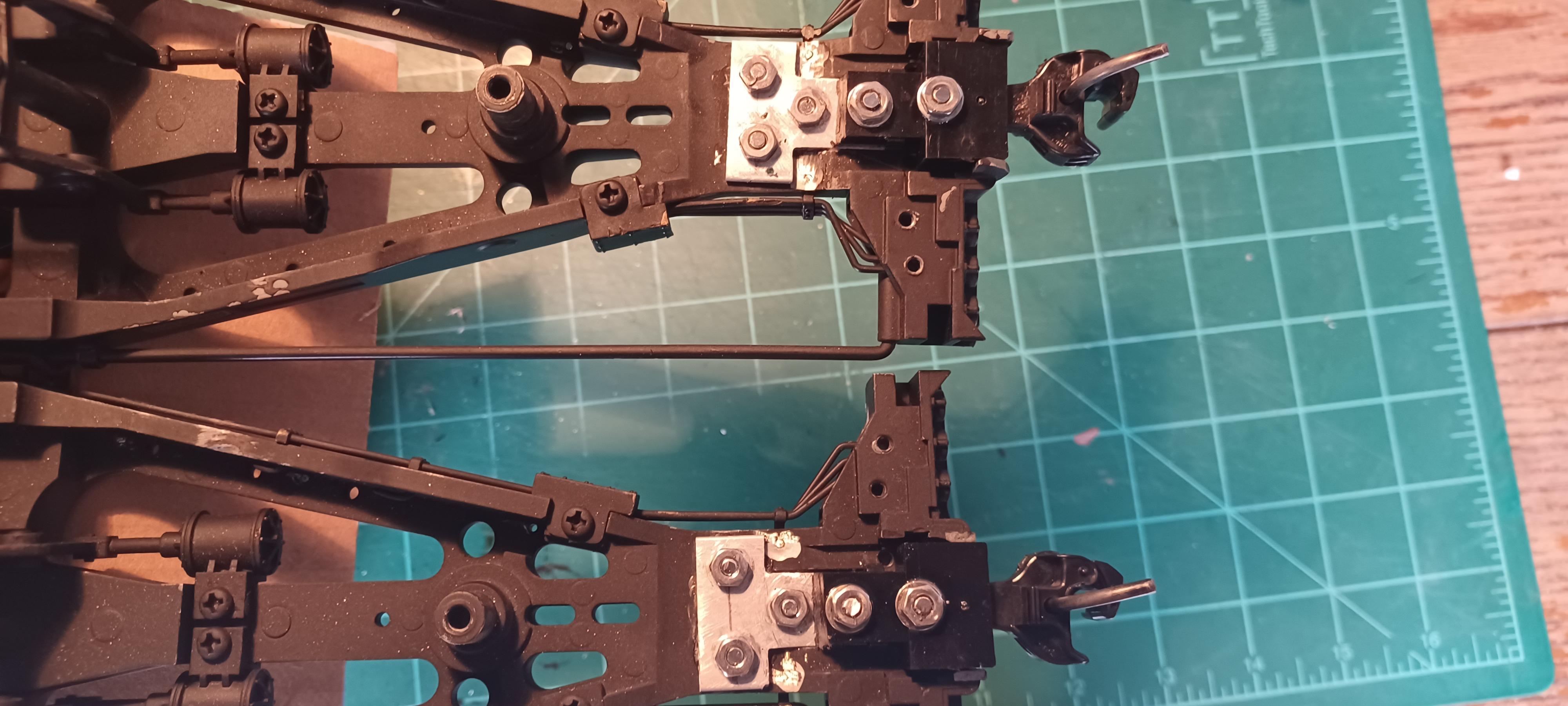

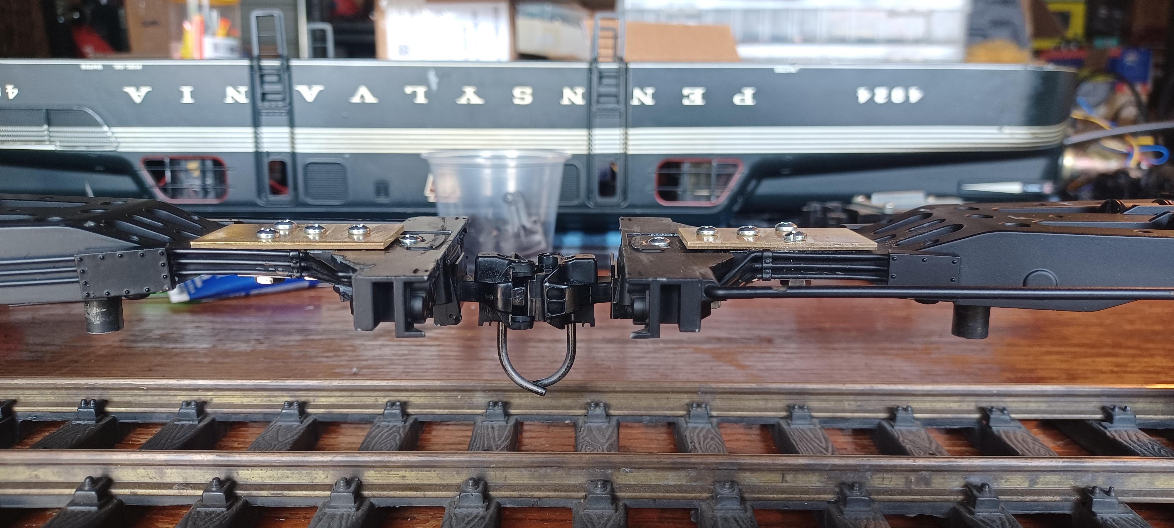

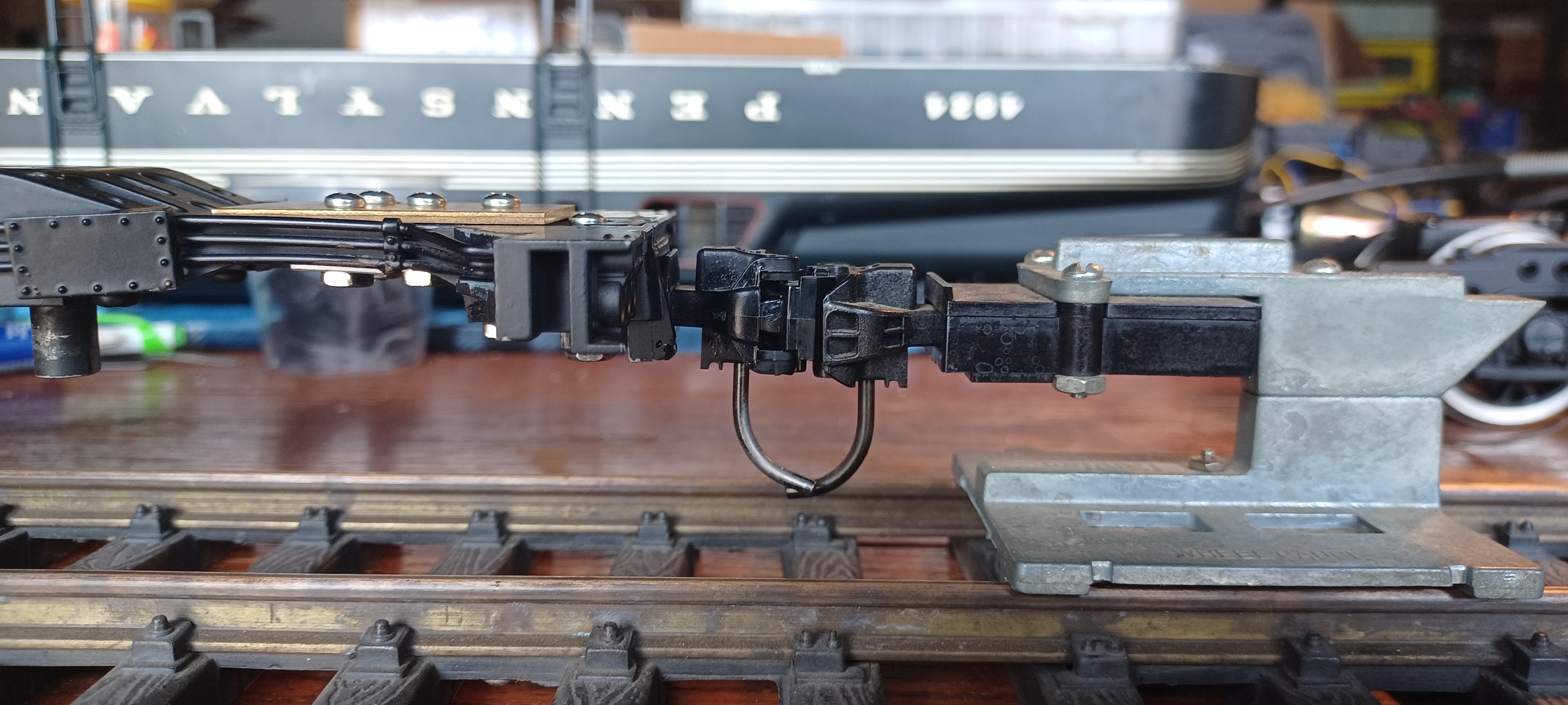

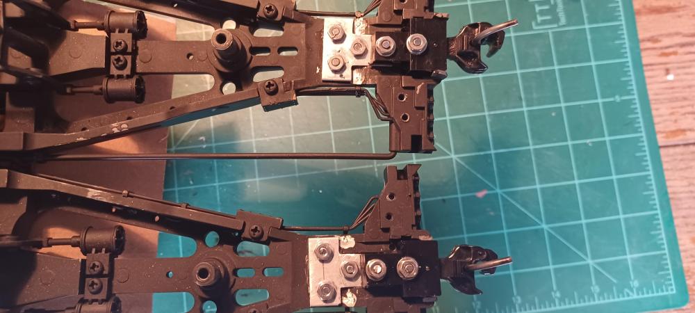

  6. Chuck replied to Chuck's topic in Locomotives
    Finally got back to work on this. I did straighten the frames in a hydraulic press but once they got back to the original shape they both cracked...typical die-cast metal repair headaches! 🤔 So I made reinforcement plates for both top and bottom then mounted with 4-40 screws. For the tops I used some brass plates... For the bottoms I used aluminum.... I use Kadee Couplers which worked out pretty good! And the height is good enough! 🙂 The thing has srung axles so once all put together with the heavy die-cast shell I'm hoping that the ride height settles a bit. Now time to slap some black paint on the repairs!

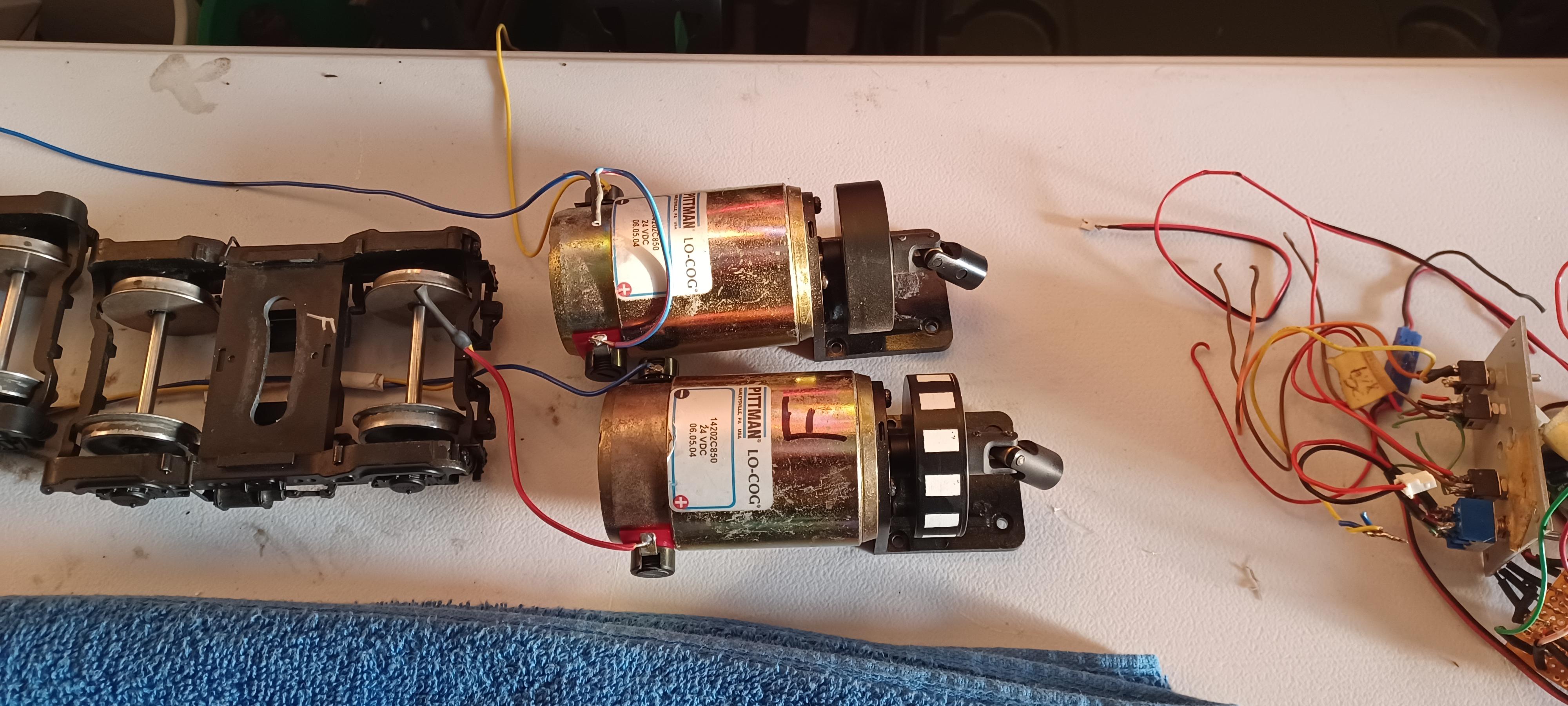

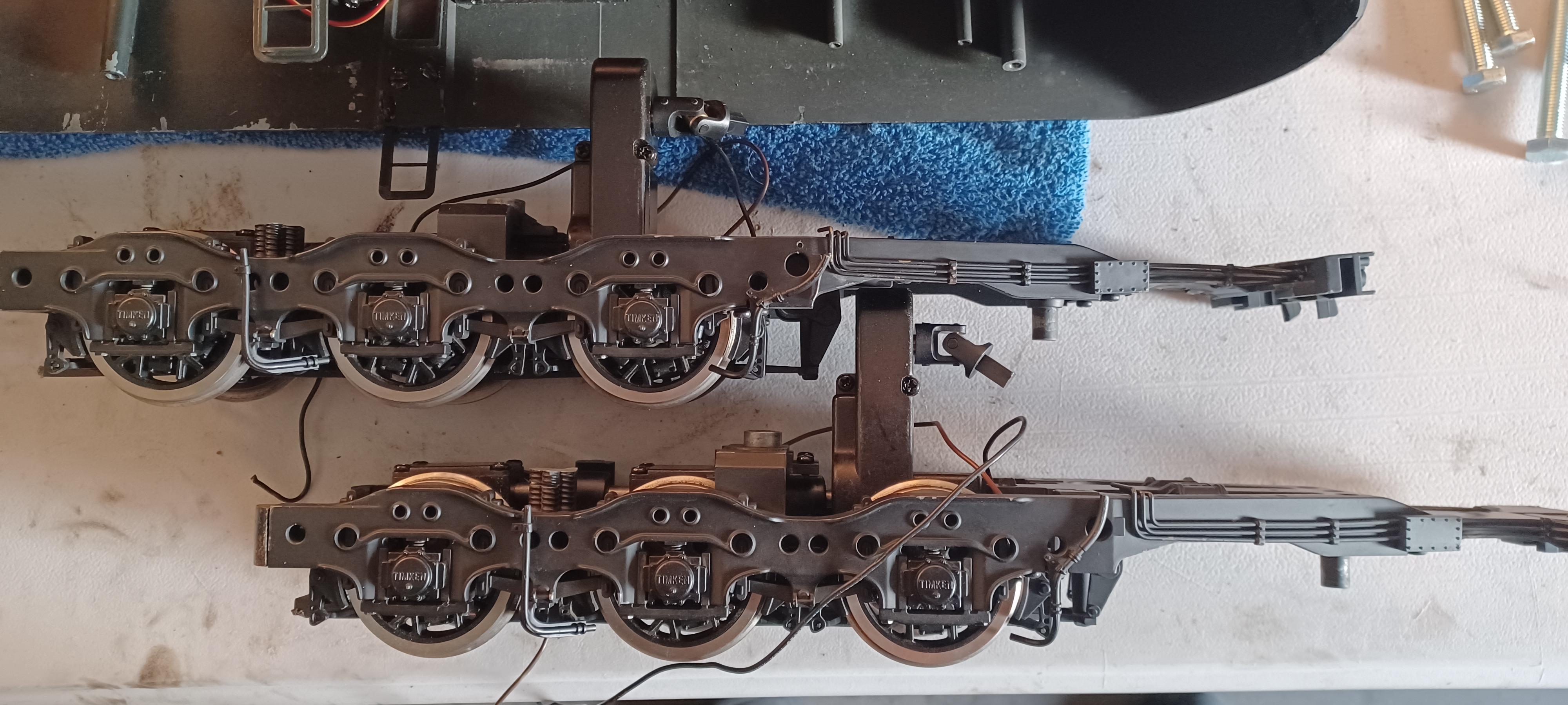

  15. Chuck replied to Chuck's topic in Locomotives
    Well I finally got back onto this project. I straightened the truck frames out and one snapped so I'll mechanically repair it. A change in life event happened last week as I couldn't breathe which ended up being a triple whammy of Influenza B, which cause Pneumonia because of Emphysema/ COPD. A few days in the hospital under Pulmonary Care straightened that out and now go back for Cardiology... USAT used a striped tach for the OEM QSI sounds....
