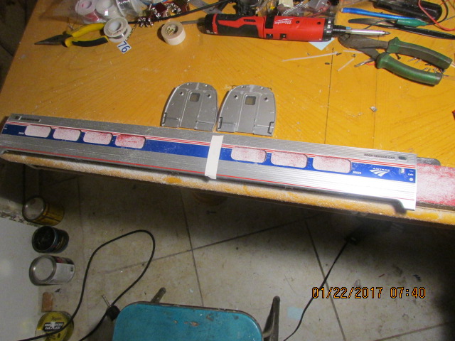

This is all that I have done for today, a side and two ends, lost of sanding. Bob.

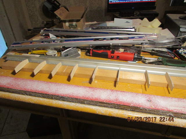

I built this jig the shape of the sides to align the pieces of the side. Sorry, can't find the picture of the jig, but all it is, are 8 pieces of ply, shaped to the curvature of the back side of the side, so that when I glue the bottom of the side on, it is in the correct position. The side in the picture is after gluing. Now for the other side.  Came out very good. Bob.
OK, I found the picture of the jig. This is before the bottom part was glued.  Bob.

Thanks, I was just wondering because they are so shiny, I like shiny things. I would need some real good tutorials on how to apply the foil. I have never used it.  Here is a better picture of the jig for side alignment. Bob.
