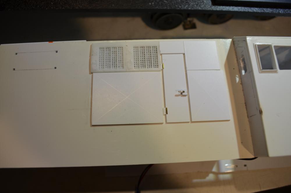

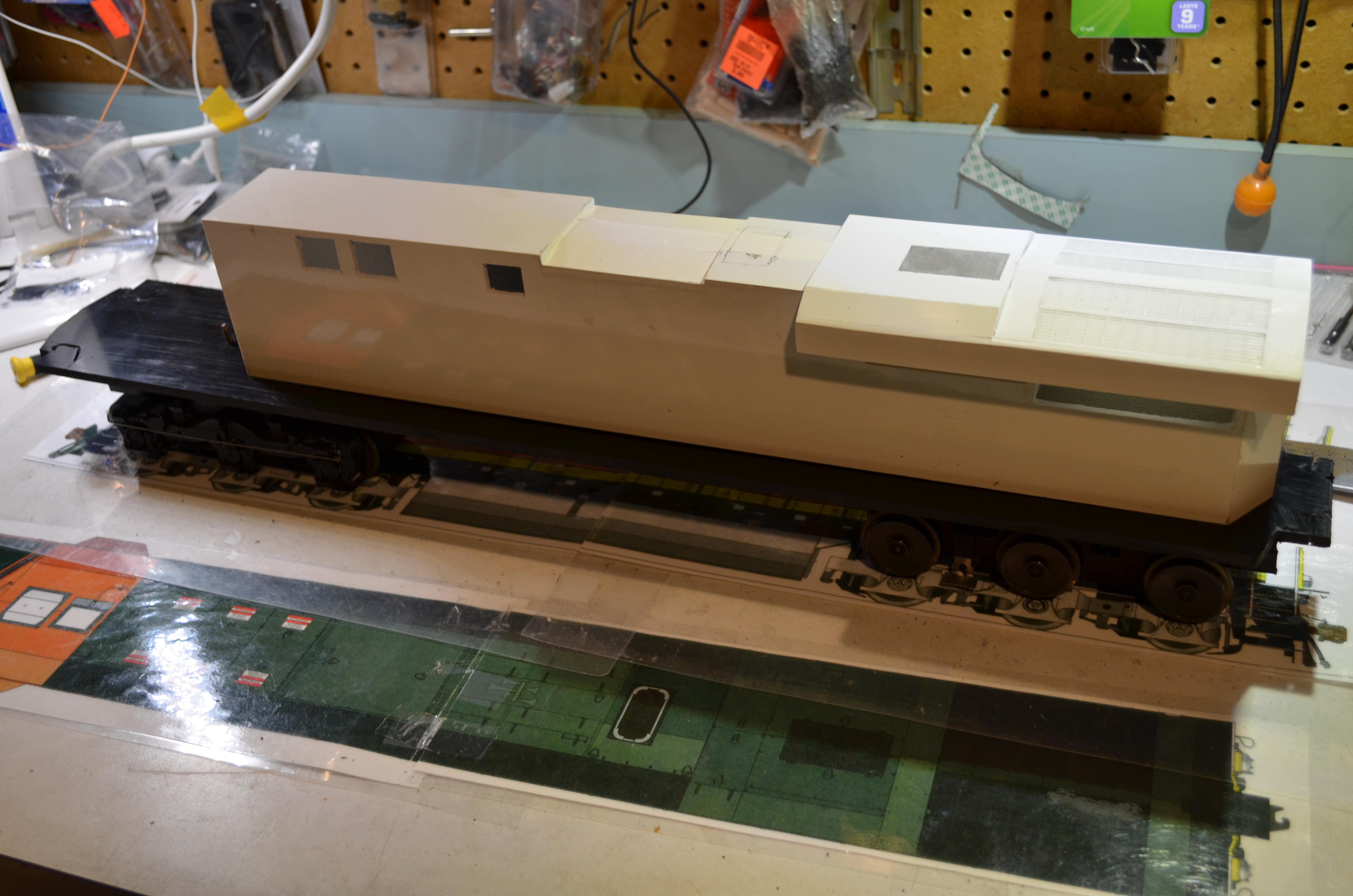

I take some artistic choices with these things and decide what I can do to capture the look the best. After staring at the tops of my MTH dash 8s for so many years, I find the look of the ES44 could be like this:
they're just laid into place for now. I have to decide whether they should be flush or protrude out a bit?
Well that's totally top secret!

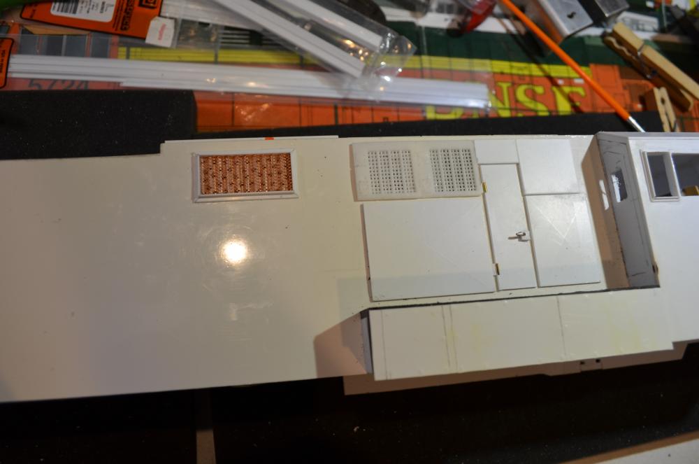

They are hopper car's catwalks that I cast and cut to size. I looked at the top of the Aristo Dash 9 and thought there wasn't anyway I could duplicate it. I looked at the MTH O scale version of the ES44 and saw they used brass etchings. After searching for some time to find the correct looking brass I gave up. So this from above seems to have that look. I may add brass screen if it helps the look.

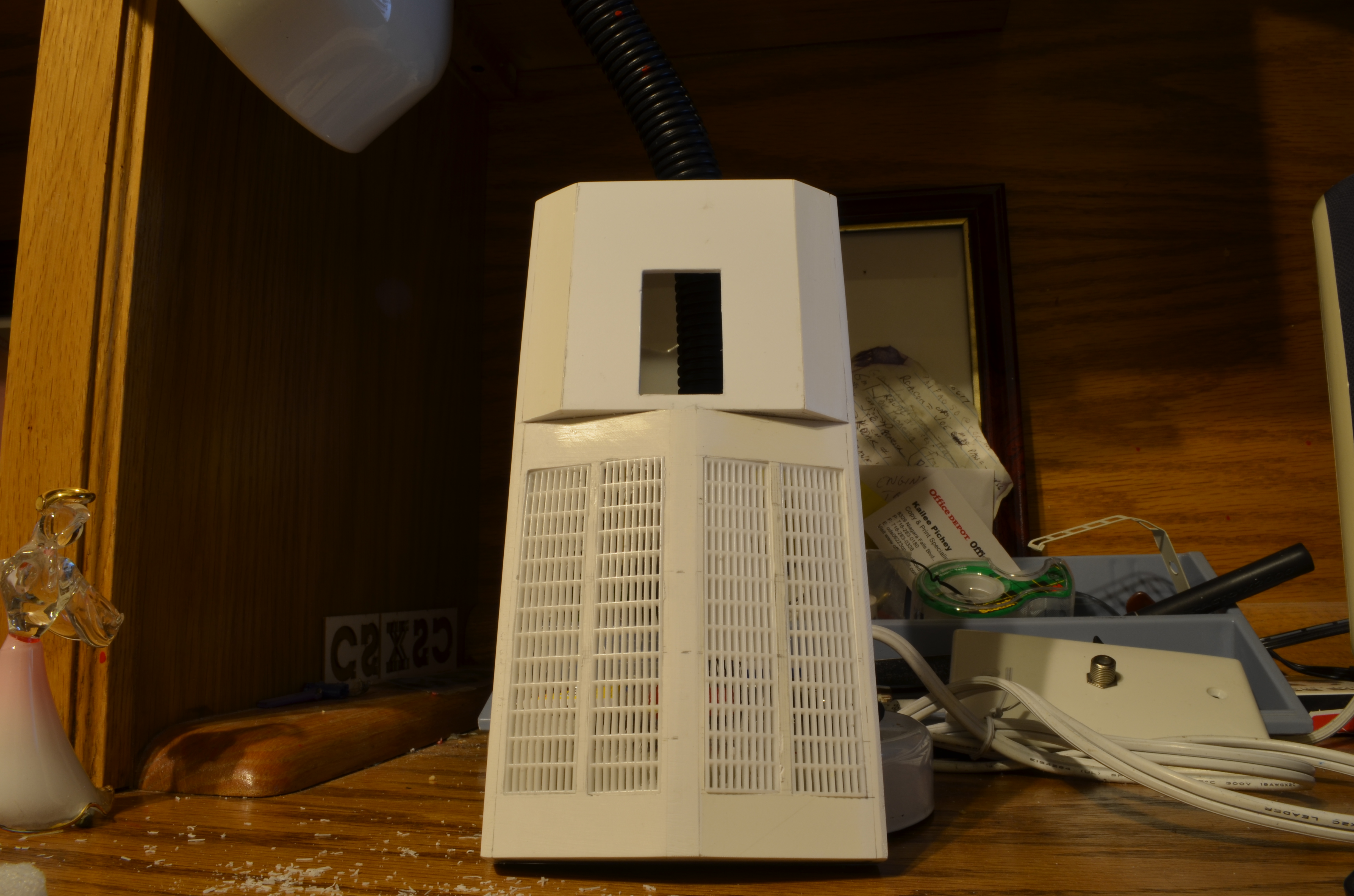

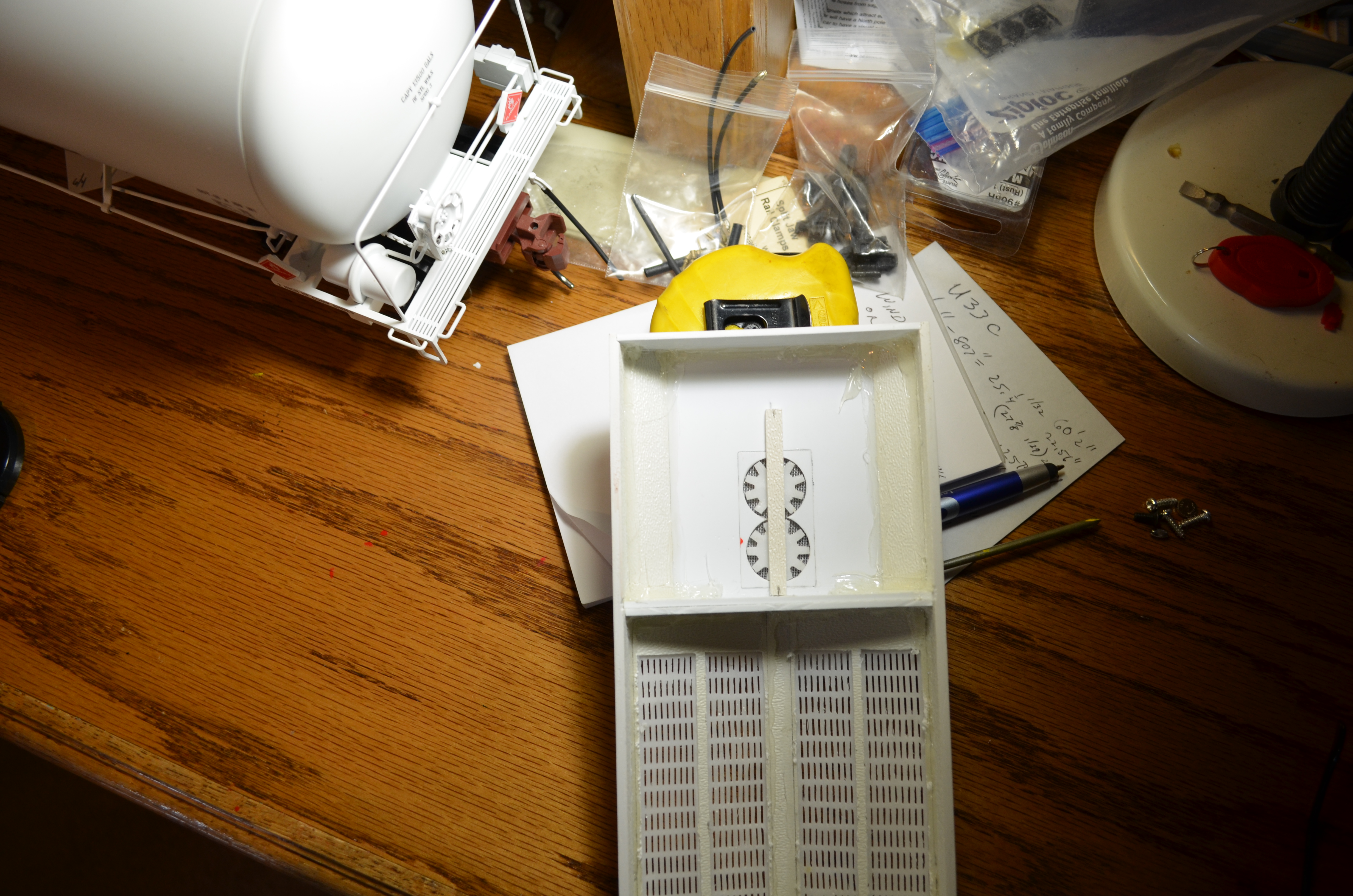

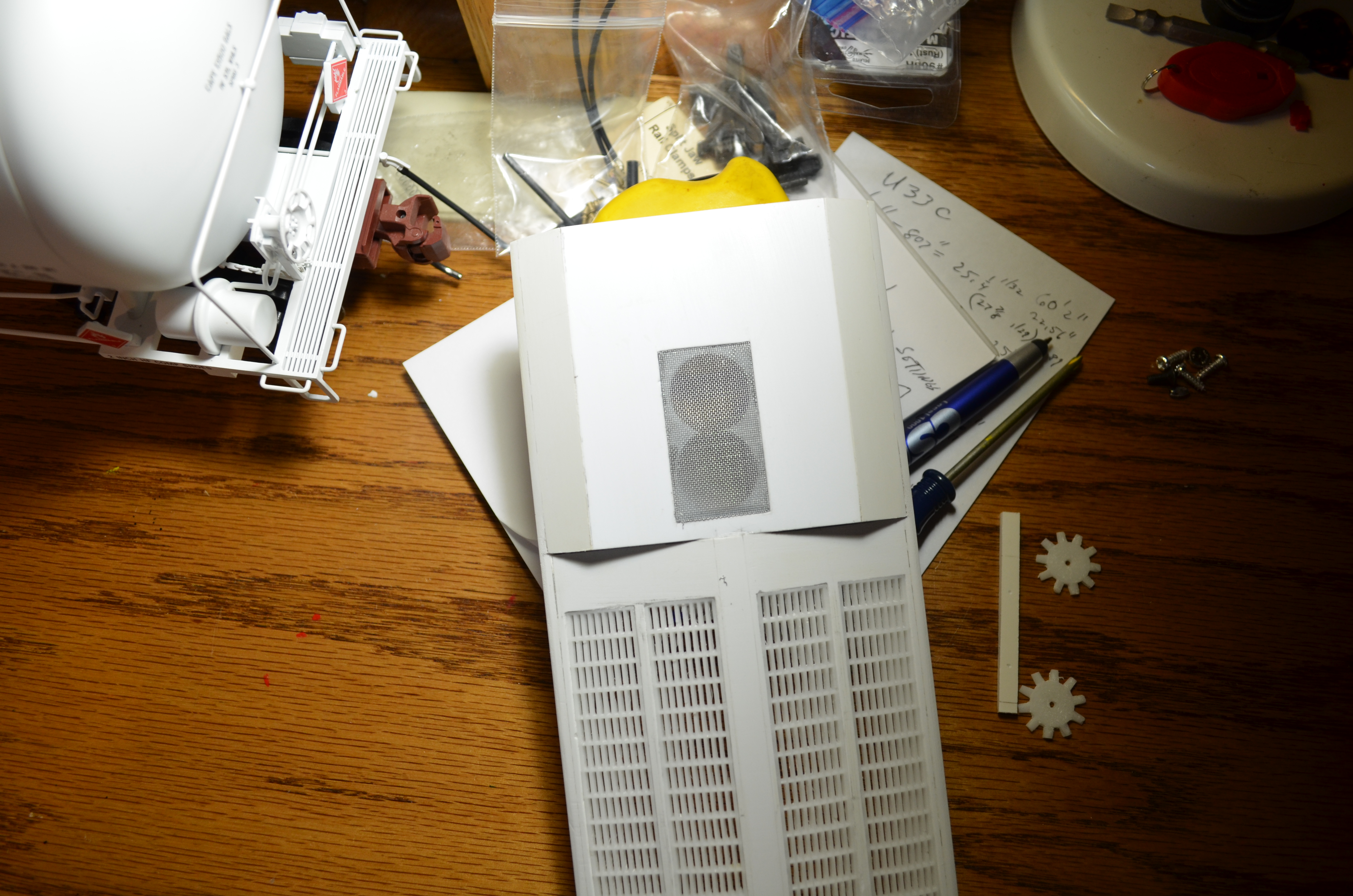

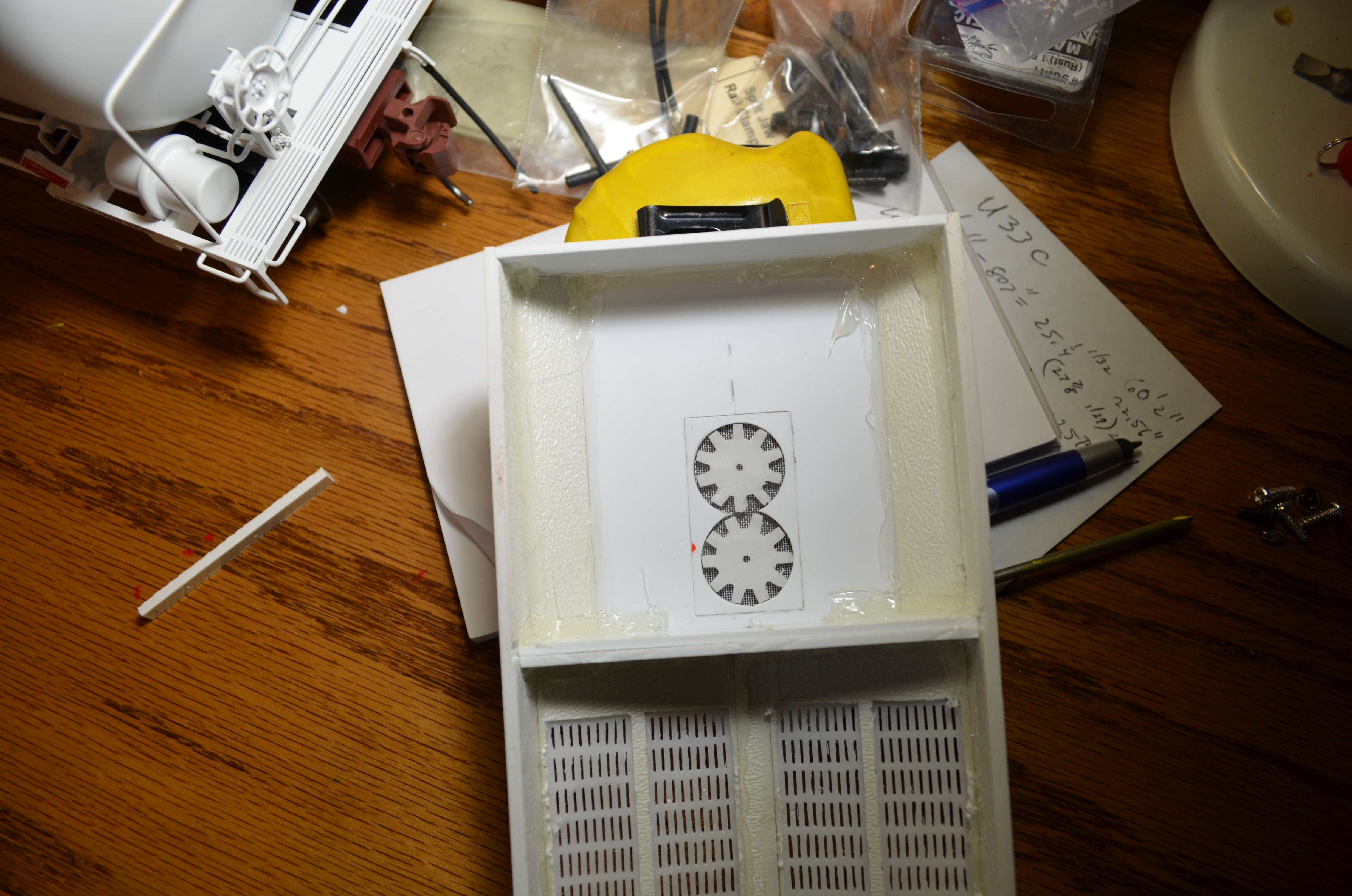

OK, raining again and I'm bored. So I did a little bit more. I cut stuff up for the inter cooler thinger.
I made a plate to fit the hole, cut in 2 circles. Then I attached a piece of fine mesh screen. Filed it to fit.

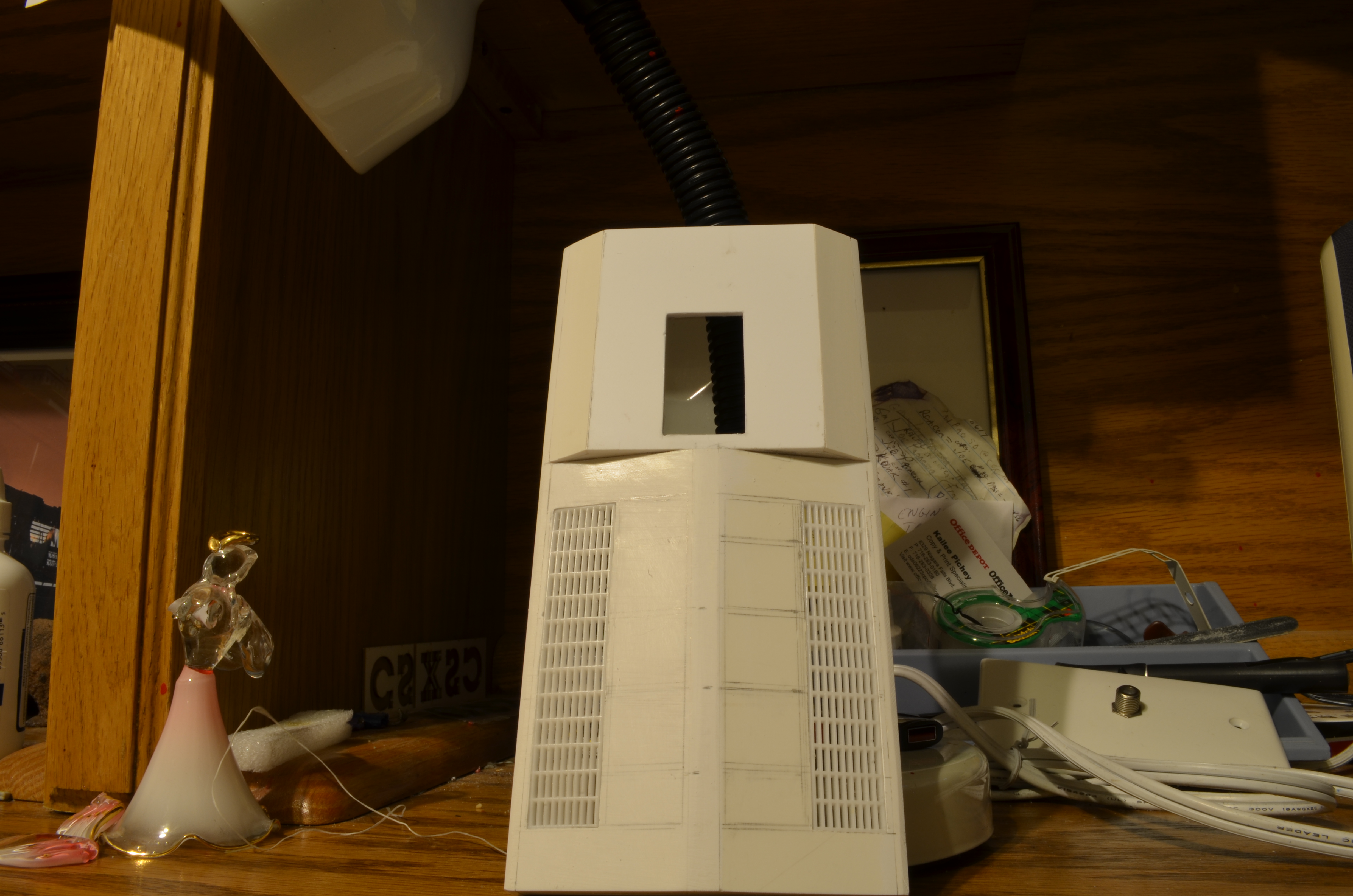

I made a pair of fans for looks too. I will mount them to a scrap bar of plastic.

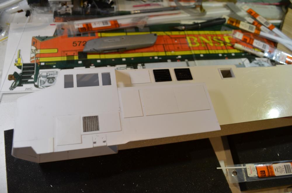

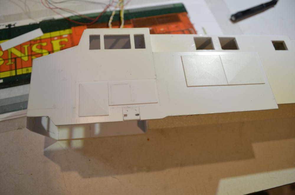

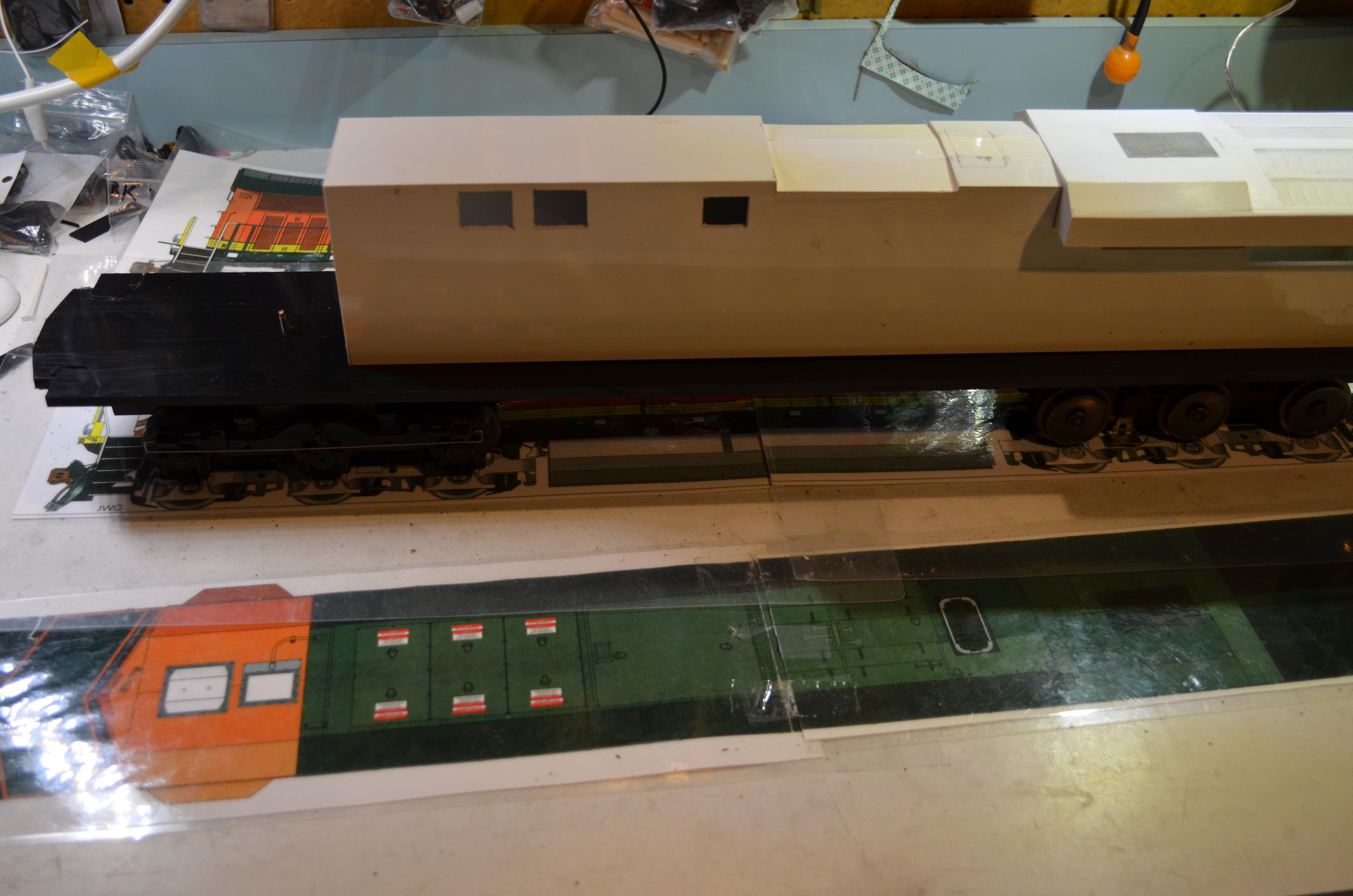

So............ I'm back at it.
It's just the layout stages so be kind.
Soon I'll figure out where to go next! Lots of screens to make.  & I hate making screens!

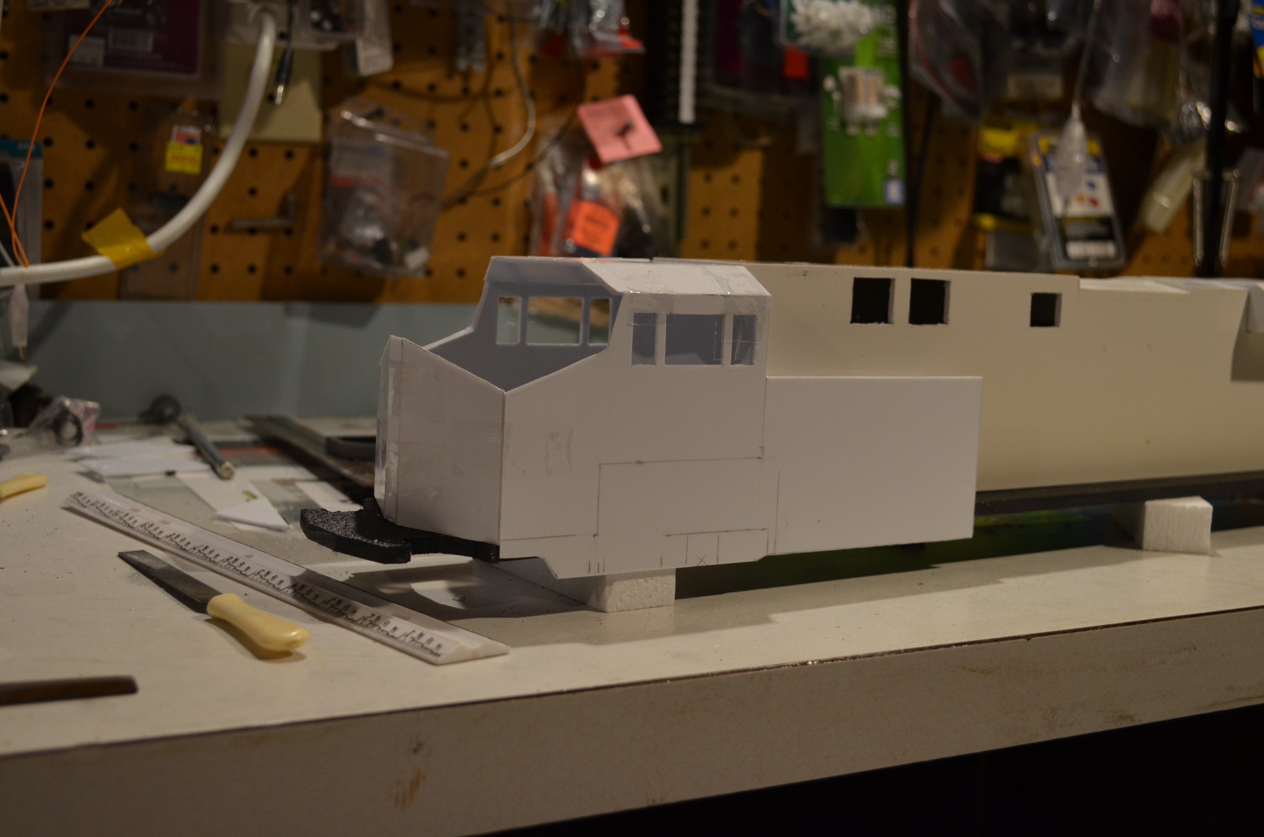

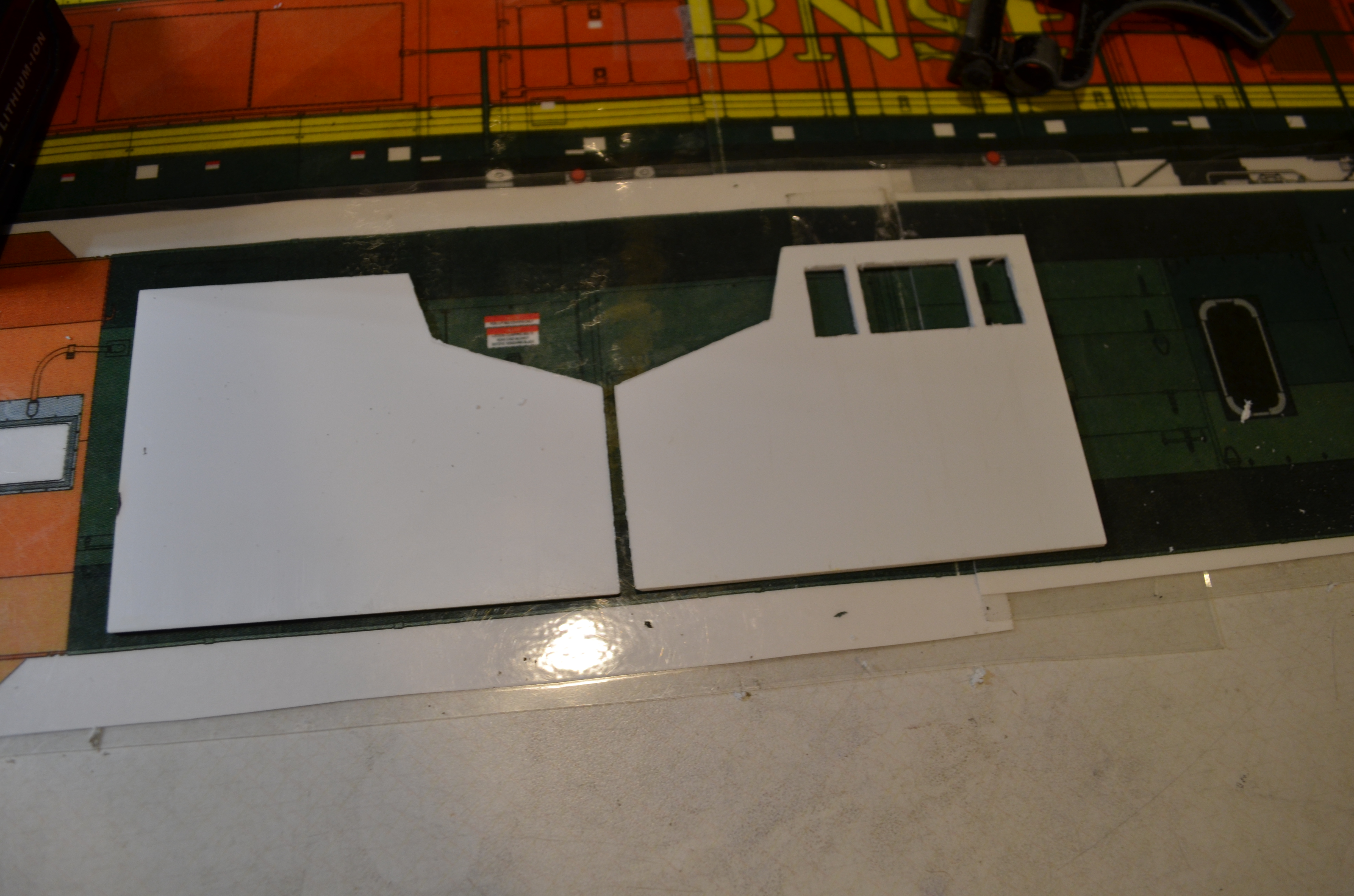

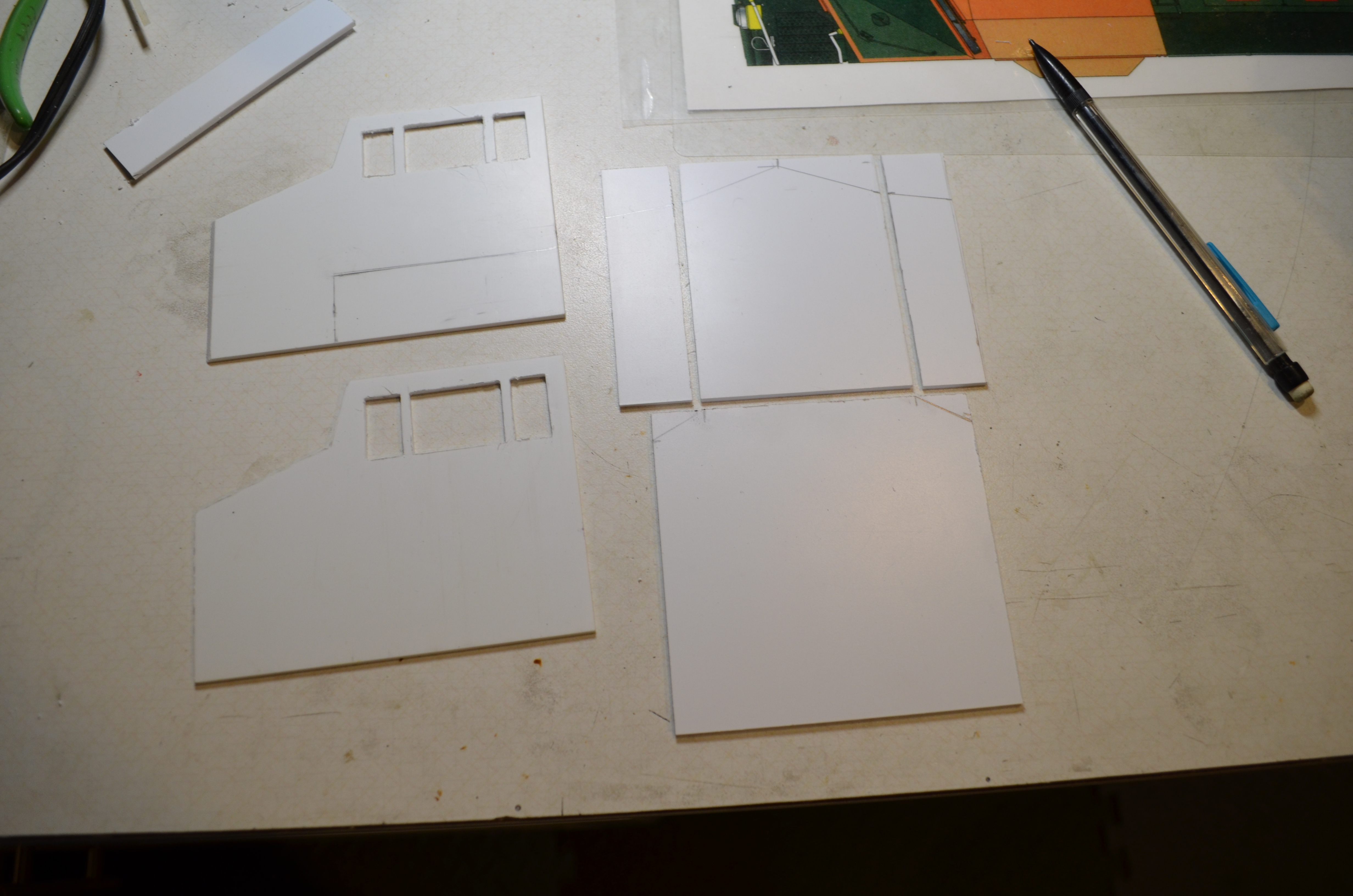

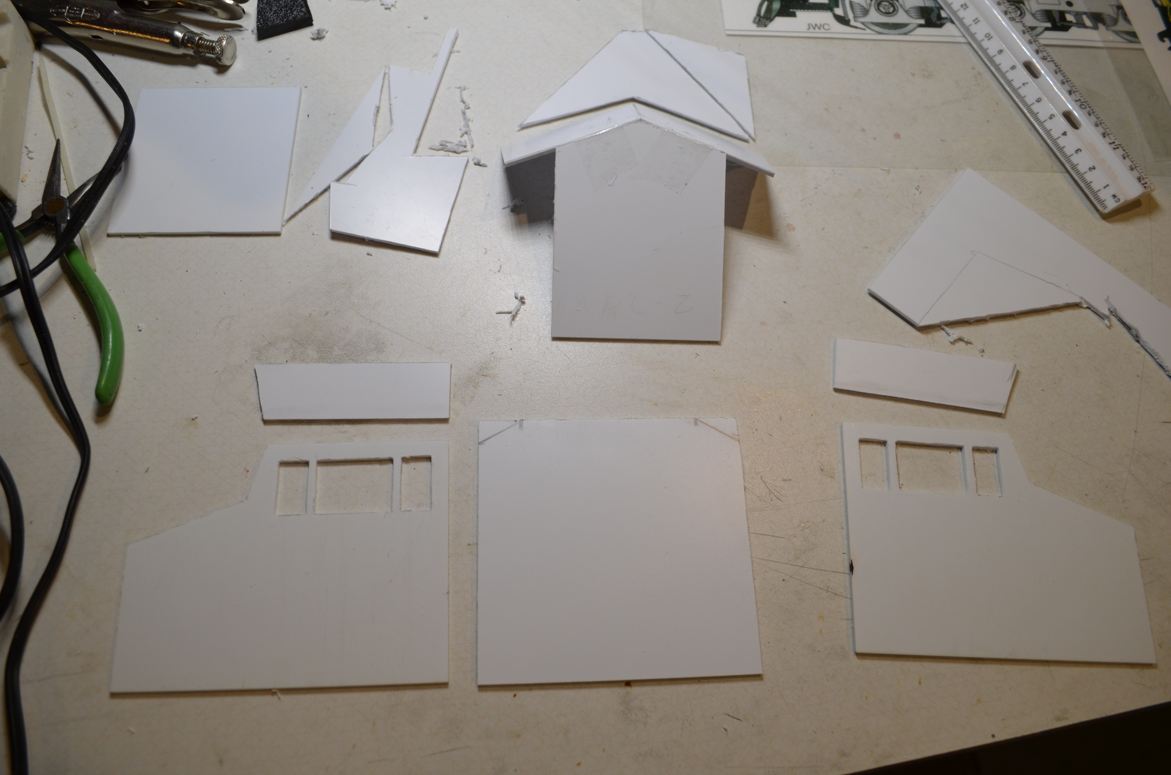

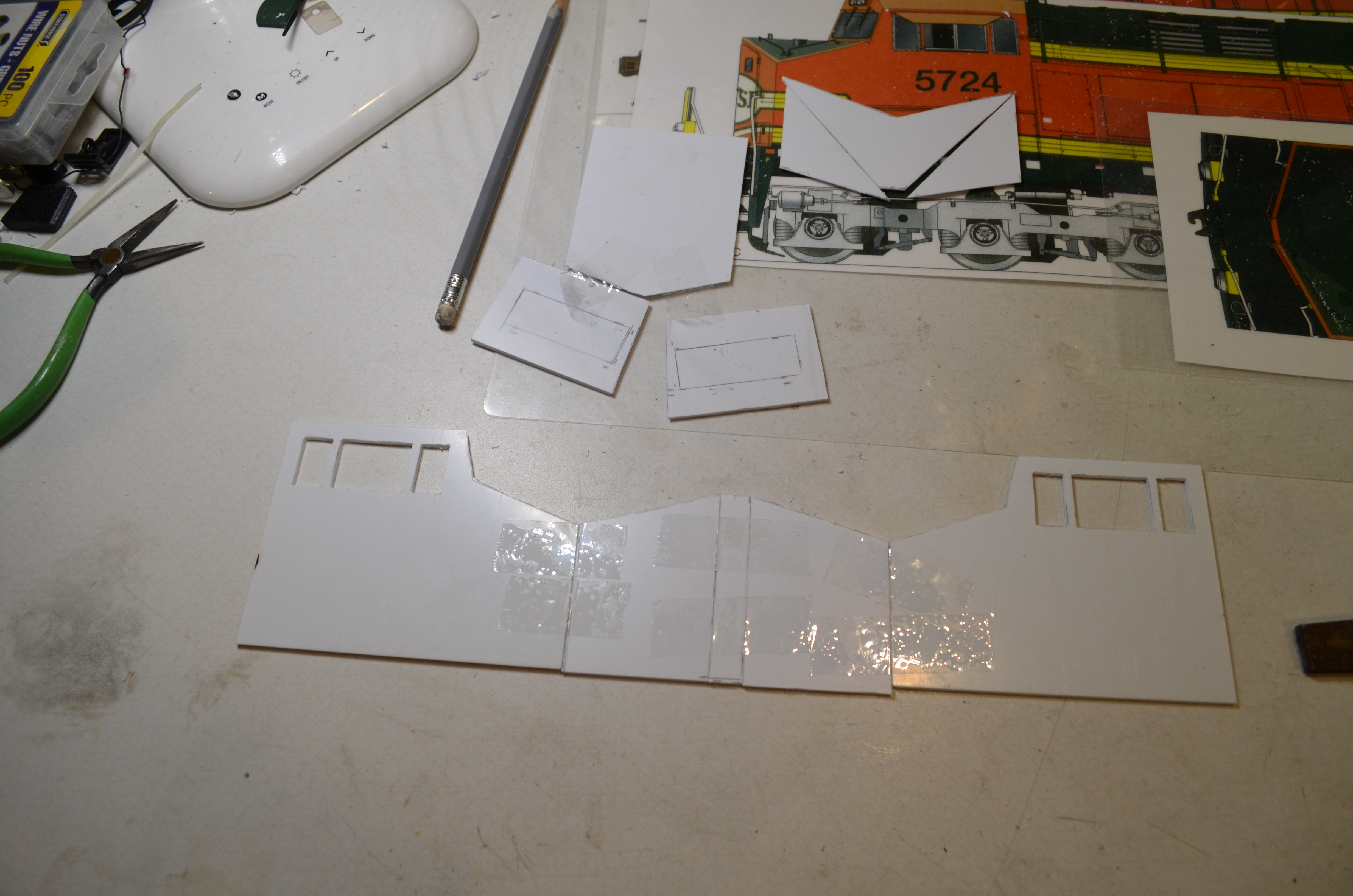

I got several pieces cut and then noticed that they weren't right. The top of the cab is not drawn correctly. I probably should re-cut the sides while I'm fixing stuff. They should have been taller.
I like having a model near to look at. I wish I had looked at it sooner!

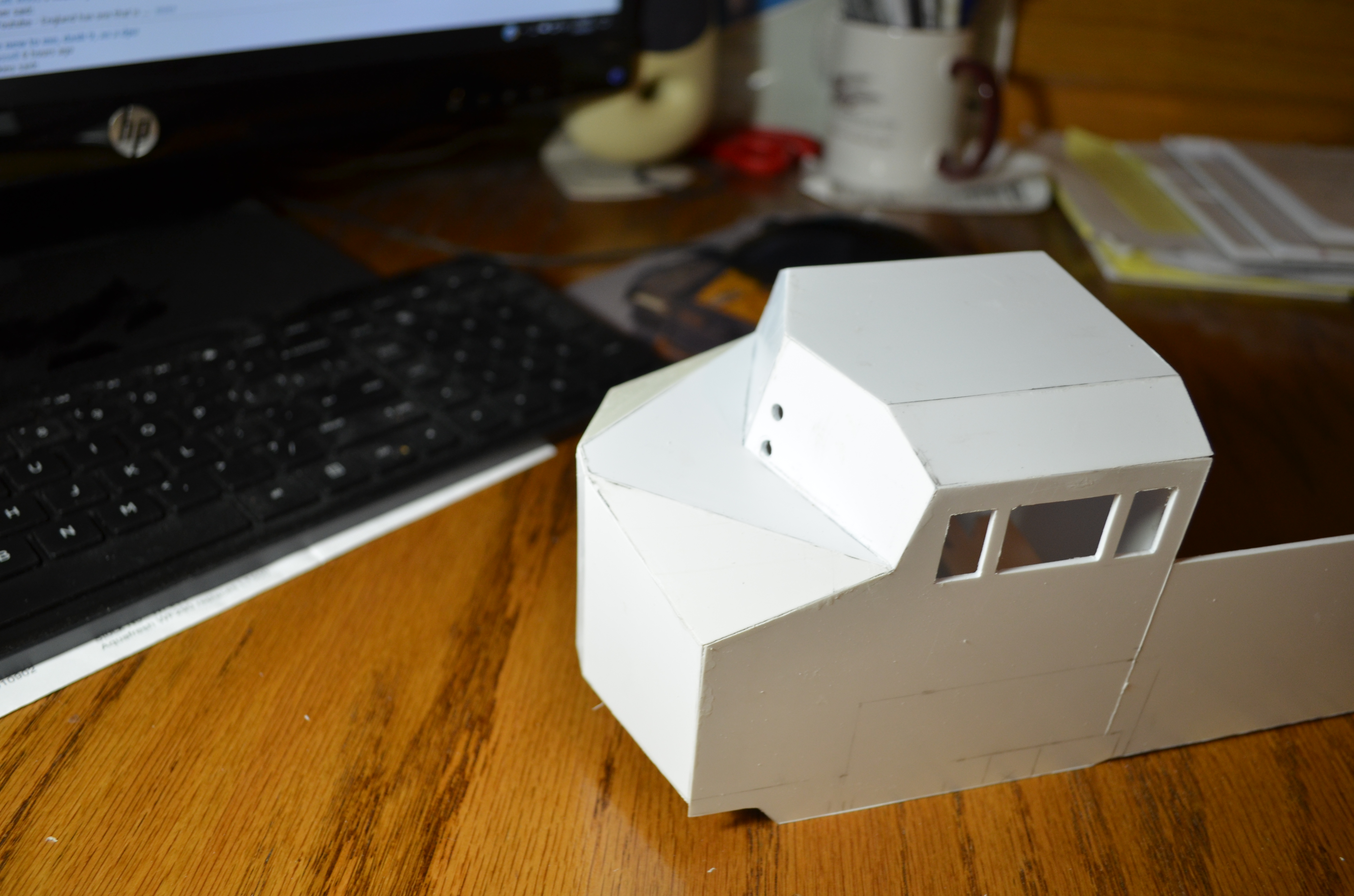

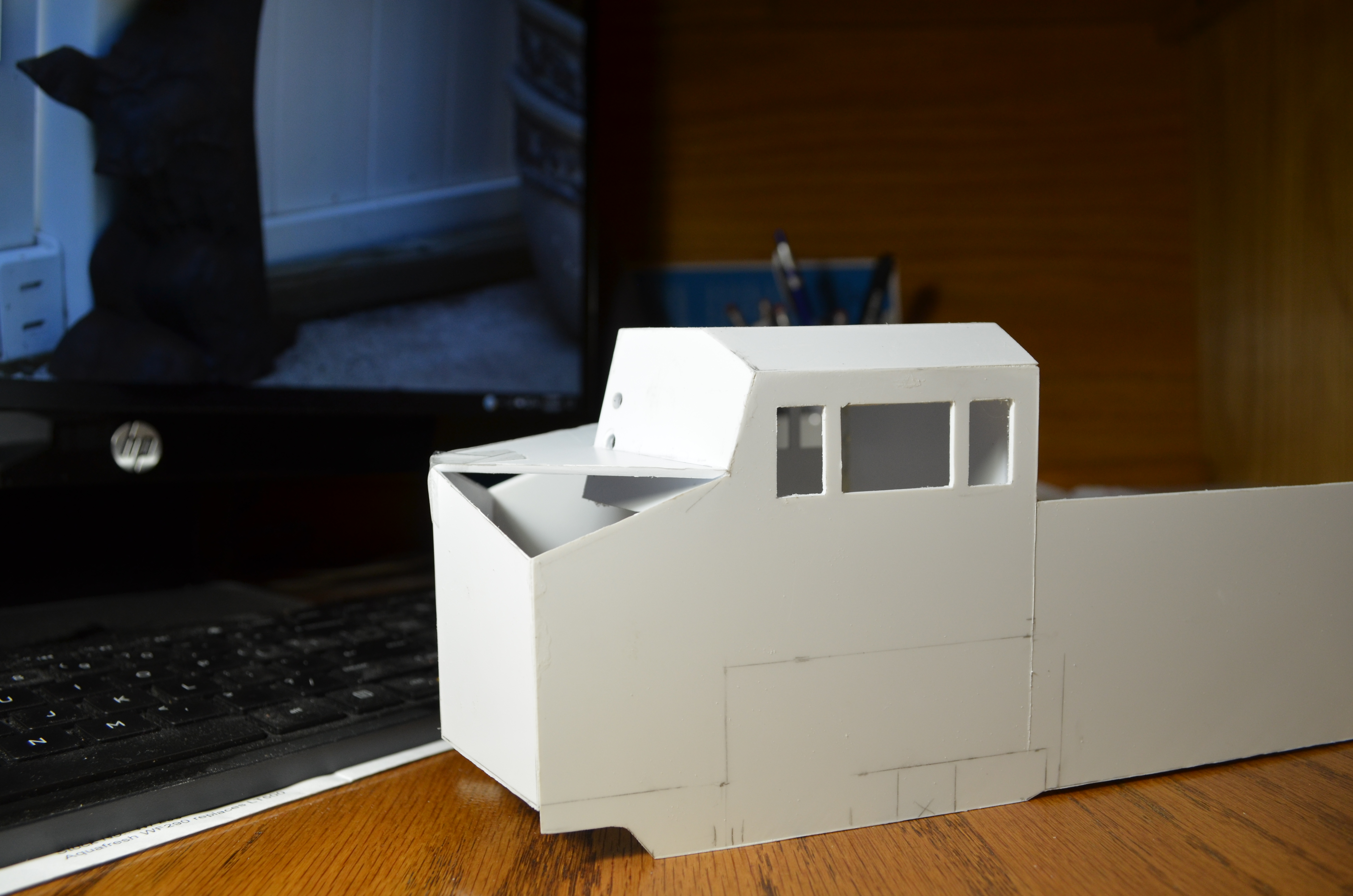

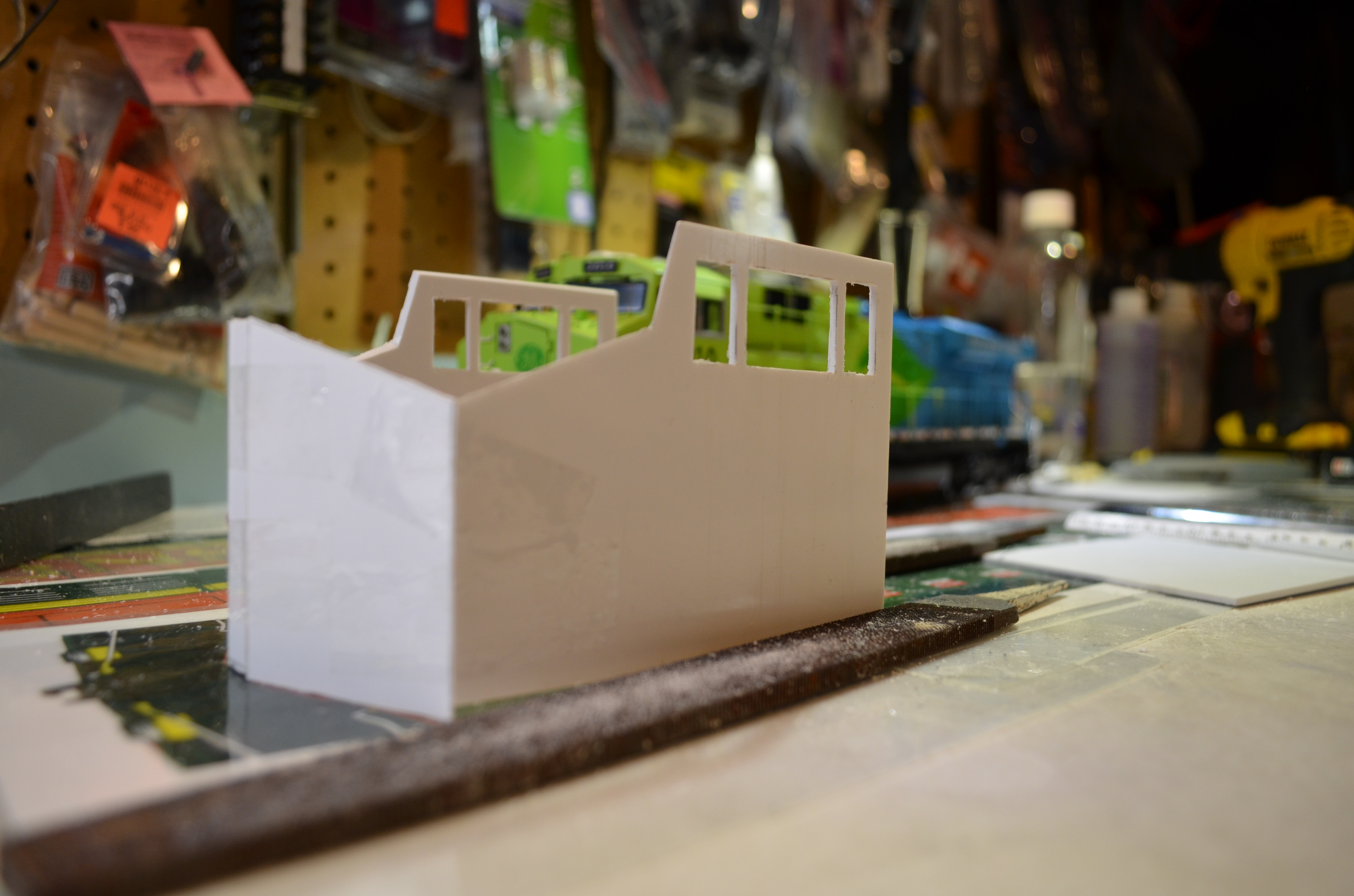

Trying to nail down all the angles on this modern GE cab is tuff. I will get it. It may take some extra time.
Sometimes I nail it on the first try.
or like this one, it takes several attempts and a lot of fine tuning. Urrggg.
or maybe I should have just made a mold of a MTH Dash 8 cab.....??? (and said close enough!)
