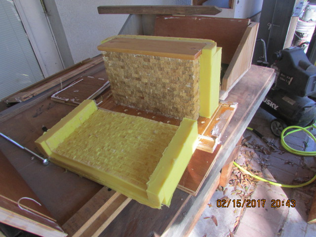

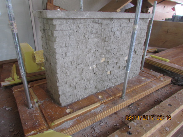

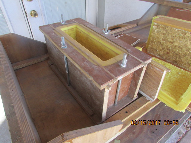

Here is what the column mold pattern and mold looks like pulling the pattern out of the mold. The second picture is the mold ready to pour. And a video of there I will put the layout and a short video of how I am going to construct it.  I think that I will color the concrete a light brown and then have to only spot some blocks with a few different colors to make it look like the pattern. Bob.

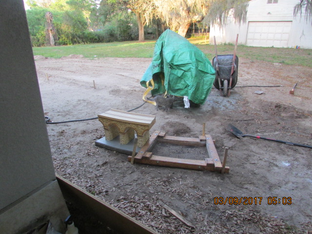

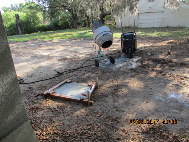

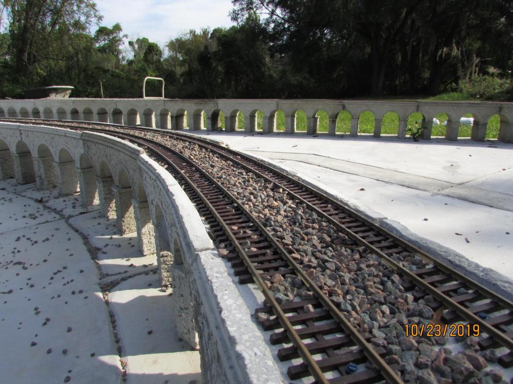

Finally took care of my car problems and officially starting the layout.  Here is the first pad, and I plan to pour one a day, so, two and a half months later, all of the pads should be poured, says me. Bob.
You have to start somewhere!  :rolleyes:
Actually I will be pouring more than just the pads.  I will be pouring columns, three are needed for each viaduct span, so with this task, it will keep me busy enough for a day. Bob.

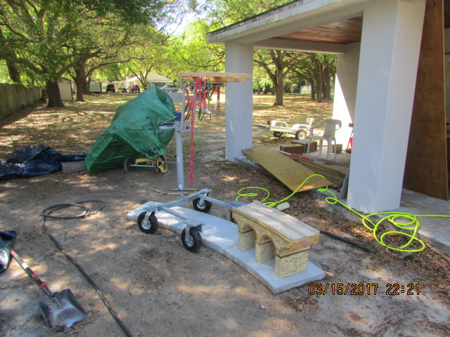

I am trying to figure out how to align the columns so that the top portion will be in the correct place.  I guess I could use the top pattern each time I install the columns since it will be the same as the concrete one, or I could make a plywood pattern to lie on the concrete pad.  The plywood pattern might be more accurate, because it will fit the pad perfectly, don't know yet, but here is what I have so far, ready to pour the next one tomorrow. My cat is always supervising, doesn't trust me. Bob.
I did make provisions for locking the top part of the viaduct.  I molded in a wedge type shape, so when two abutting sections are together I will pour the opening with concrete with two short pieces of rebar, hope that that is good enough.  The ground around here is stable, but there are roots, I worry about them.  Well if something moves anything, I will just have to deal with it, just like any other bridge, but I hope nothing moves.  What have you been doing? Done anything on the laser? Bob.

Here is the first working column out of the mold.  It came out usable, but too many  bubbles for me, so I will vibrate it longer next time. Bob.

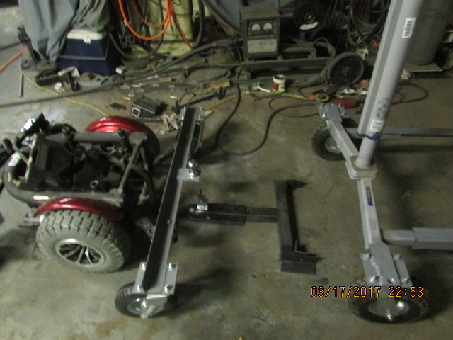

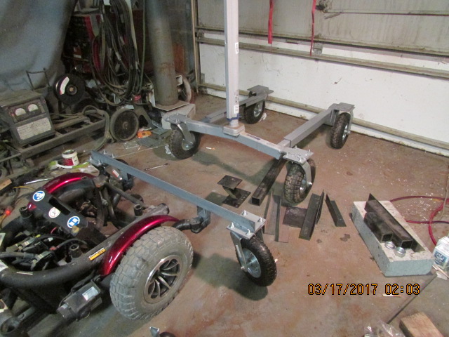

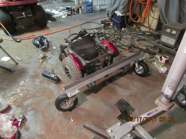

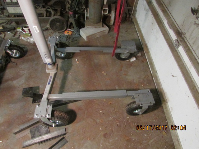

OK, I have been a little slow pouring concrete.  I have been working on the crane because I realized that moving the crane around is impossible in the dirt, so I took off the small casters and added l0 inch casters, so that the crane could be moved more easily.  I also bought an electric wheel chair that will also be modified with larger tires so that I can push around the crane with ease, says me.  Here is a picture. Bob.

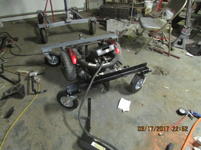

Wait till you see my wheelchair tractor.  You guys will think I am crazy.  I am doing this because I want to expend as little energy as I can.  I am getting old. 72, Bob.
That I have to see!  :rolleyes:

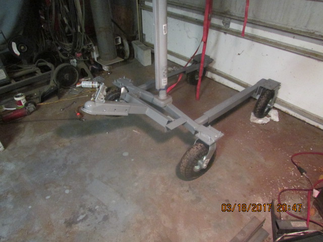

Sean, you will see it in very short time.  The large casters have been installed on the crane and one side of the large casters have been installed on the chair. I had to stretch out the crane legs because the center of gravity was wrong.  I am installing the trailer hitch and the other casters tomorrow, so it won't be long. Bob.
I got tired, so I did get to finishing the hitch, but I will tomorrow.  Everything is ready to weld.  All of the casters are on the tractor, or the all terrain vehicle.  Bob.
Finished and now I have to try to revive two sla 12 volt batteries, as they are quite expensive and if not, well probably have to dish out about 300.00. Bob.
