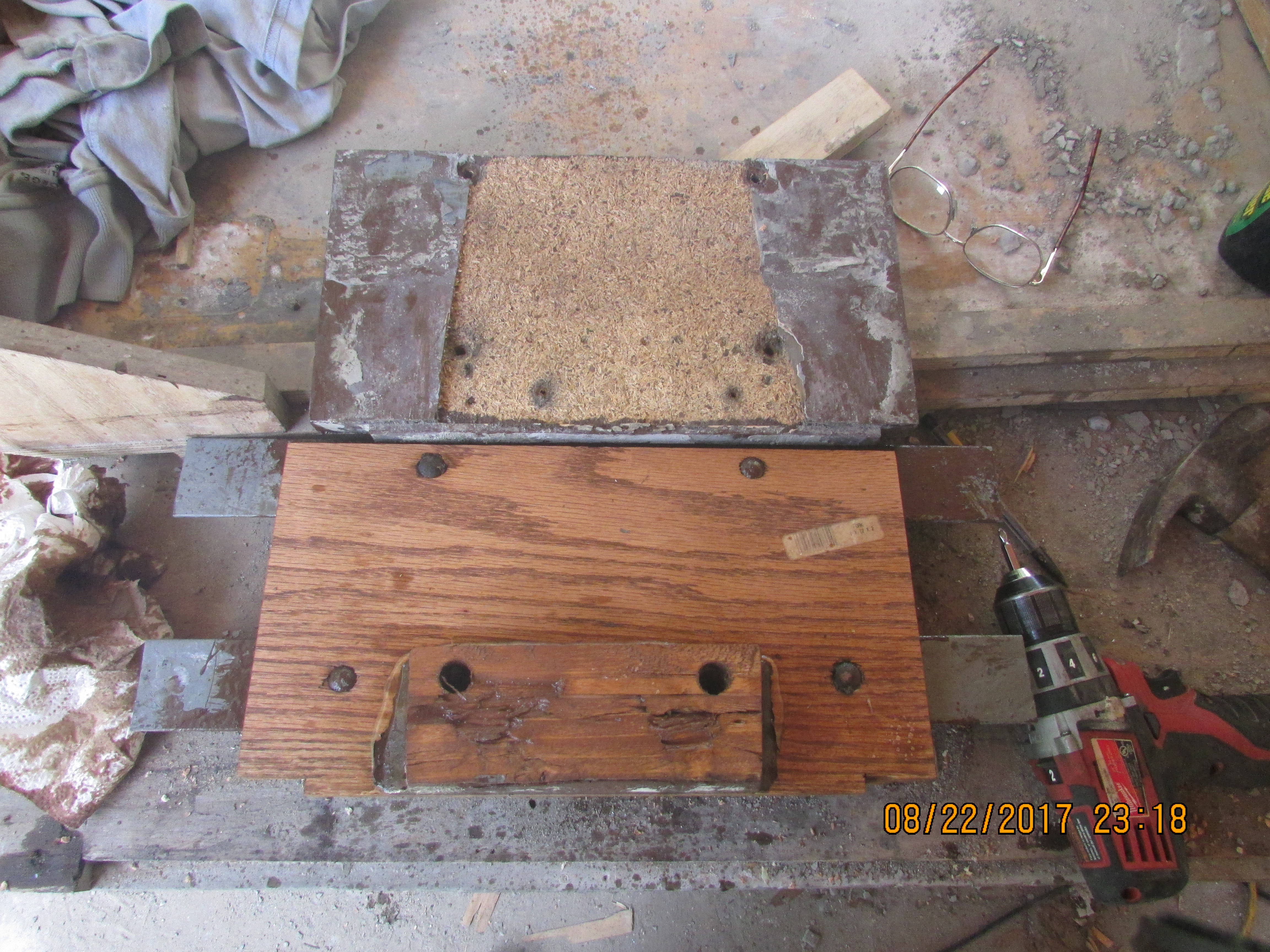

Well, here I go again.  Repairing part of the mold.  You would think, paying 50 bucks a sheet, they would use exterior glue.  When I experience a failure, I replace it with solid oak like this repair.  If anyone is thinking about making molds like these, I would use oak. Bob.

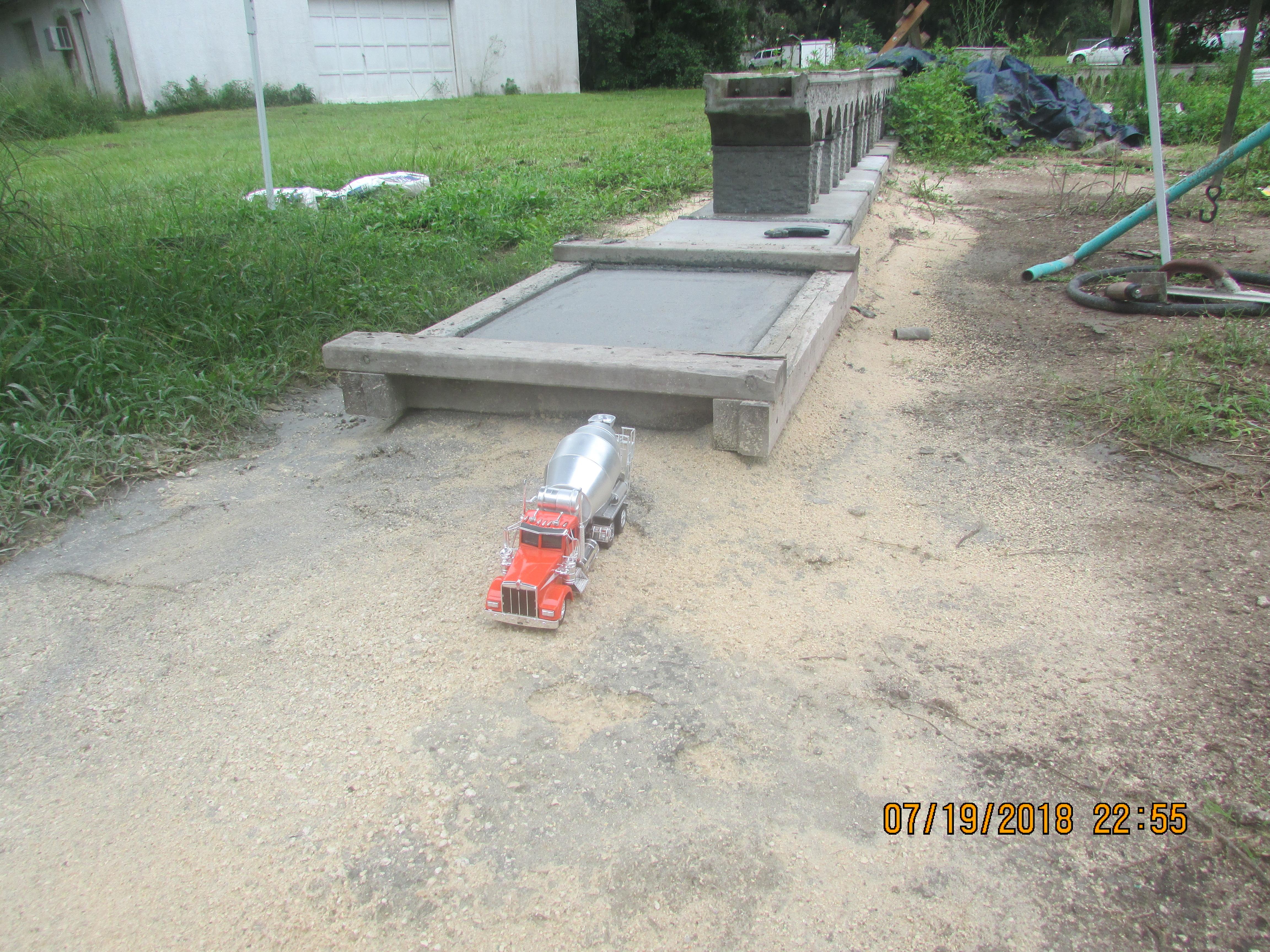

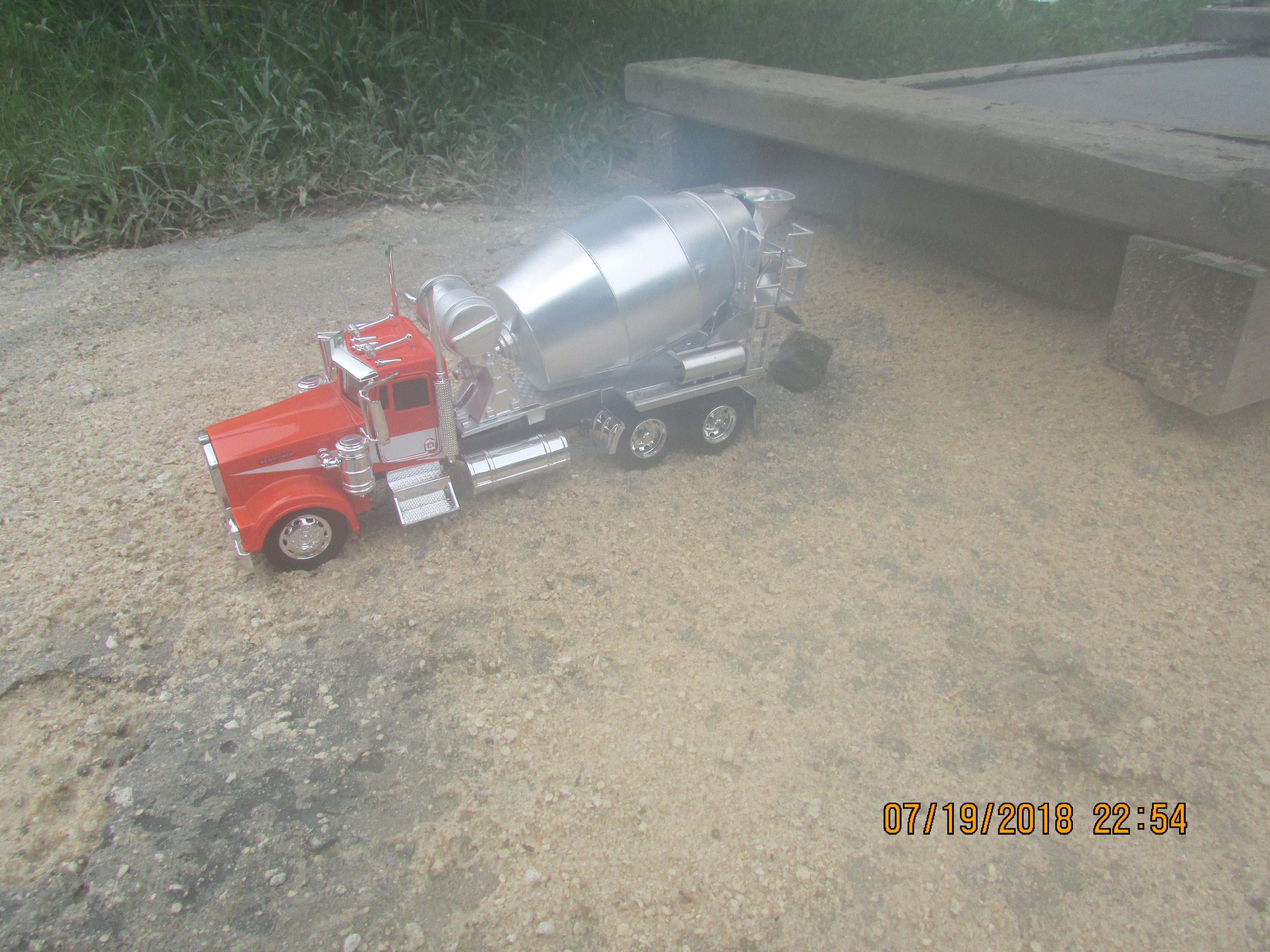

You are all probably wondering why it is taking so long to pour all of this concrete.  Well, this is part of the problem.  The concrete co. is sending me 1:32 scale concrete trucks.  Bob.
No, there is a really little man at the wheel.  He told me to order a bigger truck. Bob.

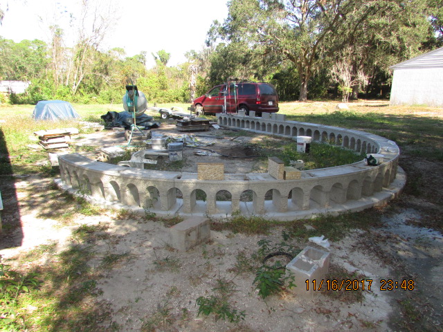

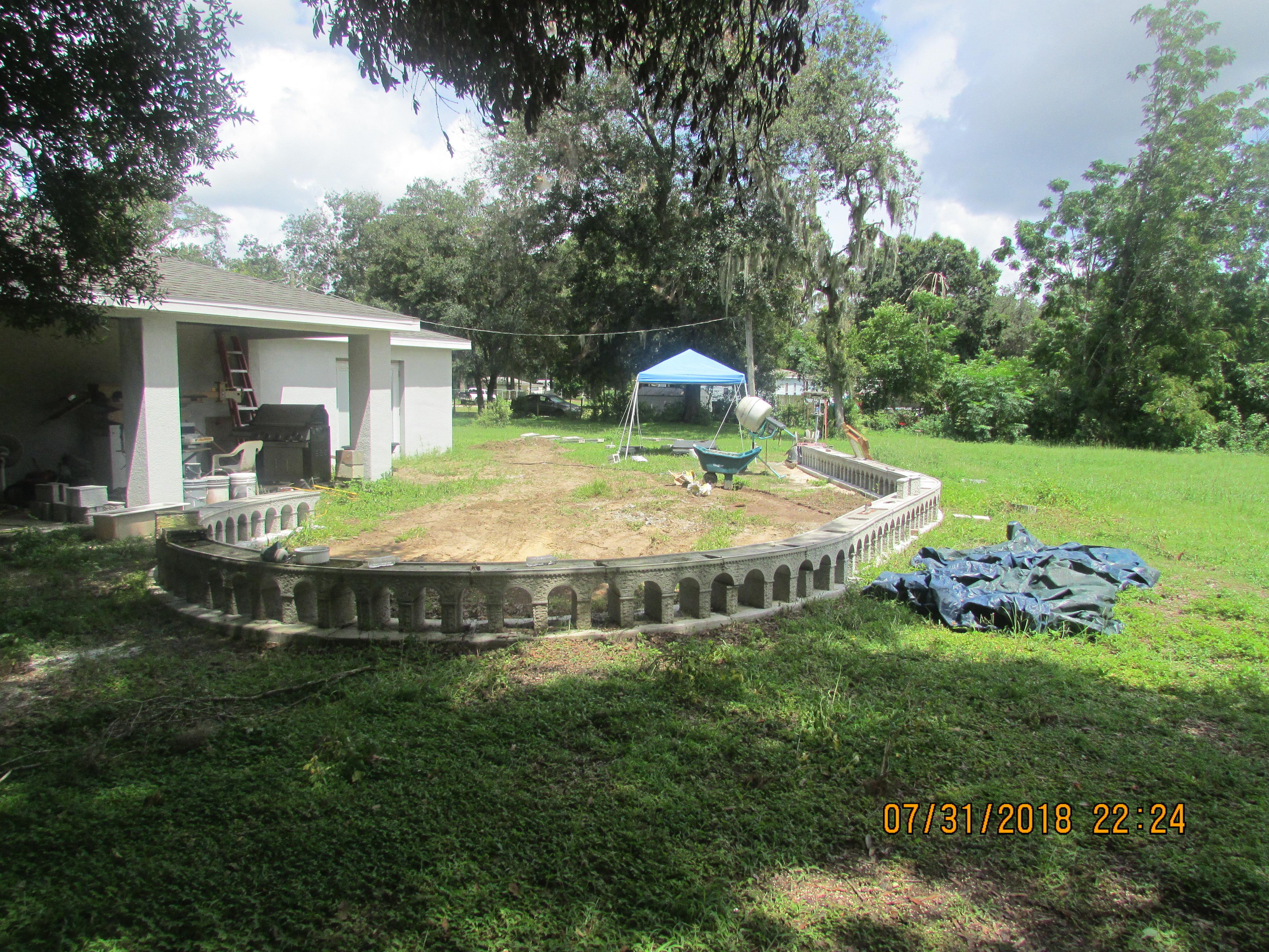

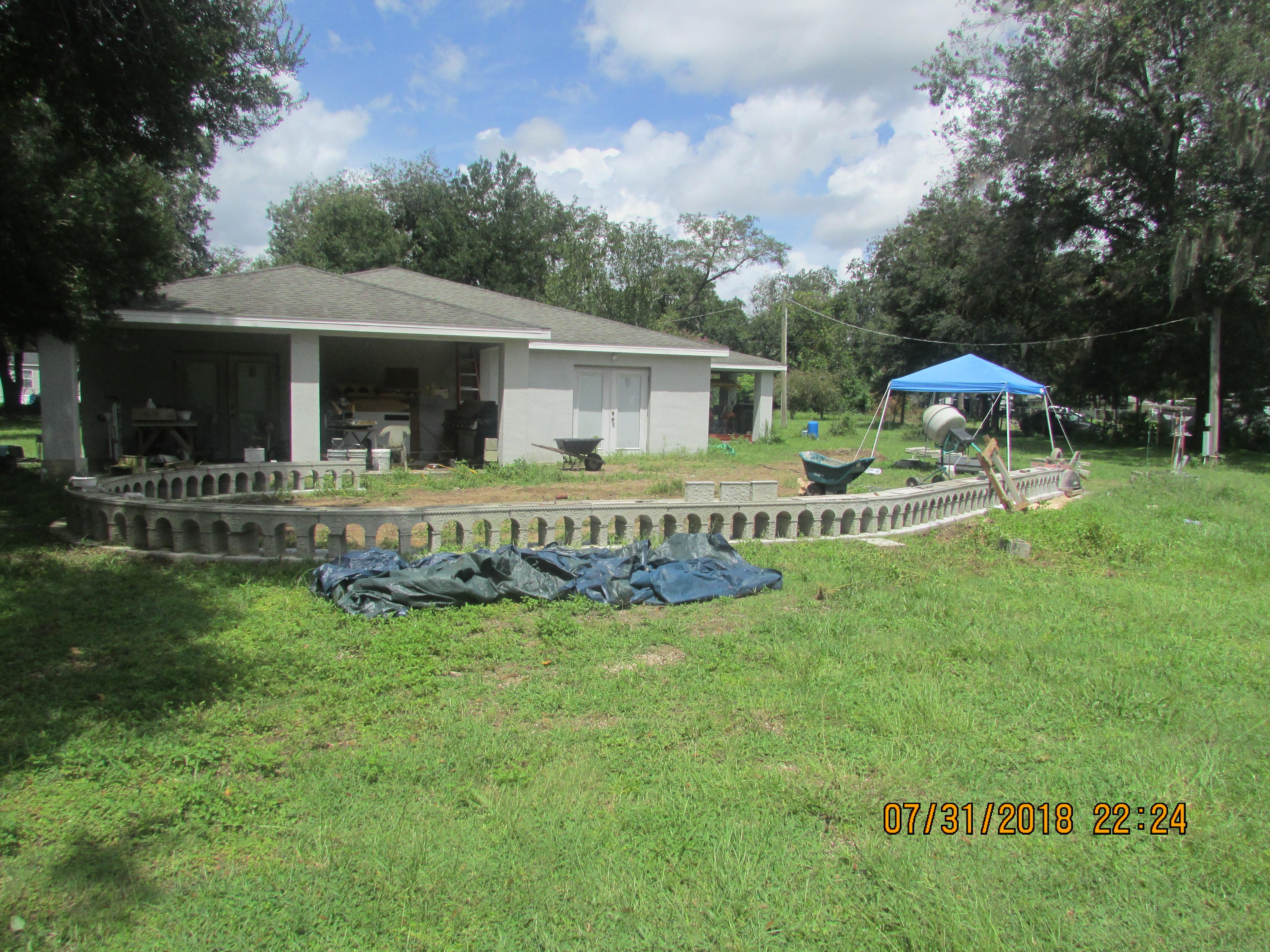

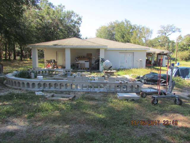

I am fine. I am working on the outside layout.  This is what I have done so far, coming along good. Bob.
Man them truck drivers sure have been racking up the OT !!! WOW !! :Clapping_Hands_Emoji_large(24x24):
