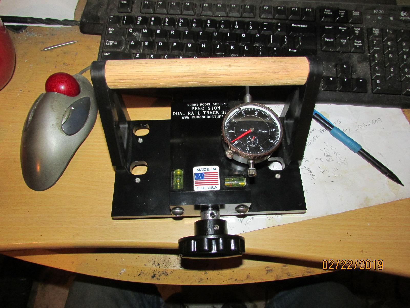

Have you thought of sectional ? You could get a rail bender that will bend both rails @ once.
https://www.trainli.com/rail-bender-p-36
Using there track as well.
If I do that what will be the downside? Bob.
  • Views 43.4k
Yes Sean, I have a dual rail bender, but the guy at Sunset Valley says that I would be taking a chance at disturbing the ties.  I am trying to get out of bending them at all and just laying the track. Bob.
  I have a Train-Li EasyBend-Duo Track bender and have used it on sectional track. The manual that came with it gives tips on how to easily use it with sectional track.  Looking at yours I'm sure it will also do that.  I think the booklet is on line, I'll check.  LiG
EDIT:  looked on line for the manual, appears not published but if you PM me I will scan and send it to you.

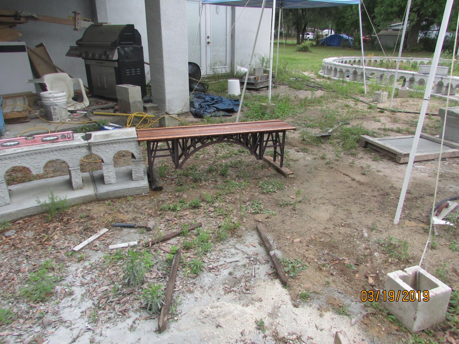

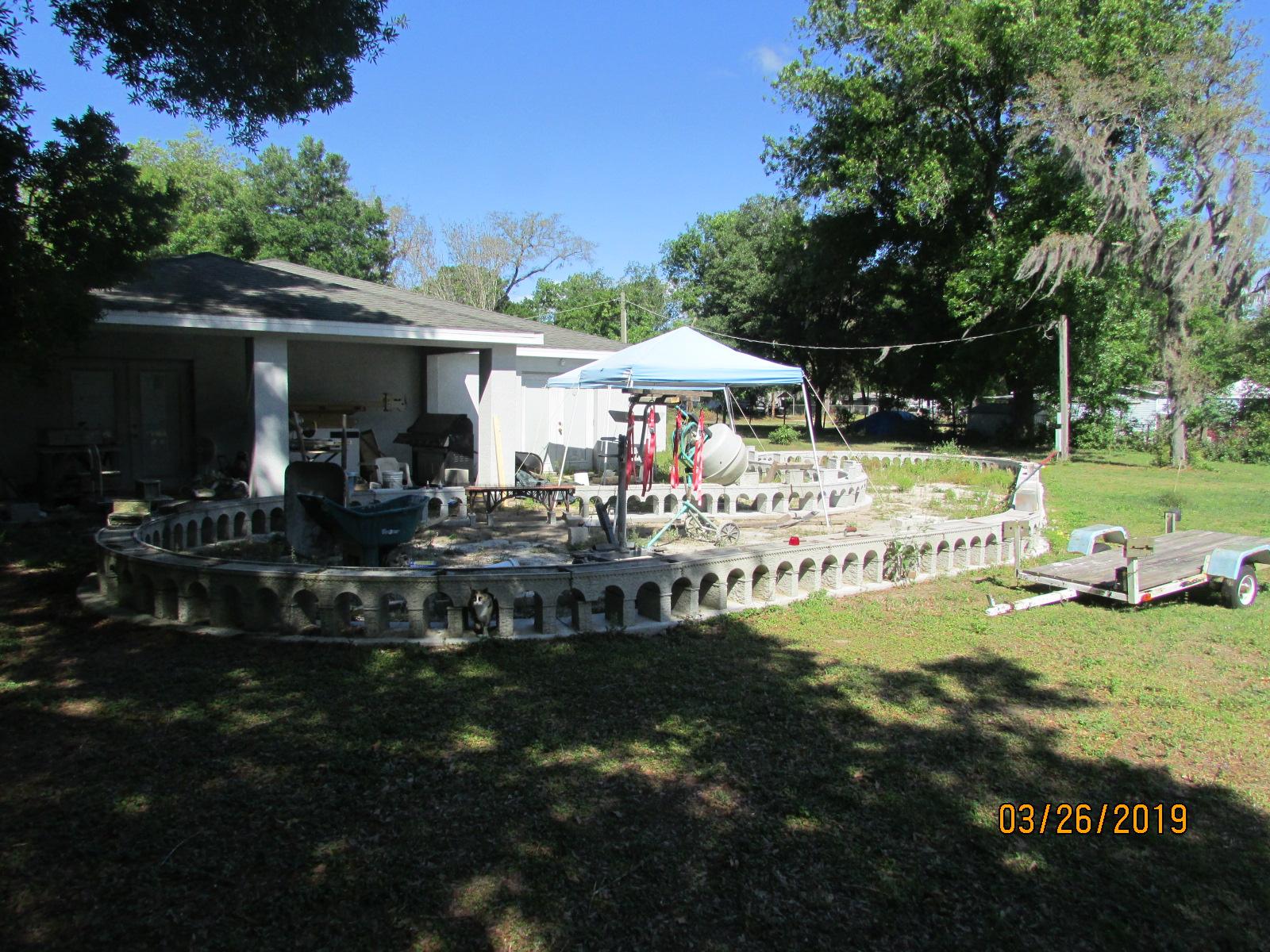

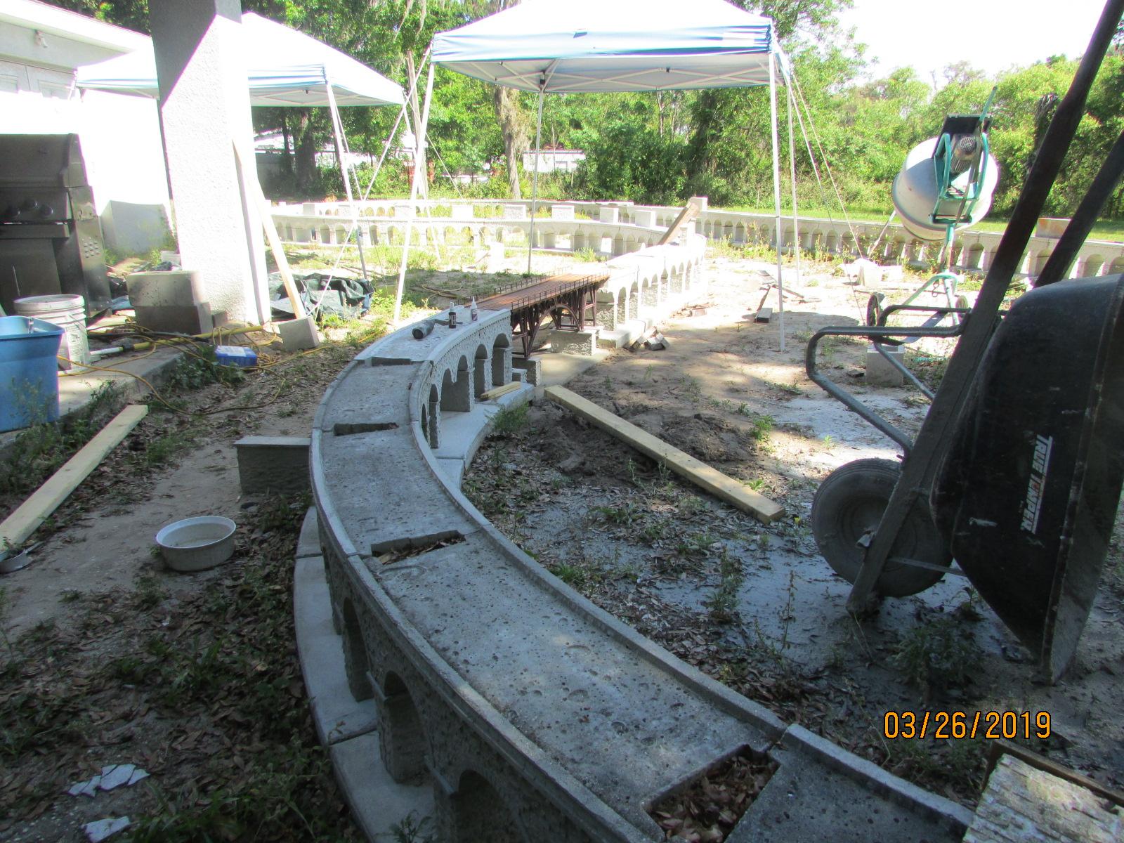

Thank you very much nick, but I don't think that I will need it.  Here is an update to my 18,000 lb. layout.  Just 2 1/2 straight sections and 1 curved section to pour, and I have purchased a Pola 56 inch bridge as a removable section, so I am almost finished and then laying the track. Bob.

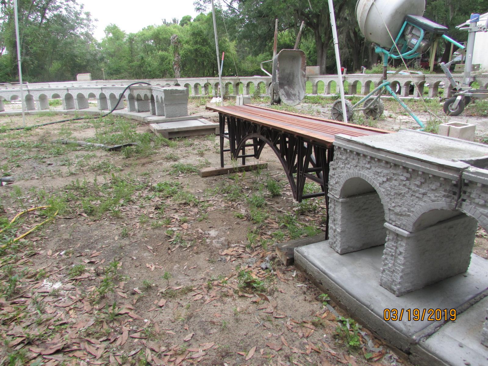

I bought a Pola bridge for the removable section for the layout.  To handle two tracks, I widened it 3 inches and will set it on my columns., it is 56 1/2 inches long.  Only 1 1/2 concrete sections to go, will be done in a couple of days. Bob.

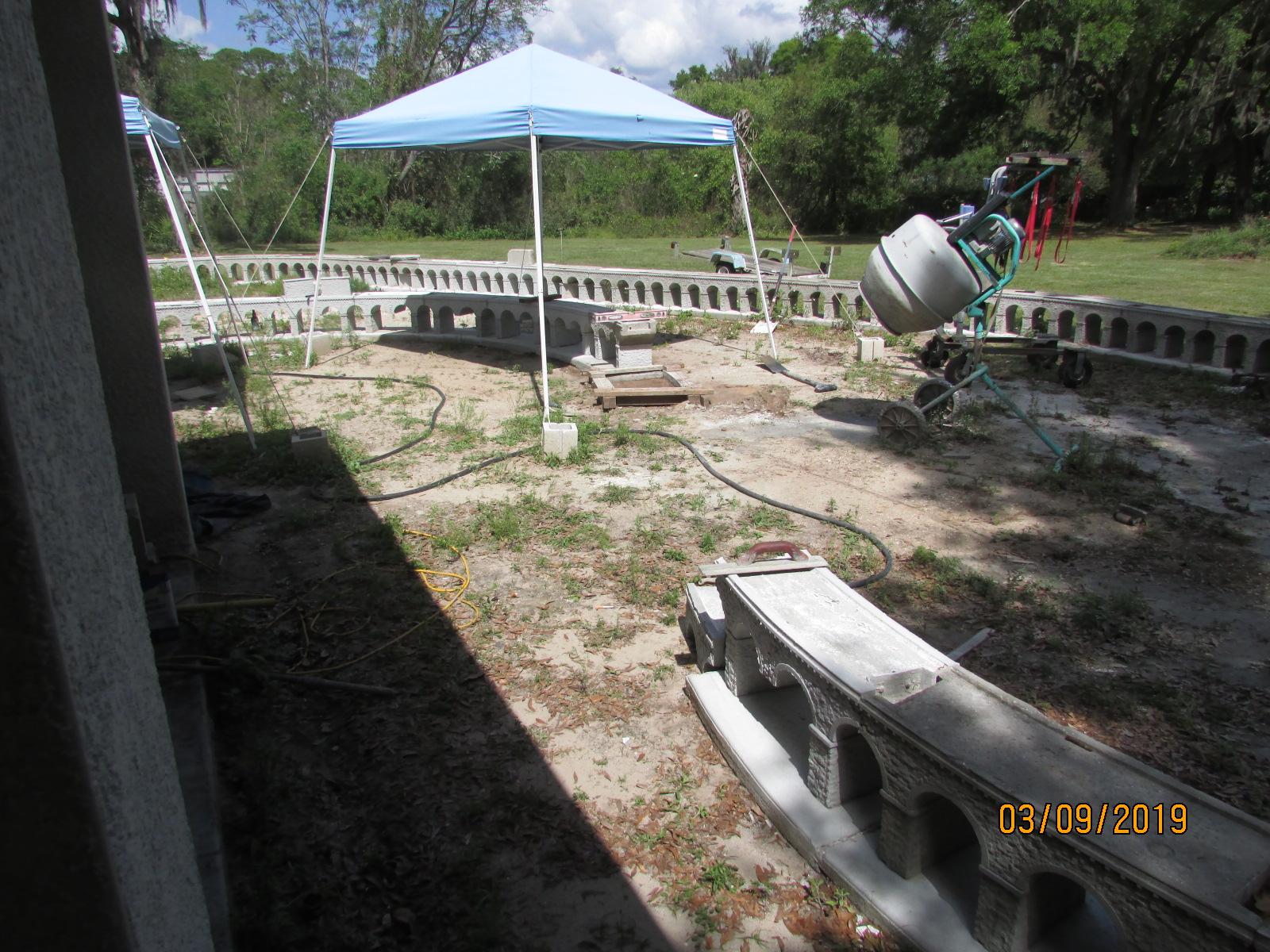

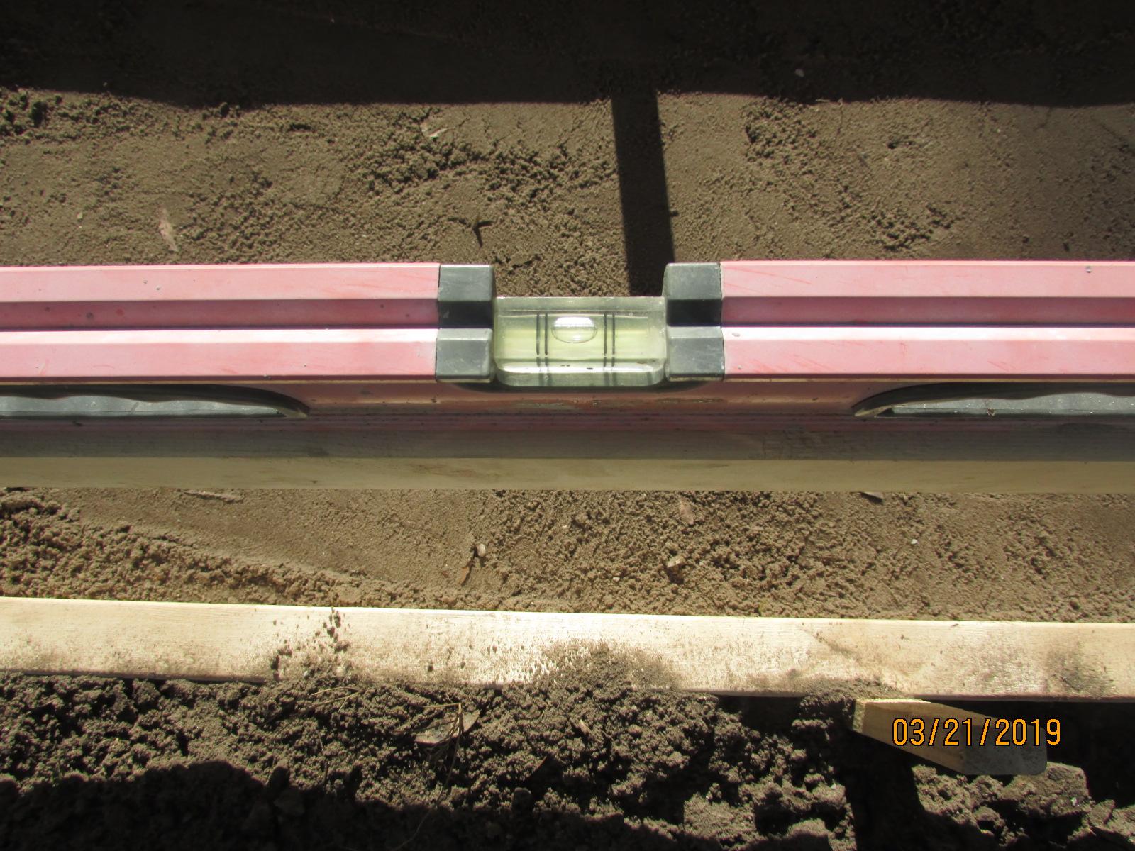

This is the final result of leveling each 30 inches in 150 ft.  I guess  averages are accurate.  Bob.

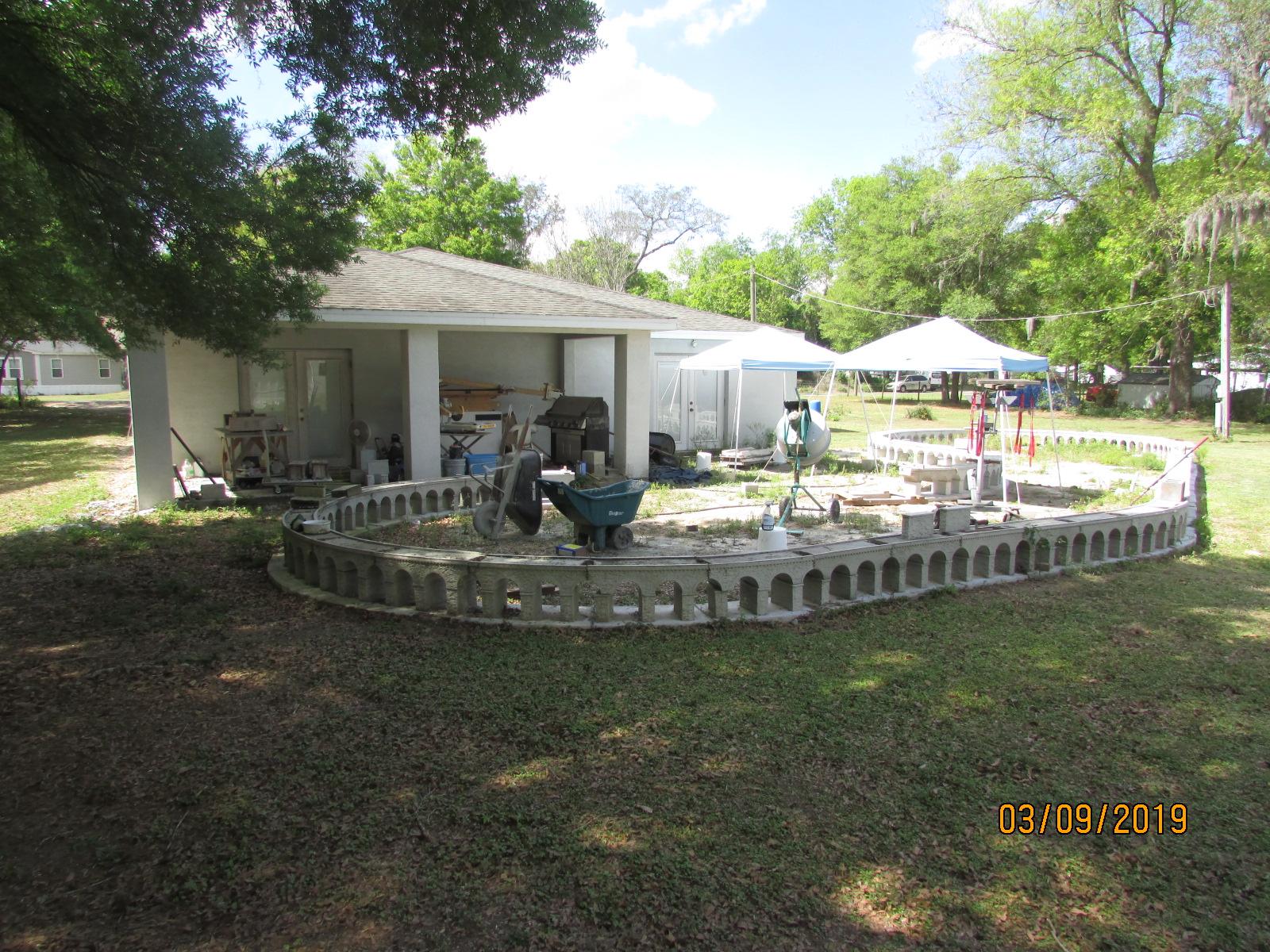

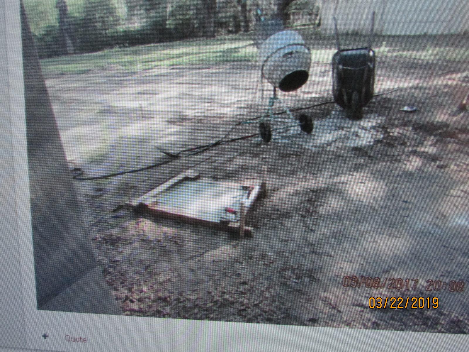

The Alpha and the Omega.  First picture, two years and days ago, and the finish. Now I am constructing a spur to go into the house and this consists of pouring partial parts of the viaduct and fitting them together to form the spur.  I am running only one track heading inside the house. Whew, I am tired.  Bob.

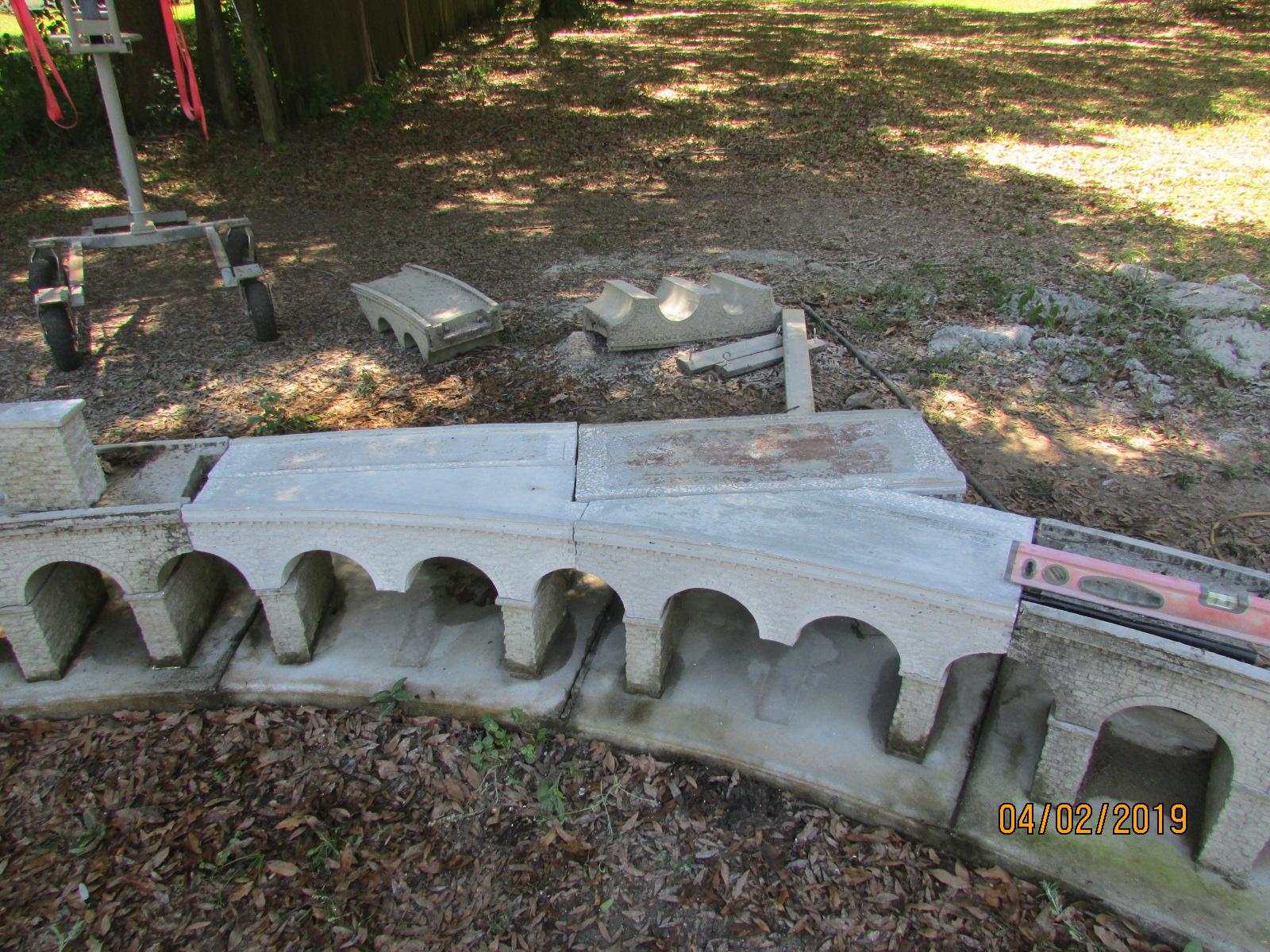

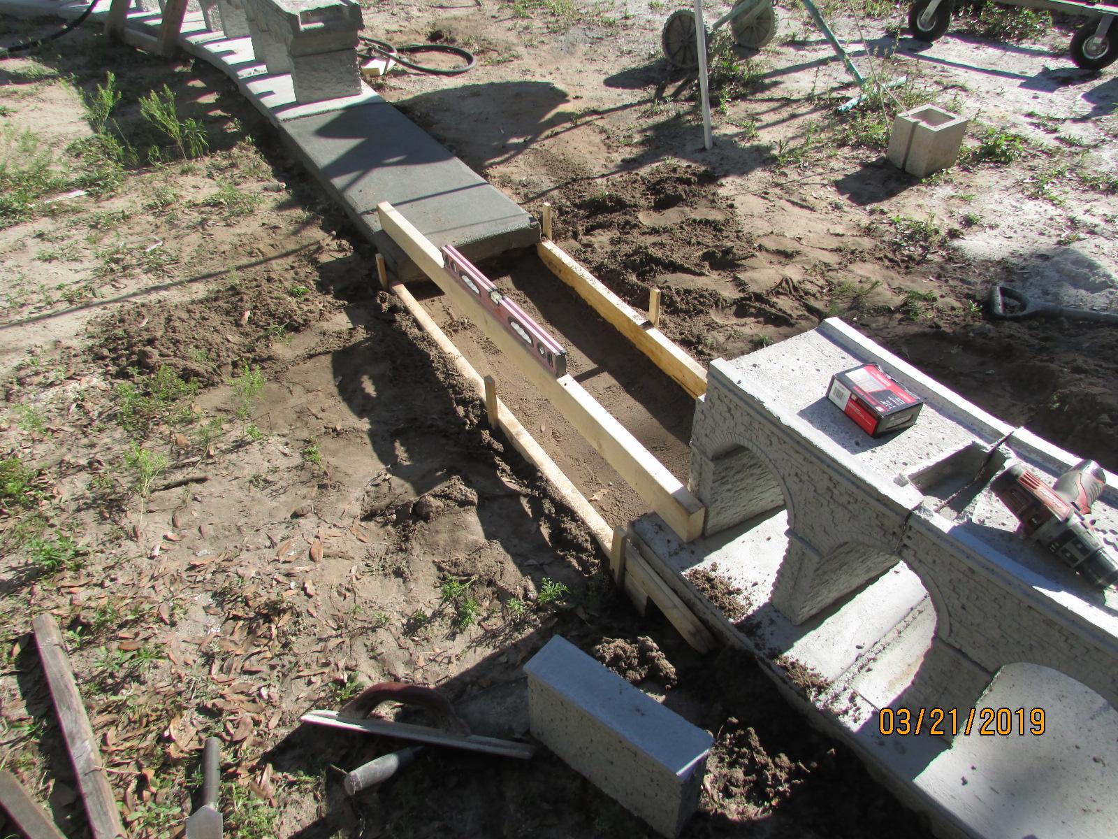

Here is the concrete portion of the spur to get into the house.   Boy, needs quite a bit of grinding.  The molds, both the wood and the urethane changed over two years, and that is why I need to do some grinding.  The urethane does shrink and the would falls apart from the weather.  Oh well, I can still make it fit, and it will get the job done, Bob.
Chuck one of these in a 4" grinder and put on the mask and make some dust ! image.png.1d16a1d388028abec400019d9acb2408.png

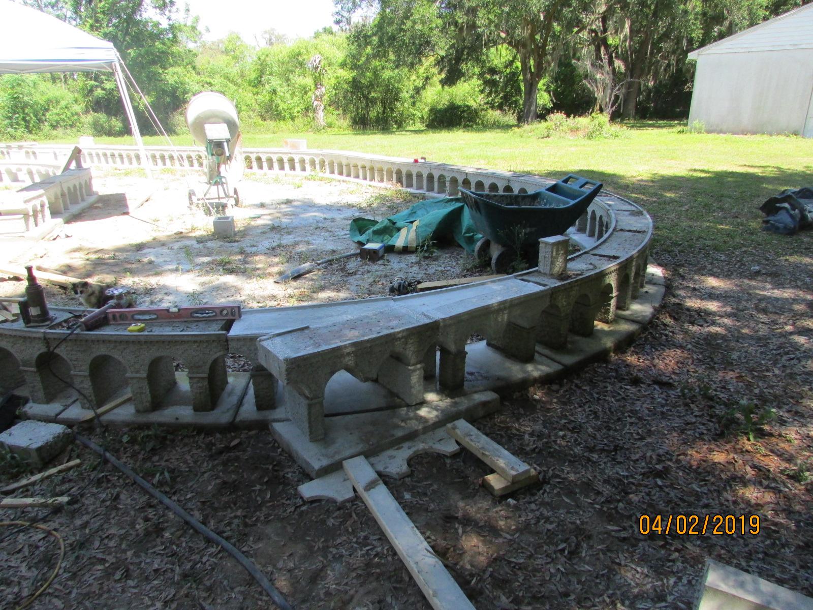

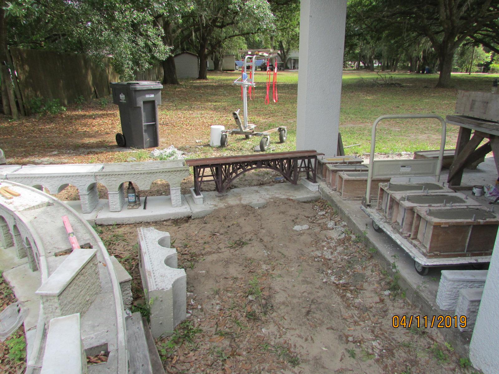

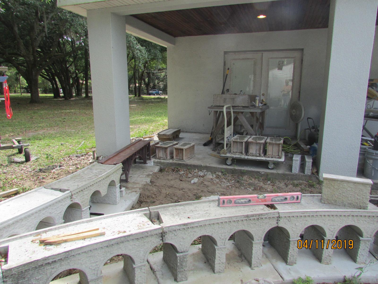

This time I mean it, almost done, just one more set of arches to pour and that gets me into the house.  Another removable bridge for access to the side of my house.  Bob.
Hell .... You must be in great shape to sling those concrete pieces .... :Smirk_Face_Emoji_large(24x24):
Thanks for all of the encouragement and I am happy that it is coming to a close, and yes they are heavy.  The largest piece is 150 lbs. and sometimes I can't get my crane in place and have to place it by hand and I have to be very careful not to strain my back, and have several times, but it is over.  Now another job and that is to lay track and pay for it, oh well, it will be done someday, Bob.
