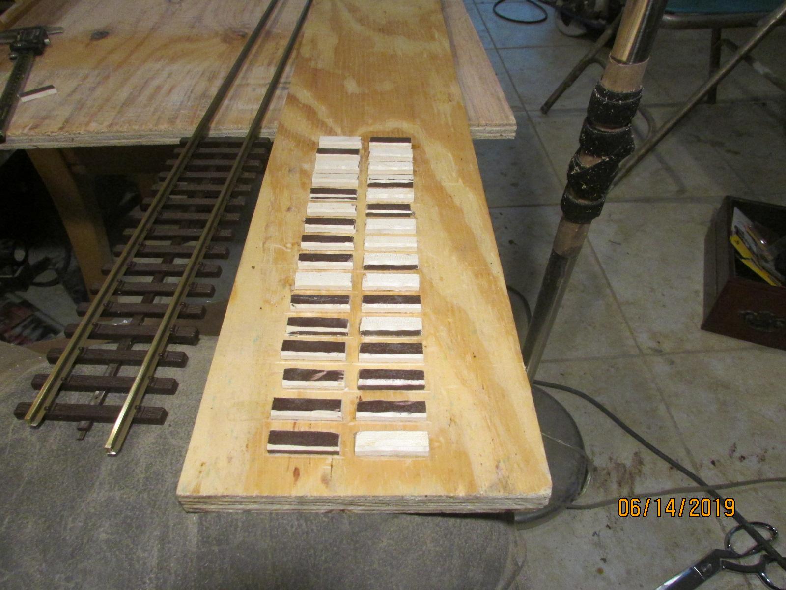

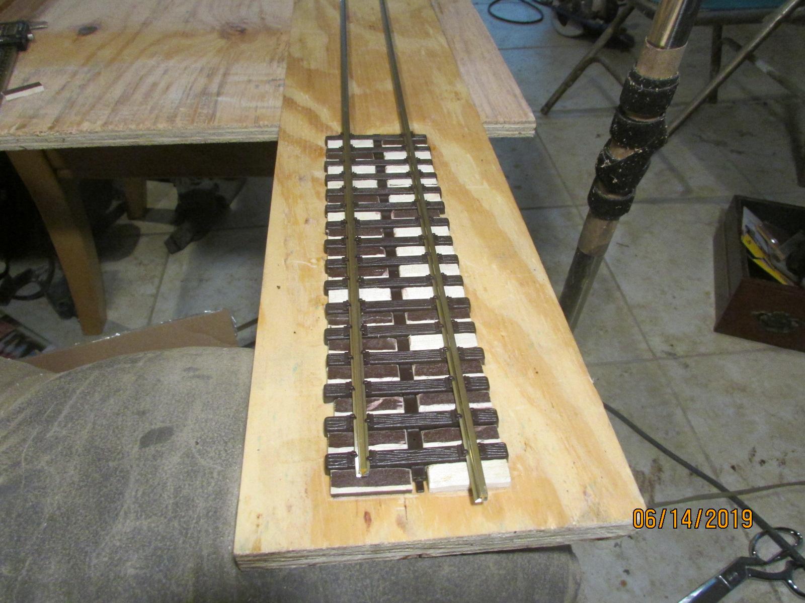

Jerry, I know that you use Sunset Valley track, so have you came up with a jig to make assy. faster?  The way that I am doing it is too slow, as I have many sections to put together. Bob.

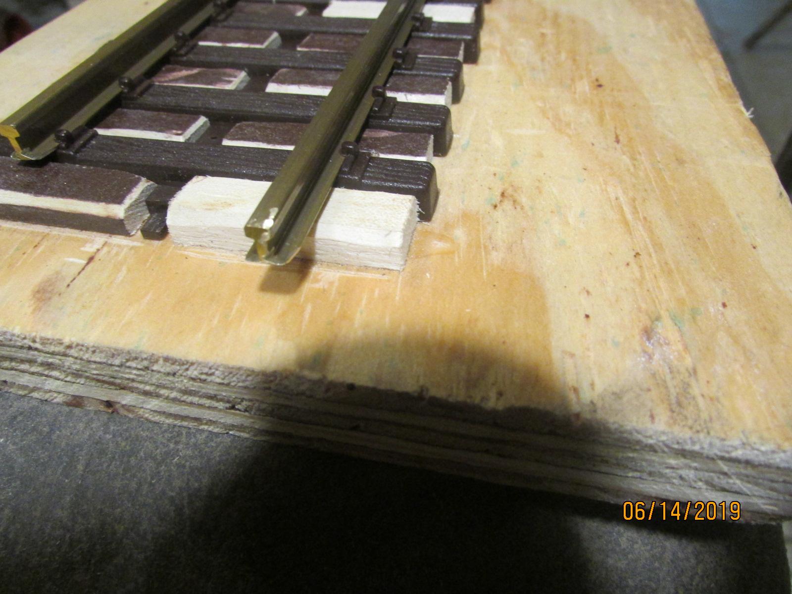

OK, here is a little jig that I just made and it is a little faster and much easier to thread the rails through the ties.  One main move is to grind the ends of the rails to a wedge so that the rails slide through easier.  Works good, much faster than the way that I was doing it. Bob.

That is a very good idea. I am getting ready to do a couple hundred feet of track.
I will give it a try.
Tom
I thought about stretching this jig out to six feet, but I would have to stand to thread them, so this way I can sit and watch TV as I am assembling them.  They do go through the ties much faster and easier. After this 200 ft., I have another 300 ft. to go.  Maybe I will make a 6 ft. jig, we'll see how it goes, Thanks, Bob.

Grsman, You and I both talked me into making a 6 ft. jig.  I thought about what I said, having to assemble 150 more ft. this time and for the next order another 300 feet, made me realize that the 6 ft. jig is a good idea, will post some pics. on the making of it, Bob.
I spray the ties with Armor All also. I use the filing technique also.  Slides in a little betterywith spraying it some.
