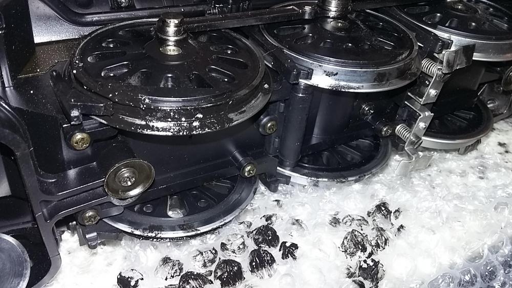

I'm wondering if there's an interaction with the bubble wrap?
I didn't have many melted tires. I just opened an engine I had packed for shipment and now the tires are melted. They appeared fine before this. They are melted mostly on the bottom where it contacted the bubble wrap.
I think I'll start putting paper towels under the wheels just as a precaution.
Not related to bubble wrap. The tires didnt go from 100% ok to melted in days it was just something not noticed is all. The rubber compound on that batch of tires was all an issue. There was one point a few years ago that tires I ordered from parts department started to degrade like this in the bag and had to warranty... and I clearly remember the rubber on those tires never seemed right when I got them. It is a really odd thing for sure!
Yep, you're right.
I just scraped off all the tires. The rest of each was very soft. The bottoms were liquid like. Maybe gravity did something to them like squish them?
What a mess. A dozen ear swabs, paper towels, alcohol, and a screwdriver scraping off the mass.
Hmmm, now the front engine engineer's side eccentric crank is stuck. I took off the rear engine's crank without issue so something else is happening.
took some brute force but it came off. 2 were a bugger. 2 came off without issue. Good tip about the alcohol.
