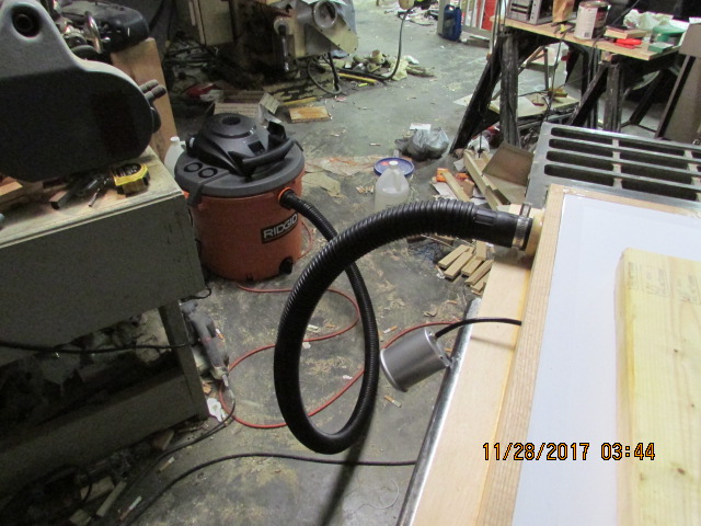

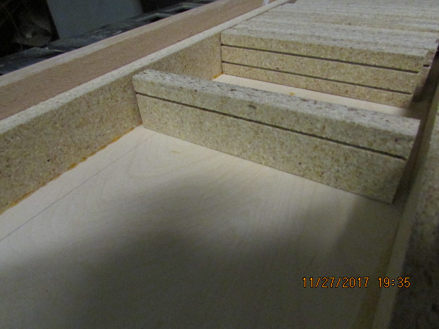

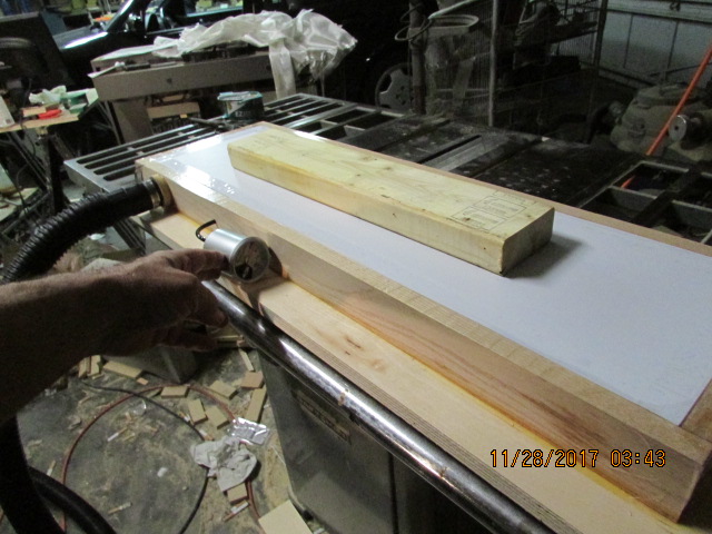

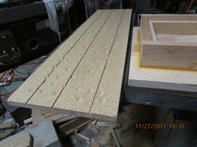

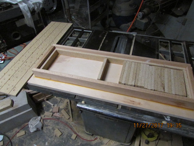

I finished the vacuum hold down fixure and it looks like it is going to work.  I had to do some homework on how these things are made and most of them that are on YouTube are for industrial use and the people were using very high hp. vacs. or 7cfm vac. pumps like they use for refrigeration, but I don't need all that vacuum.  All that I need is to hold the plastic down flat on the top of the fixture while cutting.  I am using for the inside of the fixture, particle board and the top also.  If you shave the top 1/16th inch. from the top, of  the skin, the air flows right through particle board.  I used that, because if I had designed it with holes or channels, the thin .040 plastic might have sunk into the grooves or holes, so this is a flat surface, so no problem there.  The bottom of the top, I have cut holes and channels for the air to flow through to the top and also channeled the bulkheads, as you can see in the pictures to allow air to flow.  Without skinning or providing channels in the particle board, air would not flow.  I put tape around the top of the all sides to seal the plastic next to the rails.  When turning the vac. on, the  gauge indicates that I have 2 lbs. of vacuum per square inch, or 4 inches of Hg. and that translates into 520 lbs.  of total weight holding the sheet of plastic down and that is enough to keep it flat. While I am cutting, I can monitor the vacuum from the vacuum gauge to make sure that I haven't lost vacuum, because when the cutter picks up, it has a tendancy to stick to the plastic and tries to lift, but can't with the vacuum holding it down.  As an additional precaution to keep the plastic from moving while cutting, the plastic fits down tight into the fixture, no slippage.  I glued a 2 x 4 on top of the plastic just to demonstrate the strength of the hold down pressure and was able to pick up the whole fixture with no movement of the plastic, so it is a success. Here are some pics. Bob.

You make a good point about the noise.  Here I spend more time and money to put together a cnc router built with servos instead of steppers so that it would be quiet, and then I have to turn on the noisy shop vac.  Oh well, I guess that I could wear ear muffs. Bob.
Lol...I never thought about that! I just seen that shop vac and wondered if it was the same noisy not really good for much model that I have.
That really is amazing how you stripped the particle board so air can move thru it!
Like Spock would say..."Fascinating"
Try the Sears 5 gallon shop vacs. The ones with the round cartridge filter, no bags. I own three of them. I would not buy anything else.
One yanked a sheet off of a table in a home I was cleaning after doing work inside. The dishes on the table stayed in place. It took several minutes to get the sheet out of the vac. That sold me on only buying them from then on. They have suction better than any other I had tried for a reasonable price.
