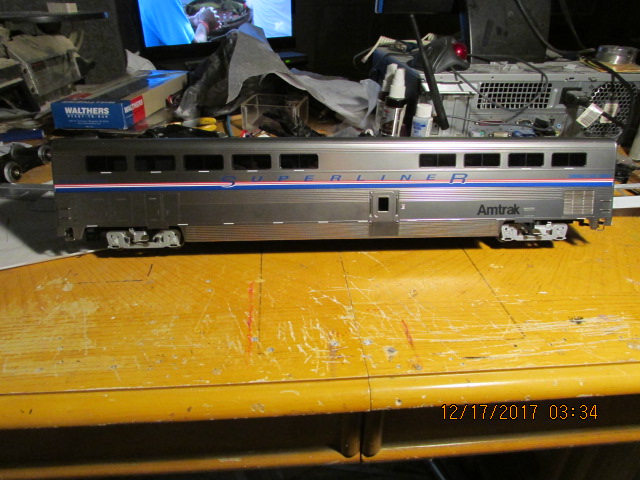

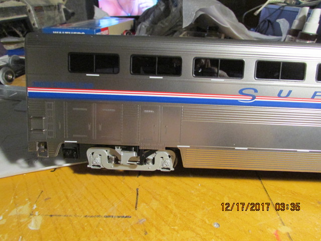

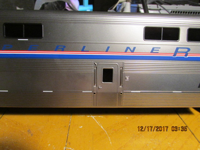

Great Trains Superliner stretch to 85'

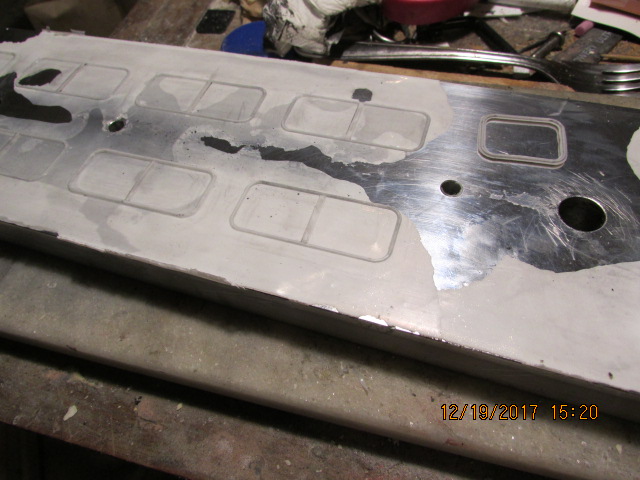

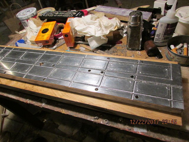

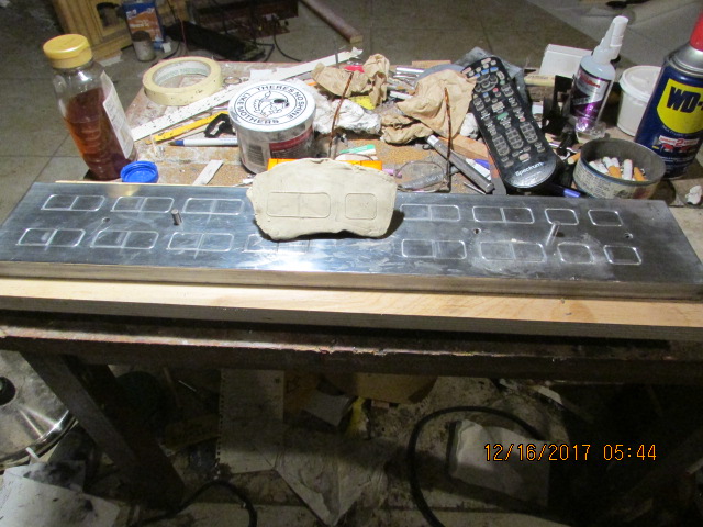

Here is the first half of the window frame mold, hope I can keep everything in alignment. Bob.

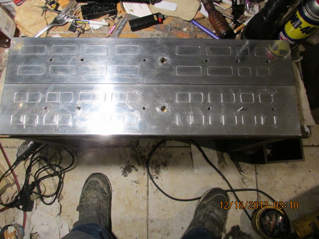

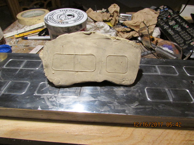

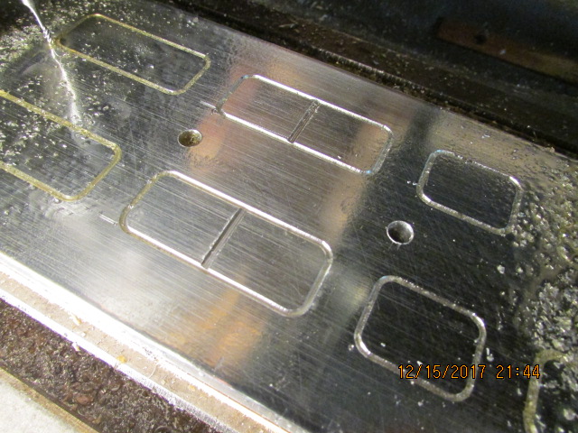

Here is one half of the mold for the window frames and I clayed up the shape to see what it will look like, much better than just flat plastic, if I can get the other side of the mold to match up with this one.  I have an old mill and the tolerances are not so good, but maybe it will be ok. Bob.

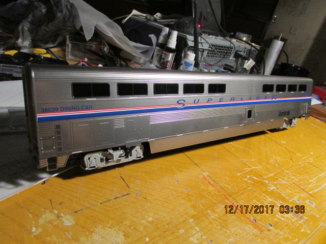

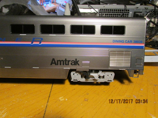

I bought this brass 0 gauge diner for modeling mine.  The detail is fantastic. Bob.
That's so pretty!
Just need to find the lounge car to save you some work!
Oh I thought of another car, Transition Sleeper!
Thanks, I do have an HO model  of the lounge car, but would like to have an O gauge to copy, that would be nice, but probably too expensive. This brass O gauge care that I bought was only 225., I thought that it was cheap for brass.  It is an Overland models model.  Bob.

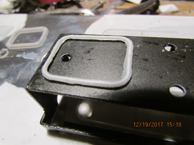

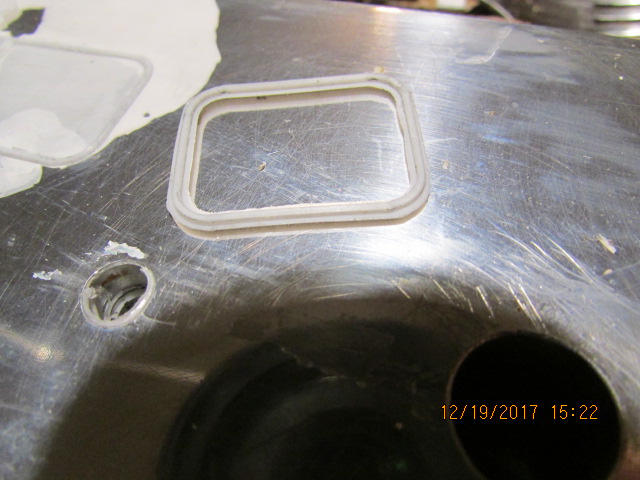

The window frame molds are done and I have no idea yet if this will work given that these were made on an old worn out mill.  All  of the numbers were correct, but with an old mill, even if the numbers are correct, the tolerances of the mill might be different than the numbers, so we shall see.  I plan to make some parts tomorrow, Bob.
Today I made a mount for the molds to hold it while I tighten the bolts and pour the plastic which I just poured, so we shall see how my mold making abilities are in the morning when I remove the window frames, so says me. Bob.

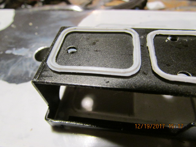

The alignment of the two halves of the mold is perfect and will make some good parts with a minor adjustment, adding more bolts to squeeze a little more.  You can see in the pictures that there is some more flashing to remove and will be easier when the plastic gets a little harder.  I pulled the molds apart a little early, like I always do, to see how the parts came out, they came out very good.  When I add some more bolts and machine some more channels in the molds, it will relieve some pressure on the excess plastic when squeezing together and make the flashing thinner and easier to remove.  All in all, I am very happy with the mold.  There is not much room for error for the size of the glass for the frames and for the openings in the sides for this type of installation, but I think it will look good as the windows will be flush with the sides and look more prototypical.  I used urethane for the frames, but I am also going to try epoxy to see if it will work out better and also I will be adding some pigment to the mixture to simulate rubber. Bob.

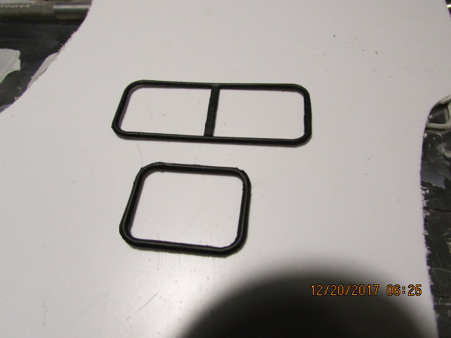

Here they are painted flat black.  These things are delicate and very hard to work with, but after reworking the mold a little bit, they should be a little bit better to handle. Bob.
Could you make them with black plastic ?
Yes, but I have not found black  urethane so I add black pigment to the white urethane,  which I will be trying, but I am afraid that it will not be black enough, because you can only add 1% black pigment to the mixture. In the end, just painting them with flat black will work, but  I am also going to try black pigment in epoxy mix as I have done with my E8 number boards and it comes out black enough.  I am also experimenting with some JB weld type stuff, but don't know how that will turn out.  The problem is getting them out of the mold without breaking them as they are fragile, so I am looking for some stronger stuff.  I am also reworking the mold to make it easier for the parts to be removed, that should work out OK. Bob.

The first batch of frames had flashing, in some spots that were too thick.  One reason for that is that I didn't have enough bolts spread about the mold.  The other reason was that the flashing was too thick in some spots is that the excess plastic had no where to go, so I added some bolts and channels for the escaping plastic, so now, I believe that I will get more uniform parts without thick flashing, so says me.  This mold is sort of a poor man's plastic injection mold, just slower. Now for the polishing.   My next batch will tell the story, Bob.
