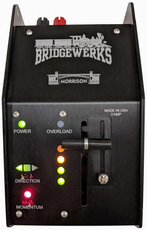

I see Bridgewerks has a new power supply listed on their website named "Morrison".
I do like the black case and lights on this thing :Slightly_Smiling_Face_Emoji(24x24):

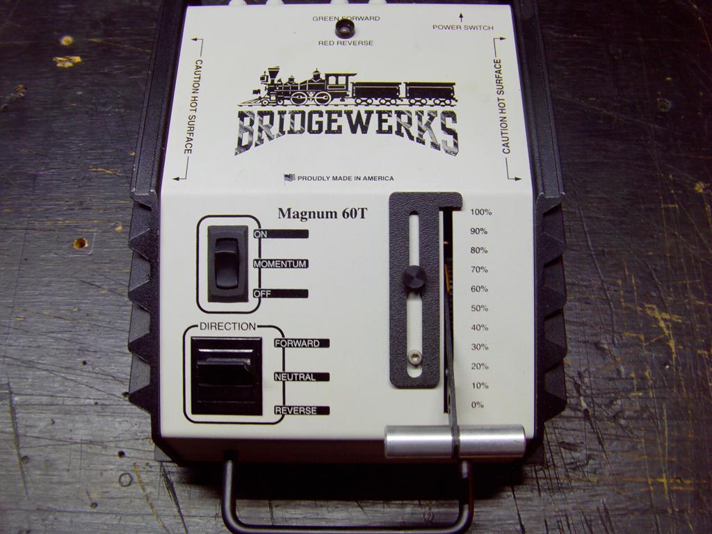

On my workbench I use the older predecessor model to the Morrison...The Magnum 60T.
I call it my Baby Bridgewerks as it's also rated 3 amps which is fine for bench testing various projects without getting into trouble.

The Morrision you have pictured  has  a  msrp of $275.00. That is not bad if:
it's compatible and
3amps is enough power for testing my DCS big One gauge steam engines and diesels.

This is Mark, with Bridgewerks - and I thought that I'd chime in with some comments on the 'Morrison'.
This is intended as an entry level controller - 3A should be enough to run any ONE locomotive, but if you want to run more than one locomotive, you will be pushing it.   The Morrison does not have any accessory power outputs or some of the other features that you would find on one of the bigger controllers.
The Morrison was designed with several new features in it - mostly to make it more friendly for kids to run:
As with all bridgewerks controllers, there is a manual speed limiter.
On the Morrison, if you switch the direction from Forward to Reverse while the train is running, it pauses for a couple of seconds in between so that it is more gentle on the locomotive.   If you just toggle the F/R switch back and forth, it will stop and wait until you stop messing with it, and then accelerate using the selected momentum setting.

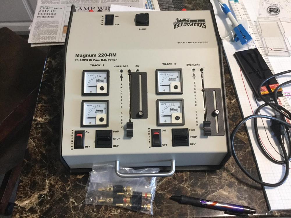

The very early designs, including the 60T had the T- handle throttle, and Bridgewerks migrated to slide controls like on Larry's 220RM - one of the weaknesses of that design is when kids spill soda on the unit, and it goes into the slot on the slide control.  The 'T' handle throttle connects to a potentiometer with a horizontal shaft, so it is less susceptible to dirt, soda or other beverages getting into the throttle.
