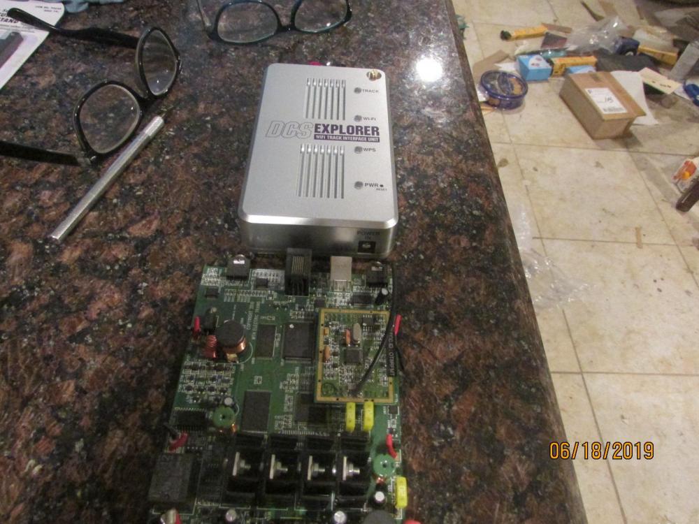

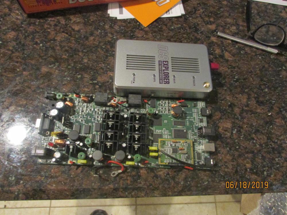

Here is the difference in size of the TIU in comparison to the DCS Explorer wifi unit.  For installation, a big difference.  Will probably make the difference of not having to have an additional car just for the electronics.  Also, I was thinking that since you can store 3 engines it the Explorer and it is so small,  I could install the one in three different engines that I want to run.  There is just 4 wires it could be easily taken out and put into a different engine, just a thought. It would save not having to buy two more Explores also. Bob.

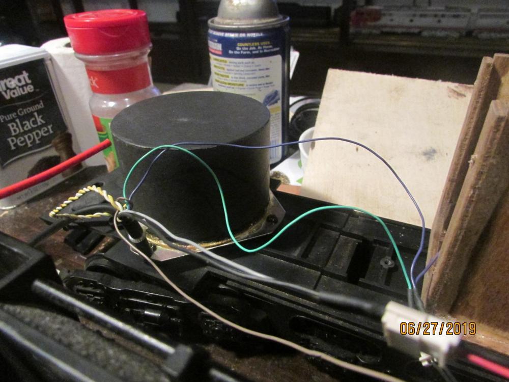

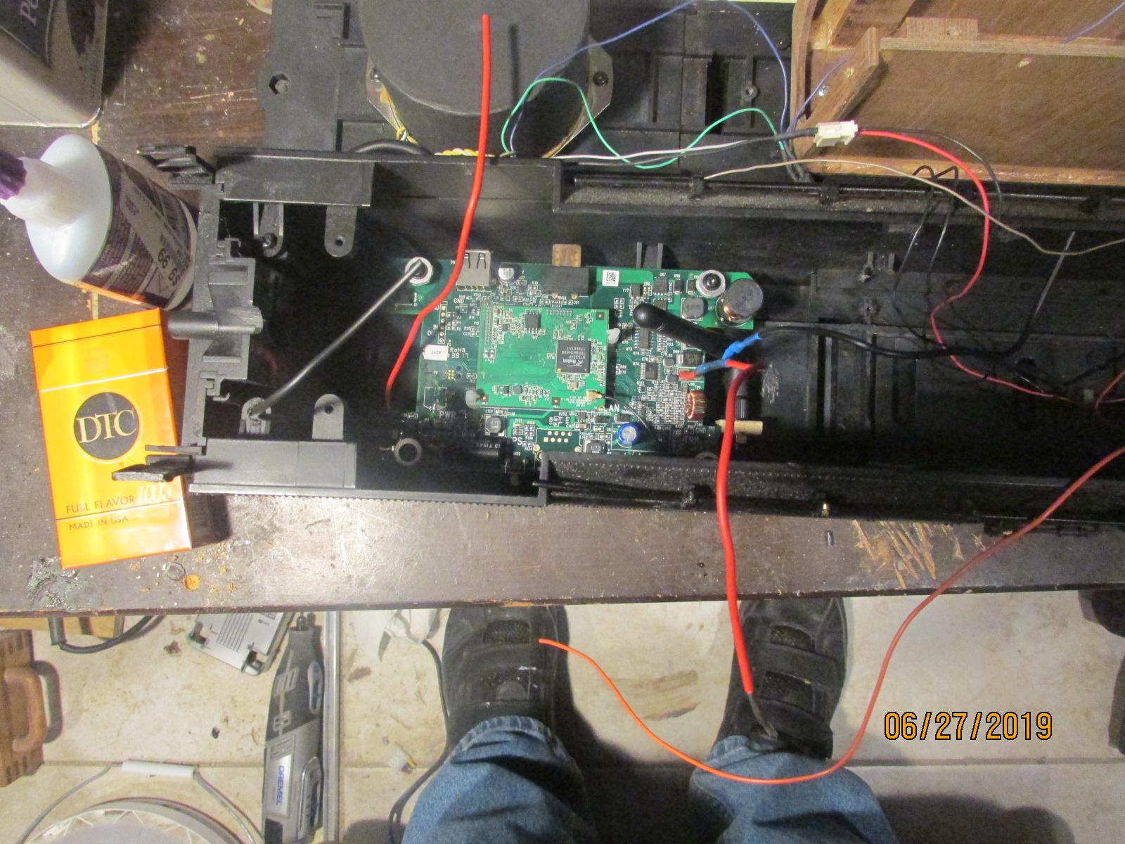

Here are some pictures of the Explorer mounted in the coal car of my Challenger. Also remotely mounted the antennae.  Had to reduce the height of the speaker resonator by about an inch.  Batteries are also in the coal car, so, no extra car needed. Bob.
Success, I got the Challenger running with the Explorer and my phone, now I have to figure out how to mechanically put it back together, as my memory isn't that good. Bob.
Sounds good Bob. Have to disconnect a lot of pickup wires, or just on the skates?
It's battery in and then the other side goes to the skate wires. That's all. You have reduced functions, but all the important stuff is there, Bob.
No, the skates come off.  I soldered the plus and minus from the battery, through a dpdt, center off, switch, one for charge and the other for power to the Explorer, and then the other plus and minus on the other side of the explorer, goes to the wires that came from the skates to the PS3 module and that is it.  Everything, batteries, Explorer card, and speaker is in the coal car.  Just got everything working great and now I am putting the loco back together, I think.  I tried to get a hold of Ray as I need the washer that goes on the drive wheel that the rods go on. lost one.  Do you have an extra?  The size is ID= 7.25mm and the OD is 11.85, maybe12 mm. thickness is about .58 mm.   Let me know. Bob.

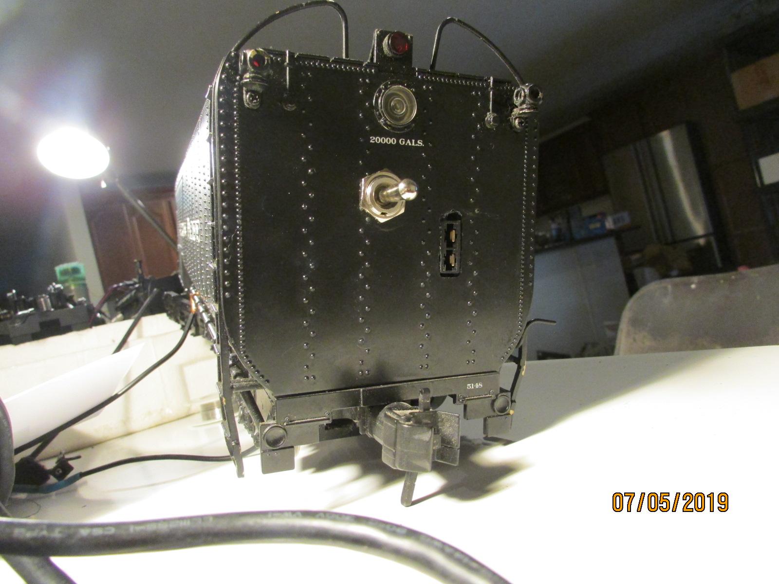

Here is a picture of the glued in charge plug and the DPDT, center off, switch, up is charge and down is run.  Center is off. Bob.

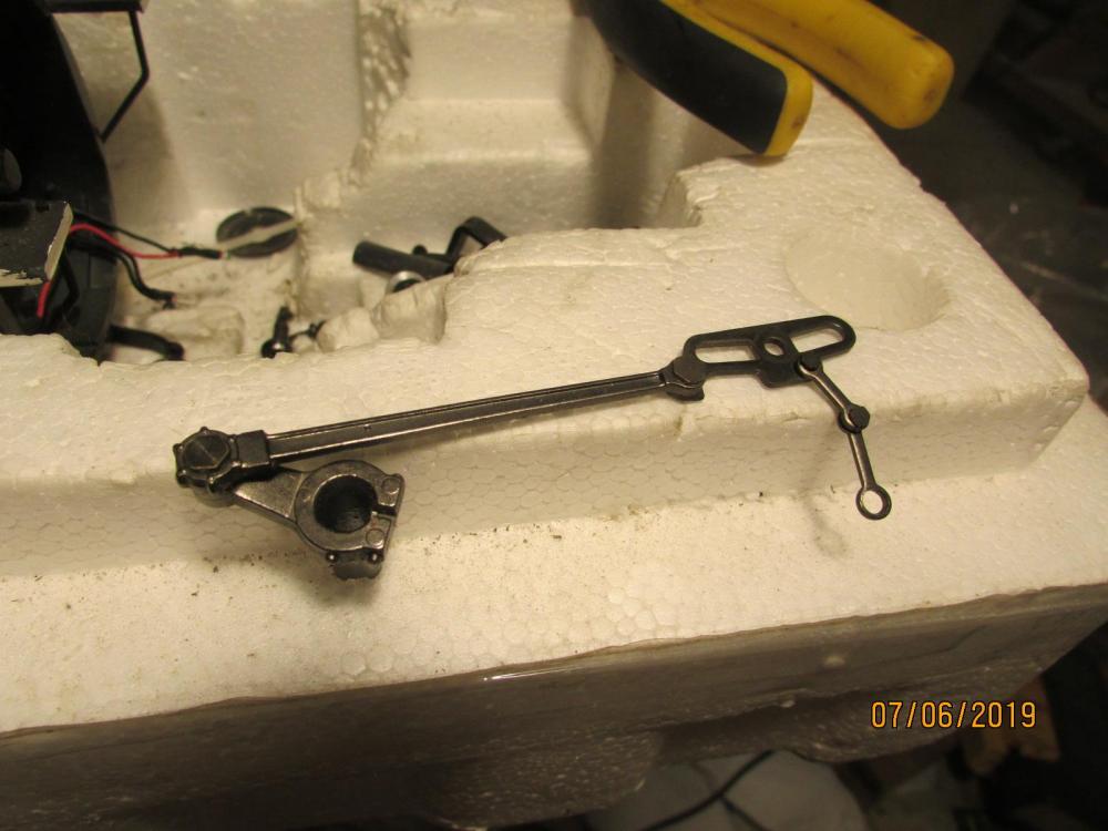

I also need this valve mechanism for the Challenger.  The one that I need is a right one. Bob.
Wow, what happened?  Might check with Ray.  Not sure what a beat up Challenger brings on ebay. Get one for parts?

I found the valve mechanism from MTH and now am trying to order the upper number boards and rt. and left marker lights.  When I took it apart, I must have put these parts where I could find them and well, I can't find them.  I am trying to order these from MTH. Bob.
Hopefully Ray can help with that ...:Thinking_Face_Emoji_large(24x24):
