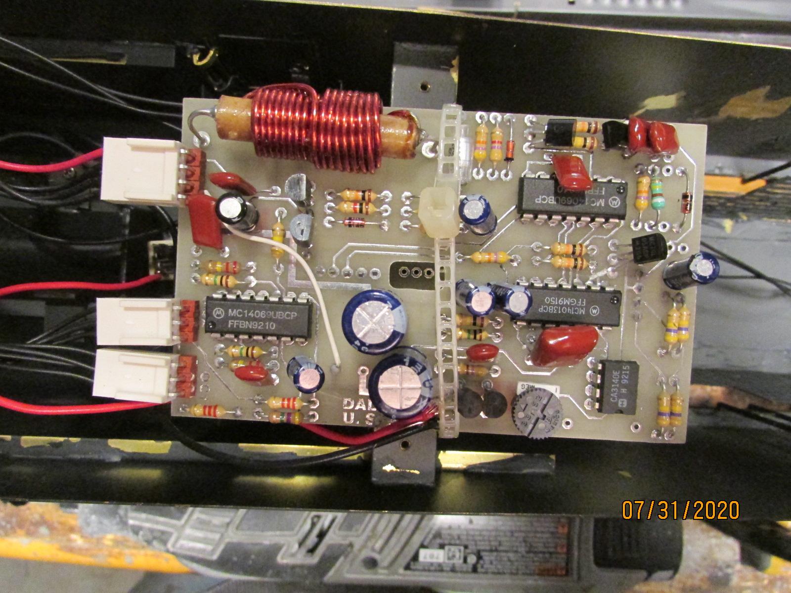

OK, here is a picture of what is in the tender of the T1.   There are two boards stacked on one another.  The numbers on the boards are 583 and the top one is 584.  I don't know what they do, but I tried to get a schematic and some info. from Dallee and even looked in their older section and found nothing that looked like these cards.  I assume that there is another card in the loco, but I don't know.  I will eventually have to open the engine up, I hate to but that is what I will have to do.  I will say that opening the tender was easy, just eight small screws.  I hope the engine is as easy.  If anyone here has any info. I would appreciate it.  I have also sent an email to Dallas at Dallee and haven't heard yet.  Thank you, Bob.
Seems if I can remember correctly the old Dallee stuff was exactly like Shawn stated, can only play one sound at a time. Reason for the 2 boards is for 2 different sounds like maybe 1 board for horn and other for bell. I remember the old Dallee website would list the multiple board numbers.
Thank you very much.  I think you are right.  I will try to find the old Dallee site. Bob.
Yes, I think your right.  That is the closest I could find.  Next, I am going to open up the engine and see what is in there.  I think, after looking at this system, I will stick with what I know, and that is MTH DCS> BOB>
I did, not much on this old system.  I am going to try first to run on this system, and then if I don't like it, I will switch over. Bob.
Dallee contacted me and said that the only thing in the loco., unless FAM changed it, is a magnetic pick up for the chuffs.  He also said that getting a schematic was not possible because it is proprietary.  So, I told him that he said the magic word, "proprietary" and that is why I will go MTH, DCS, because they allow schematics to all of their sound systems, so a guy like me can see where the wires go.  He told me to be my guest and that FAM installed it and that they would also be proprietary also, hence no schematics, oh well, this won't be a problem now, since I will be installing the TIU OR The explorer, I don't know yet, I am thinking it over. Bob.

Thank you chuck for making the effort to help me.  I talked to Dallas at Dallee and I think that he is the original owner, but I don't know.  I also talked to George Kohs and he seems like a nice man, but didn't seem to want to take the time to give me any hints.  It is a possibility that he has never taken one apart as the T1 was  built by a Korean brass co. and they came already put together.  I also don't know that for a fact.  The only one that I know that has taken one apart is Simon Du_bousquerre and he hasn't answered my private message yet.  If he doesn't answer then this is what I am going to do and might be fun.  I will make a video taking it apart without any pre_work and so we will all get to see what a puzzle this thing is at the same time and see all of the mistakes that I make in real time. Might be fun.  OK, I did find the era 1992 boards on the Dallee website and it did show the connections.  According to Dallas, there is no sound or motor control board in the loco. itself.  These two boards in the tender are for the chuff and the whistle and bell. The motors are controlled by track power.  The only item in the loco. is a timing device on an axle for the chuff.  So, this is a real antique.  I am either going to go with a TIU, sound and motor control board, and batteries.  I will have to drag a car either with a TIU or an Explorer because of the batteries.  But, I think this T1 deserves good sound and I am used to these installs. Bob.
