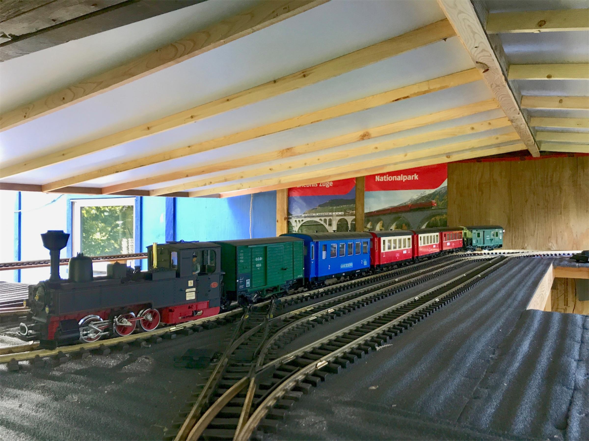

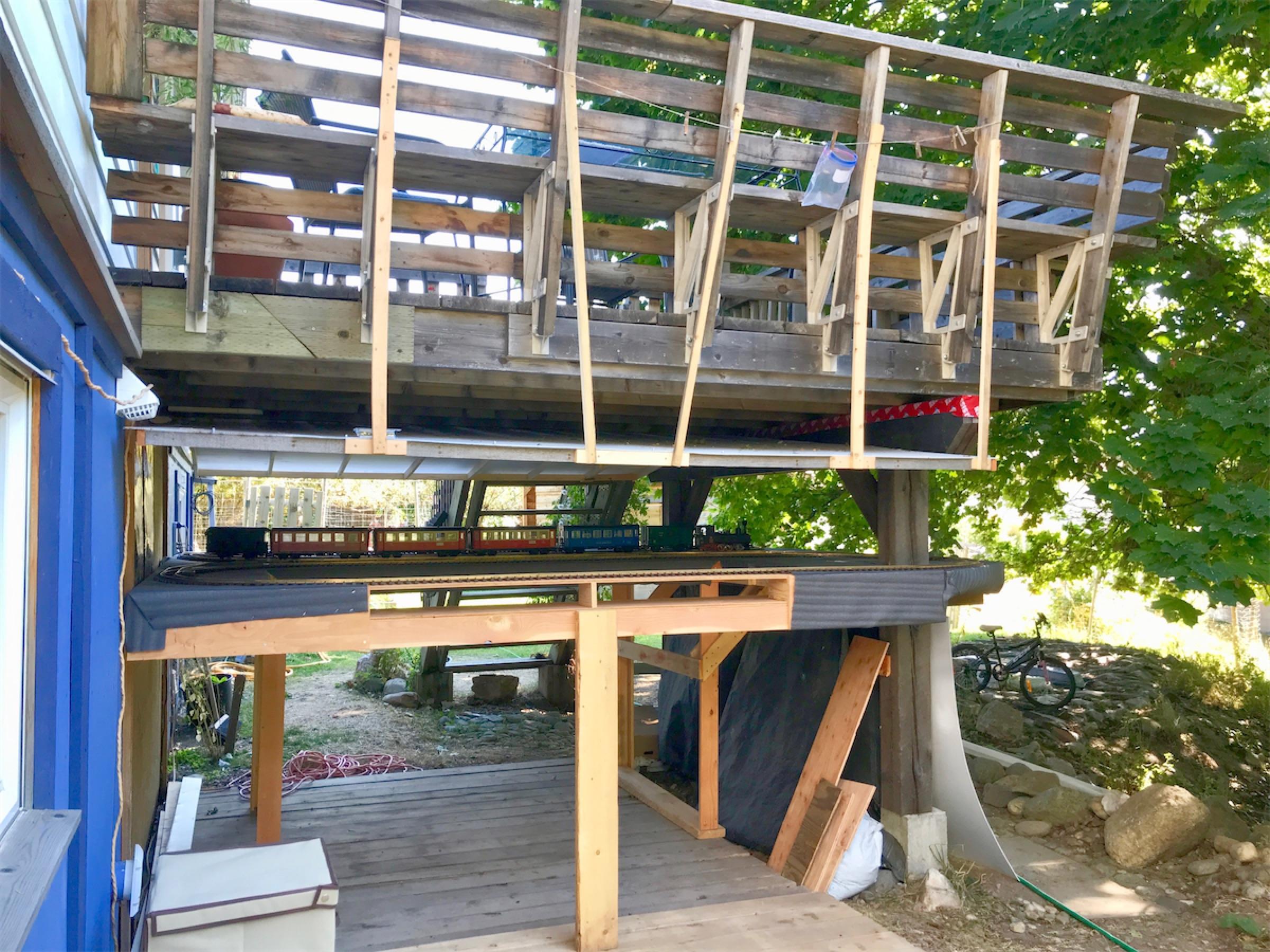

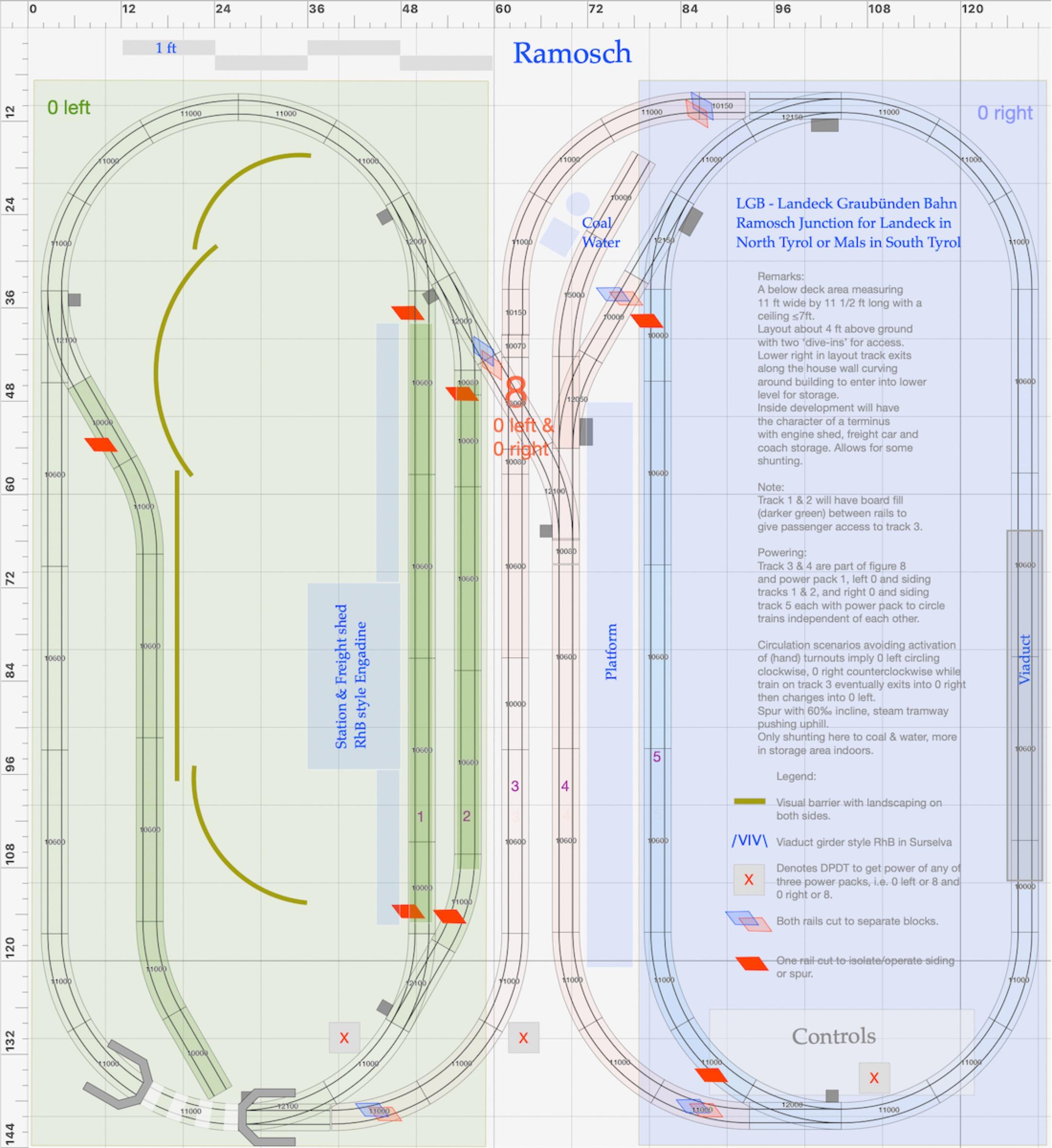

To illustrate my beginnings:
4596745_RmoschJnctconcept.thumb.jpg.f81a8449b4a947f1c1ea41fc8225c803.jpgIMG_1261.thumb.jpg.96eee185fa688caa1bf97eb3842641f7.jpgIMG_1262.thumb.jpg.70dc49dbeb5e9f1ac6c6cbecd7d36152.jpg
