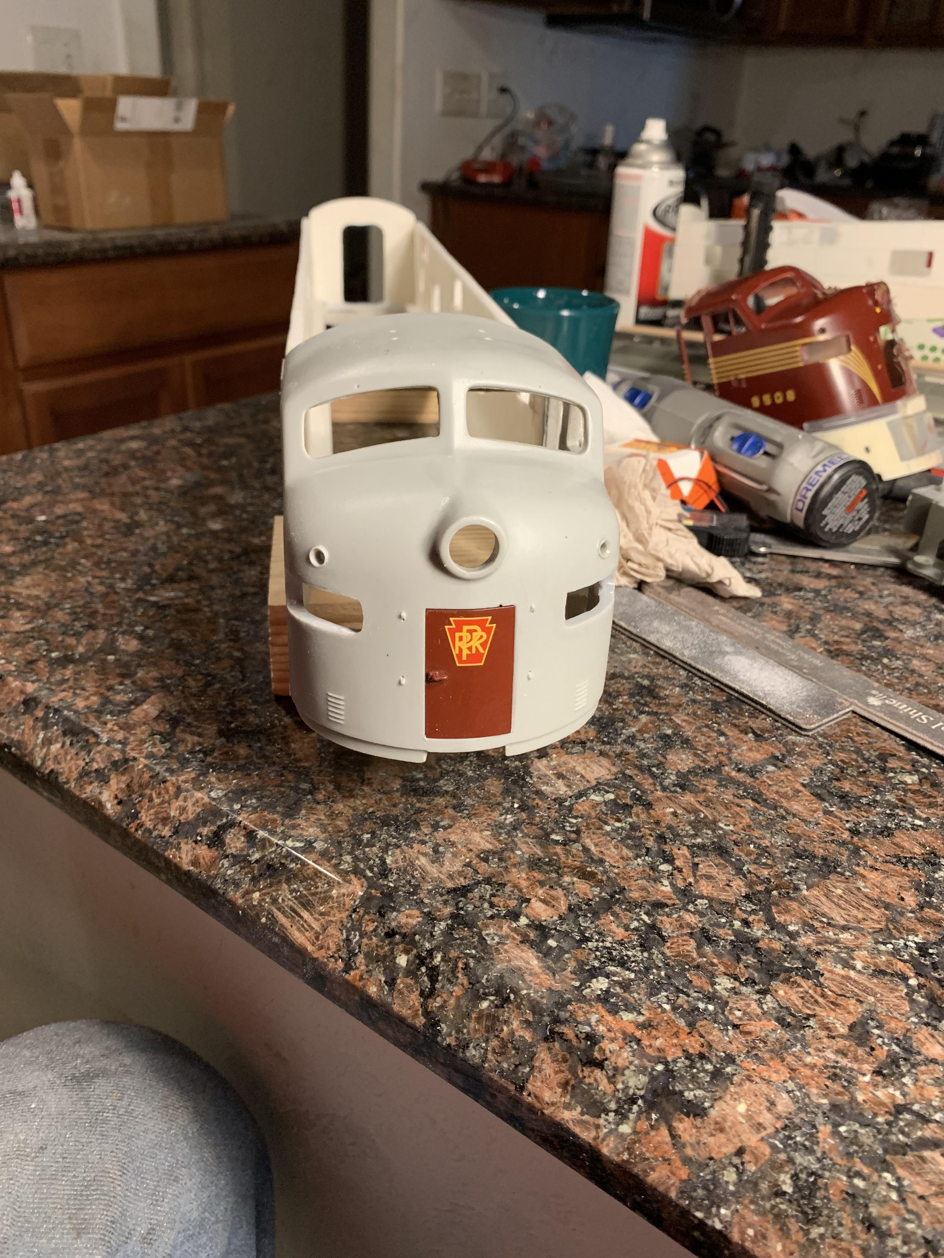

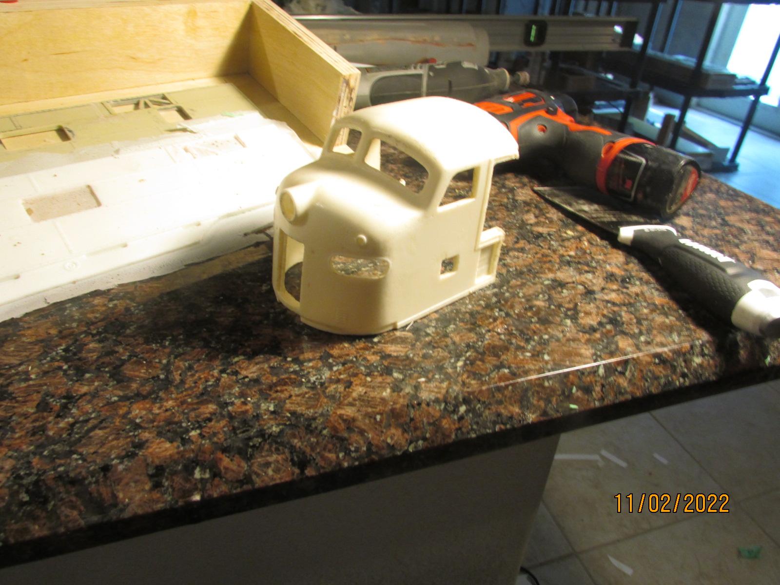

I am finally getting around to building an E7 A and B for  the Broadway limited with some Finescale cars.  This will complete my  4 trains with the correct locos with the correct, I hope, cars. I will have to replace the number boards on the cab to the earlier style. Bob.

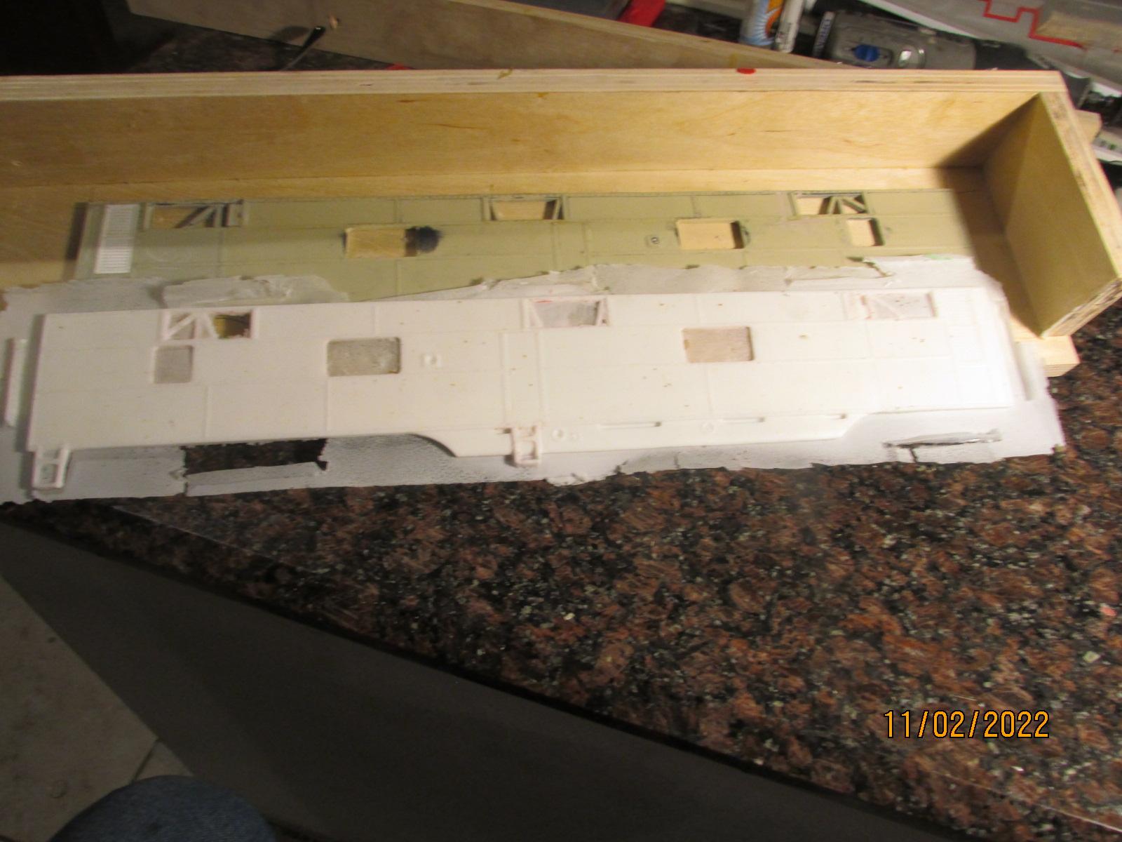

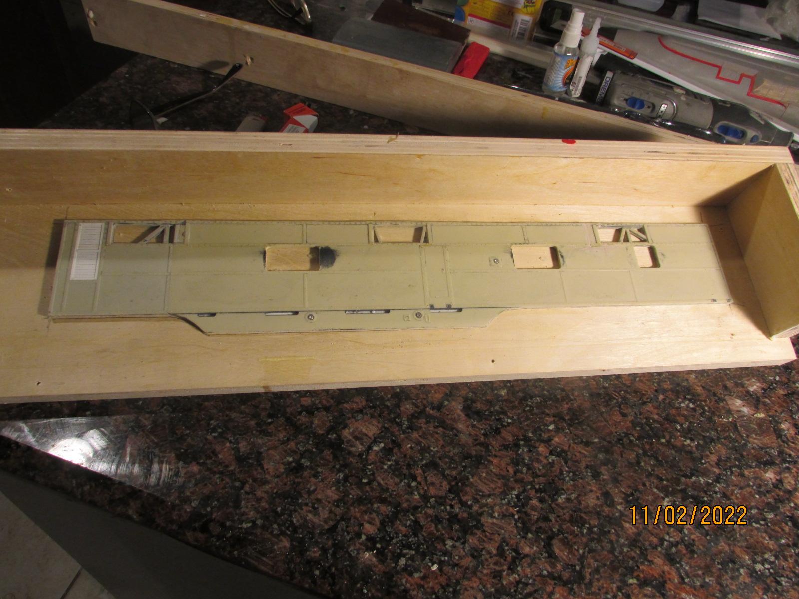

Yes, my no. 1 interest is building  I have both sides molded and I am going to pour some sides today. Bob

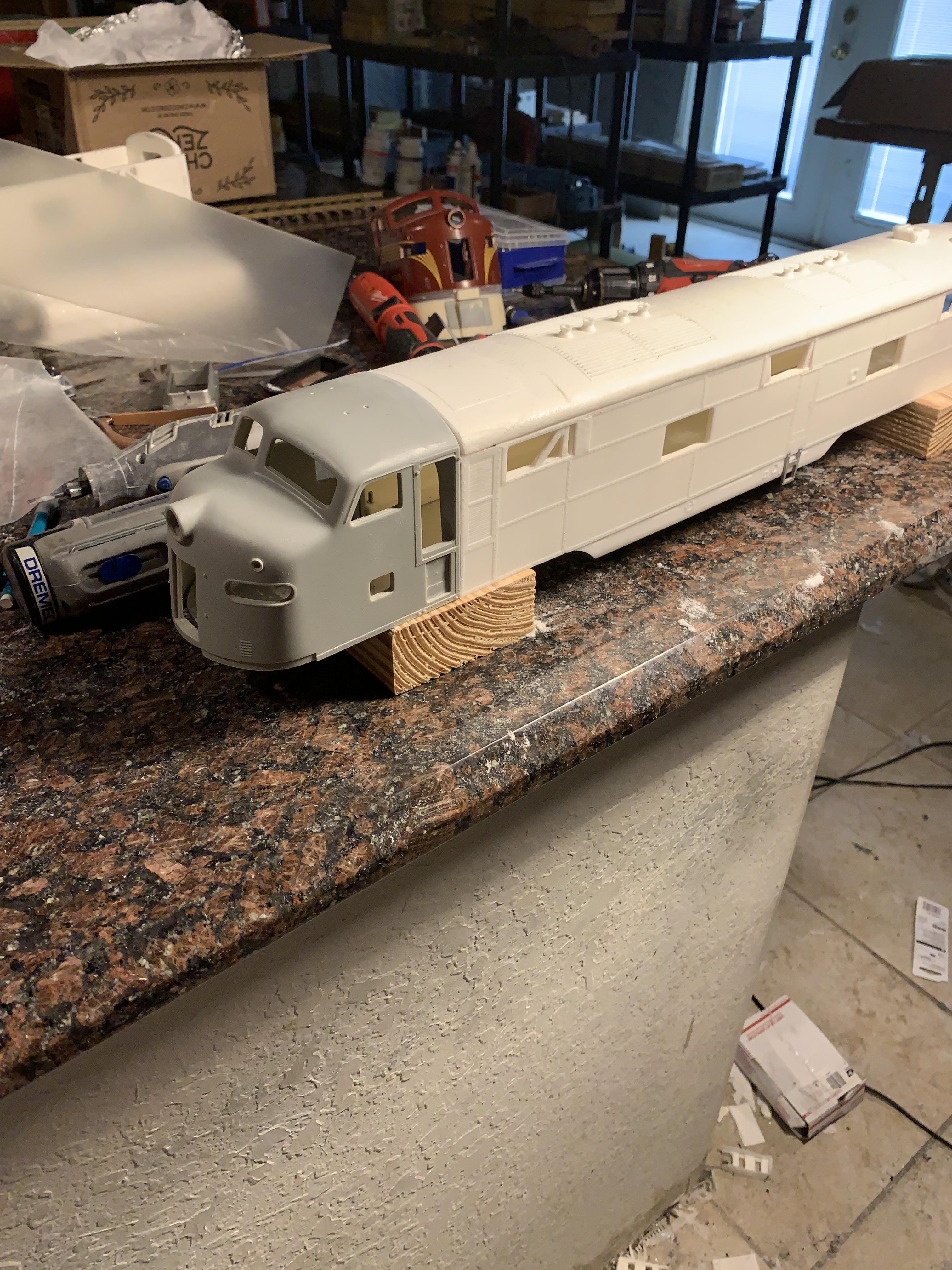

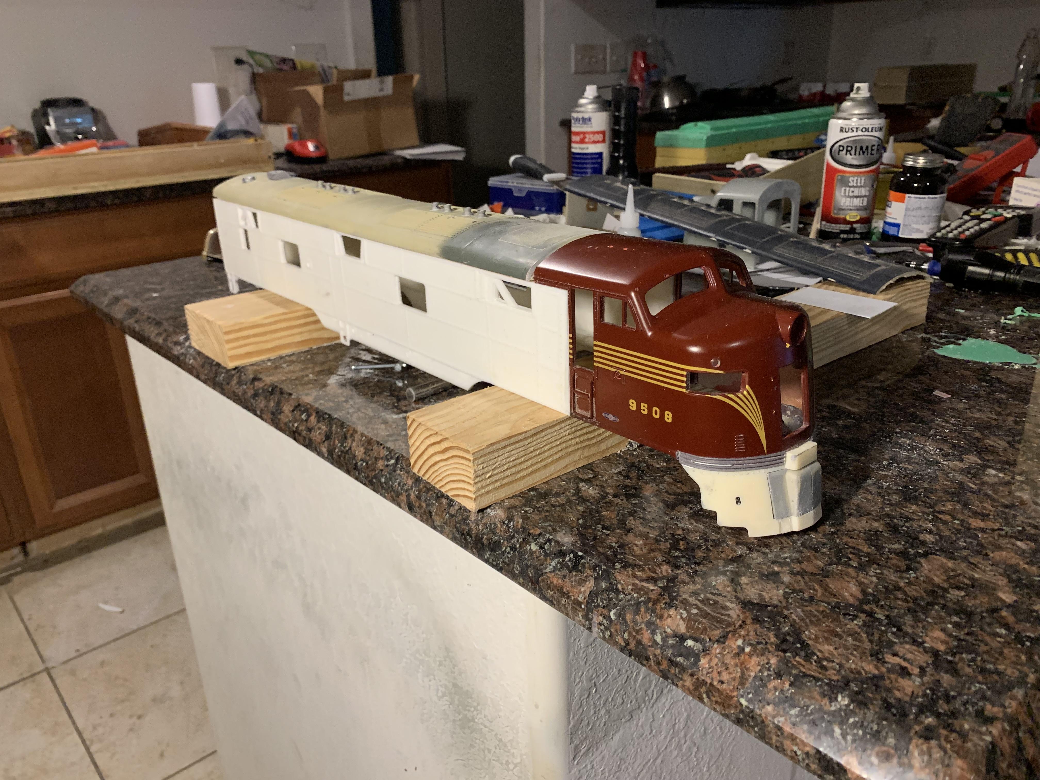

I am tooling up for the last big part, the roof, I, ve got all of the other parts, so almost ready to put it together. Bob.

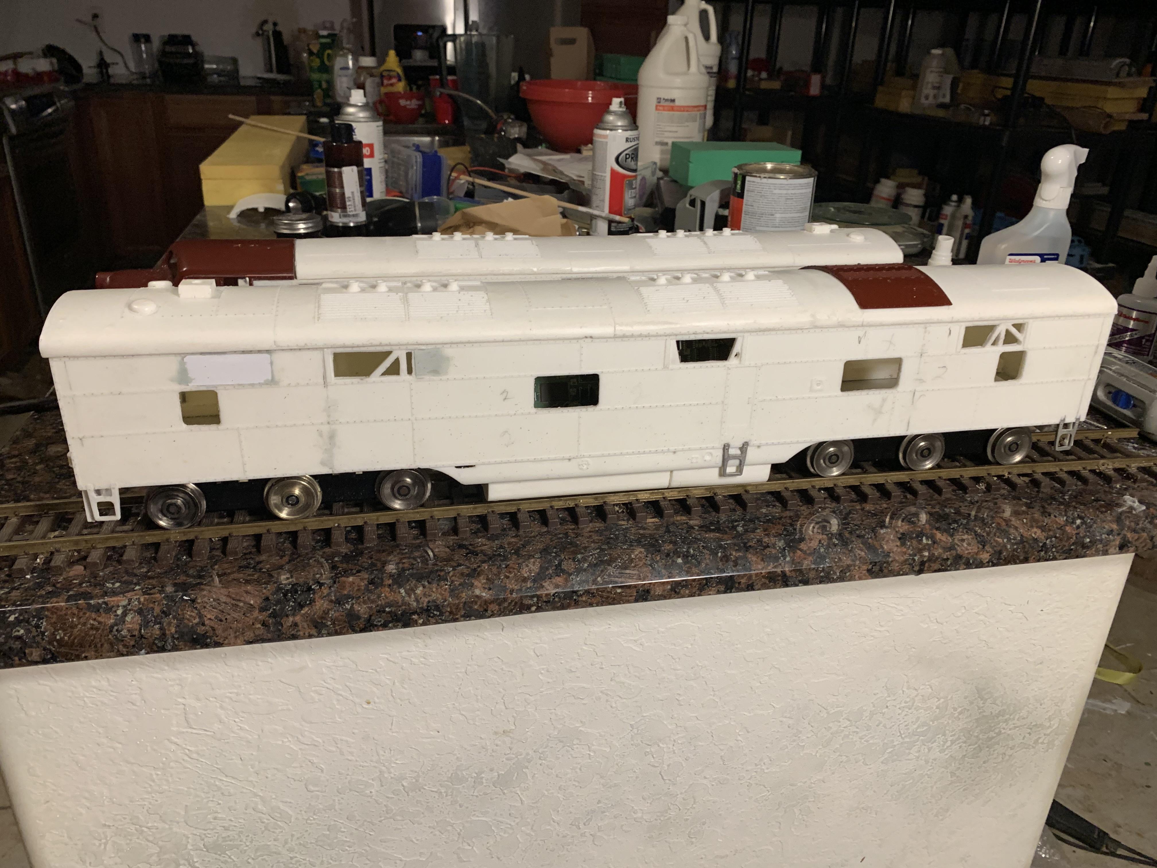

Here is what I have done so far.  Ordered the PS 3 from Ray. Bob.
I'm looking forward toward a video with it running.. What are you using for running gear/ control ? Oh Ya very Hansom

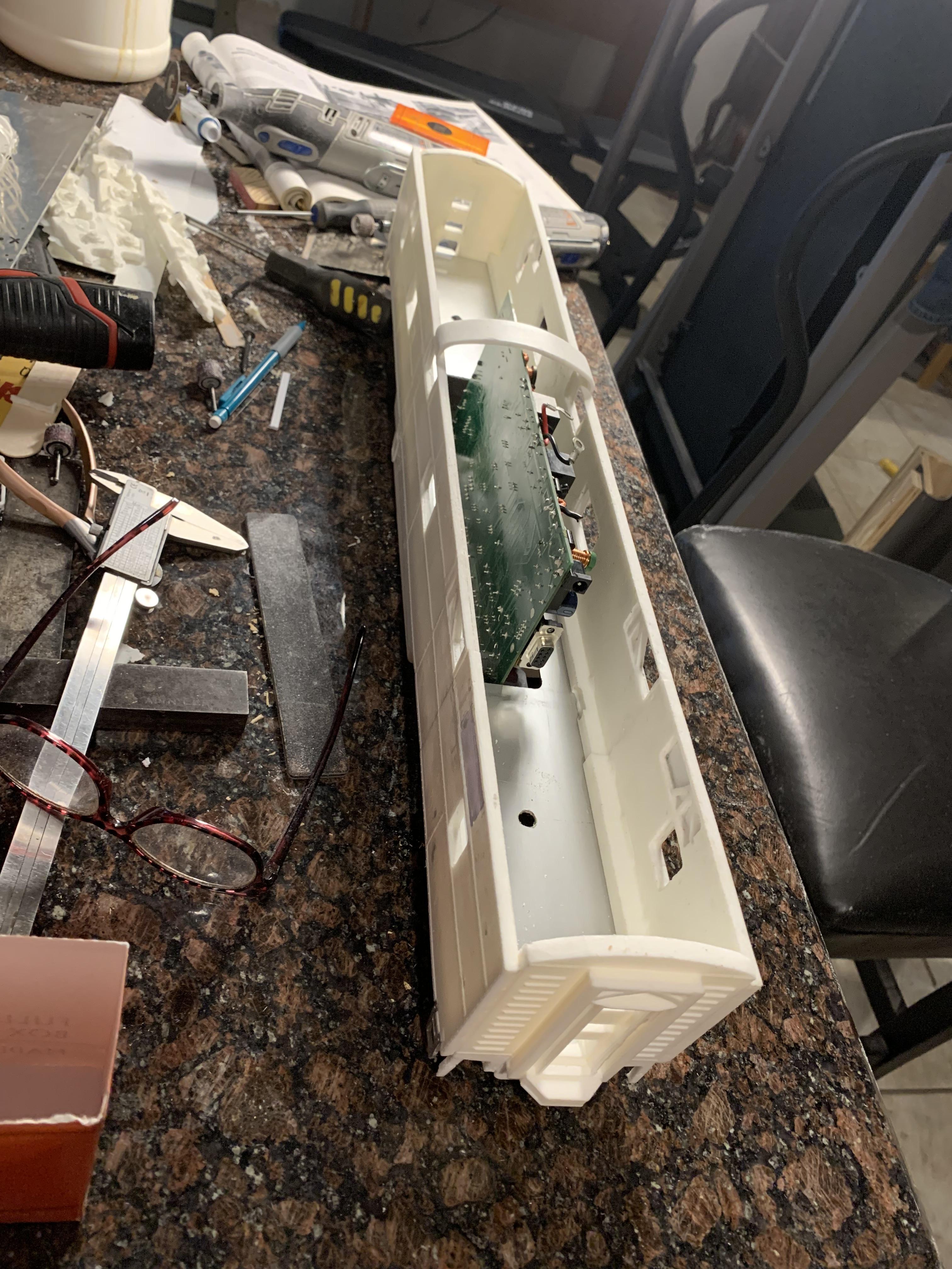

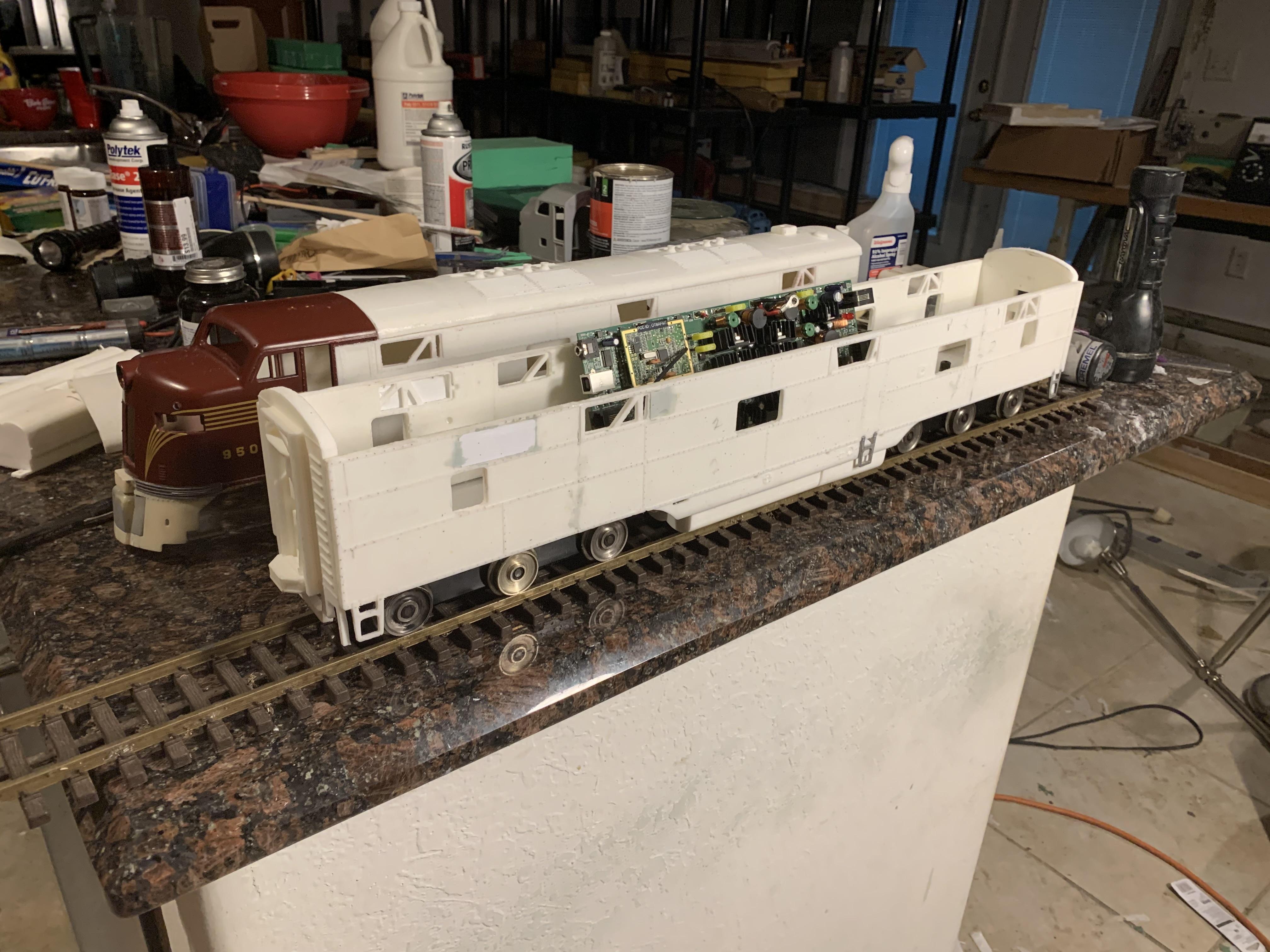

Fitting the mth electronics in the B unit and hope that it clears the trucks, looks like it will. Bob.

The reason that I used an F3 cab is that is has all of the proper mounts for the lights, cab interior light and the engineer and controls mount. In the B unit, I used a roof vent from the F3 also to allow the sound to escape from the B unit. Bob.

It appears that you are installing the whole DCS system in this case. What exactly is in that B unit?
The TIU., and in the A unit will be the MTH decoder and battery. Bob.

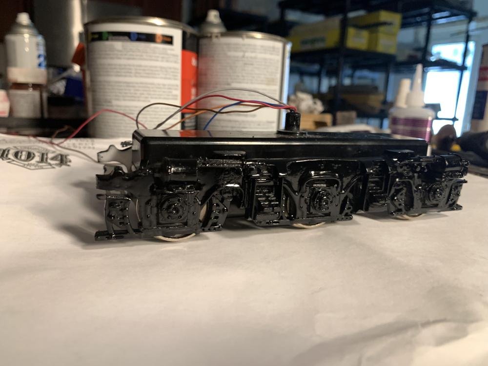

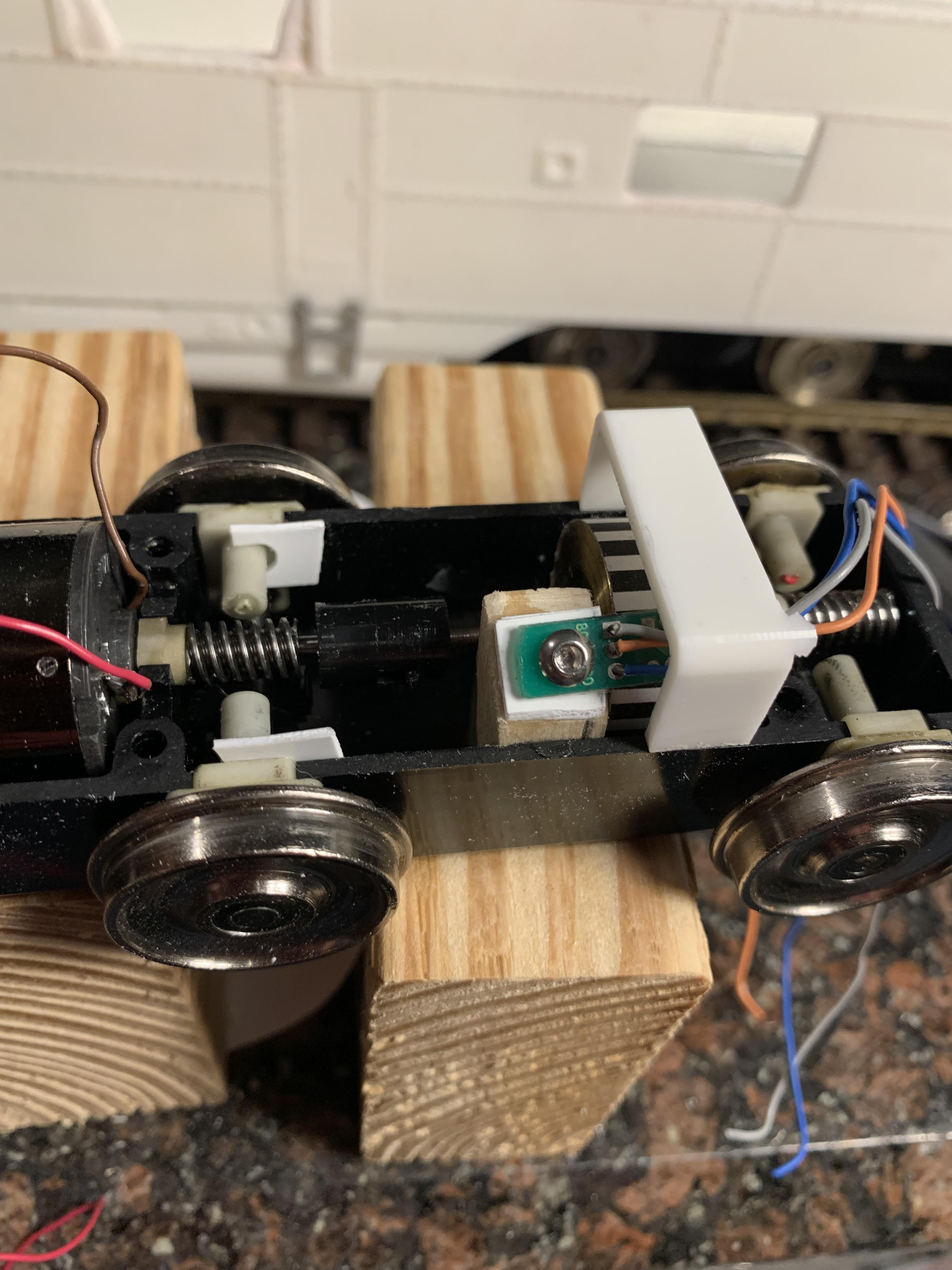

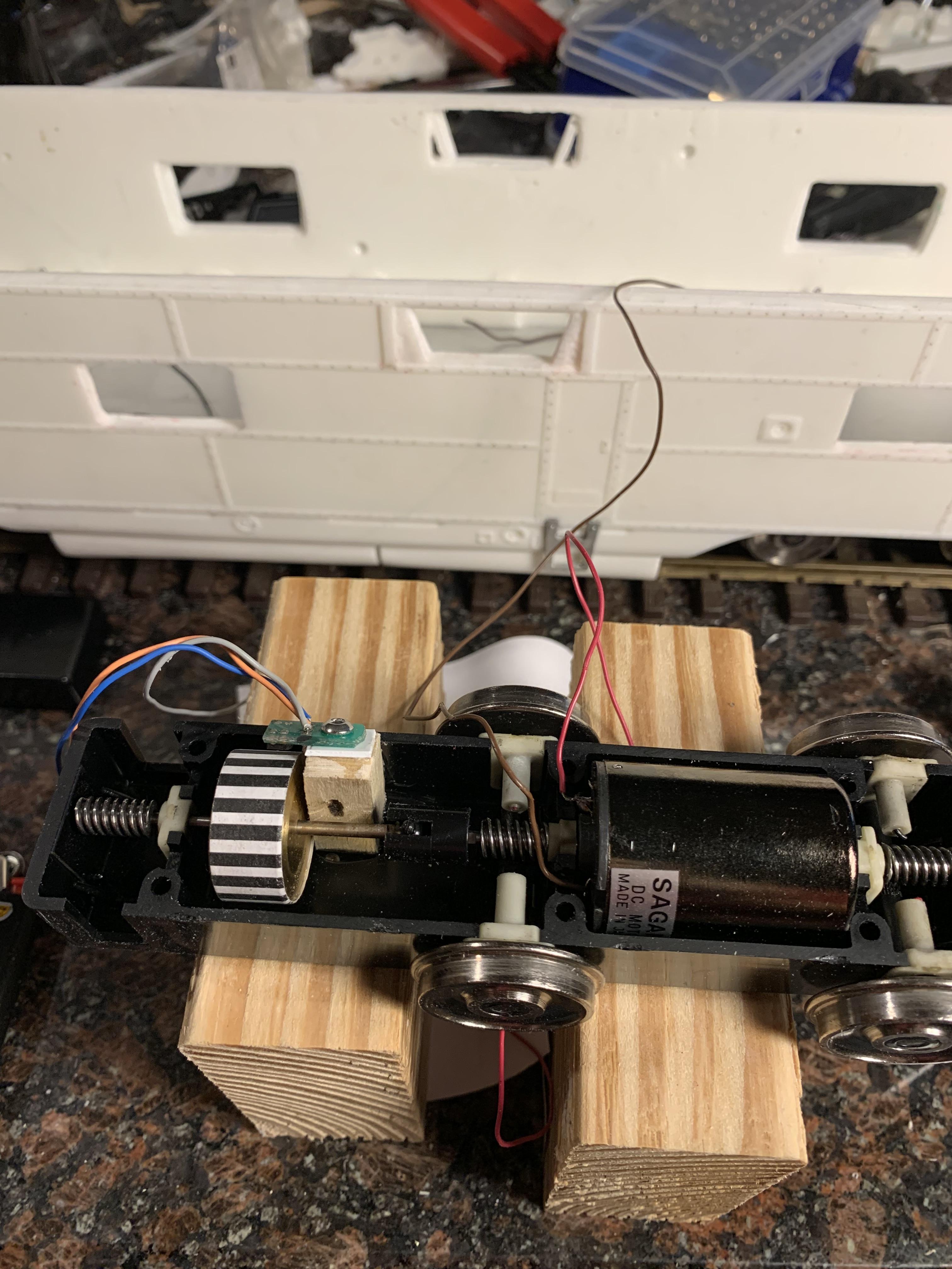

Here is where I installed the speed sensor. Bob.

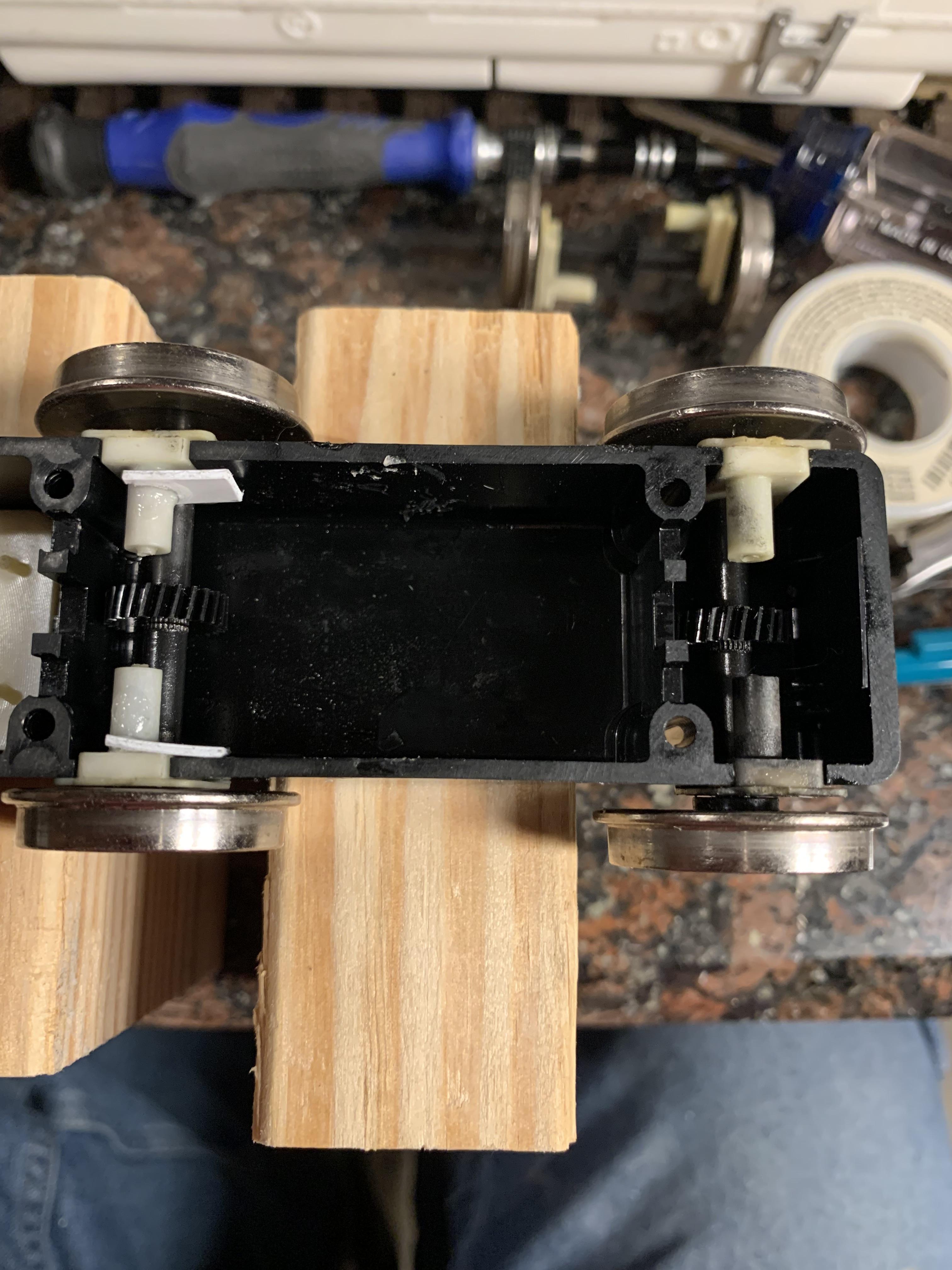

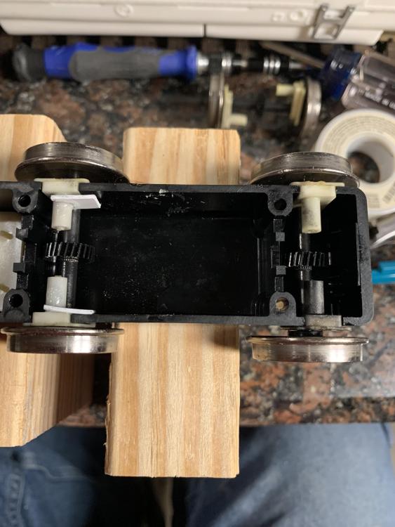

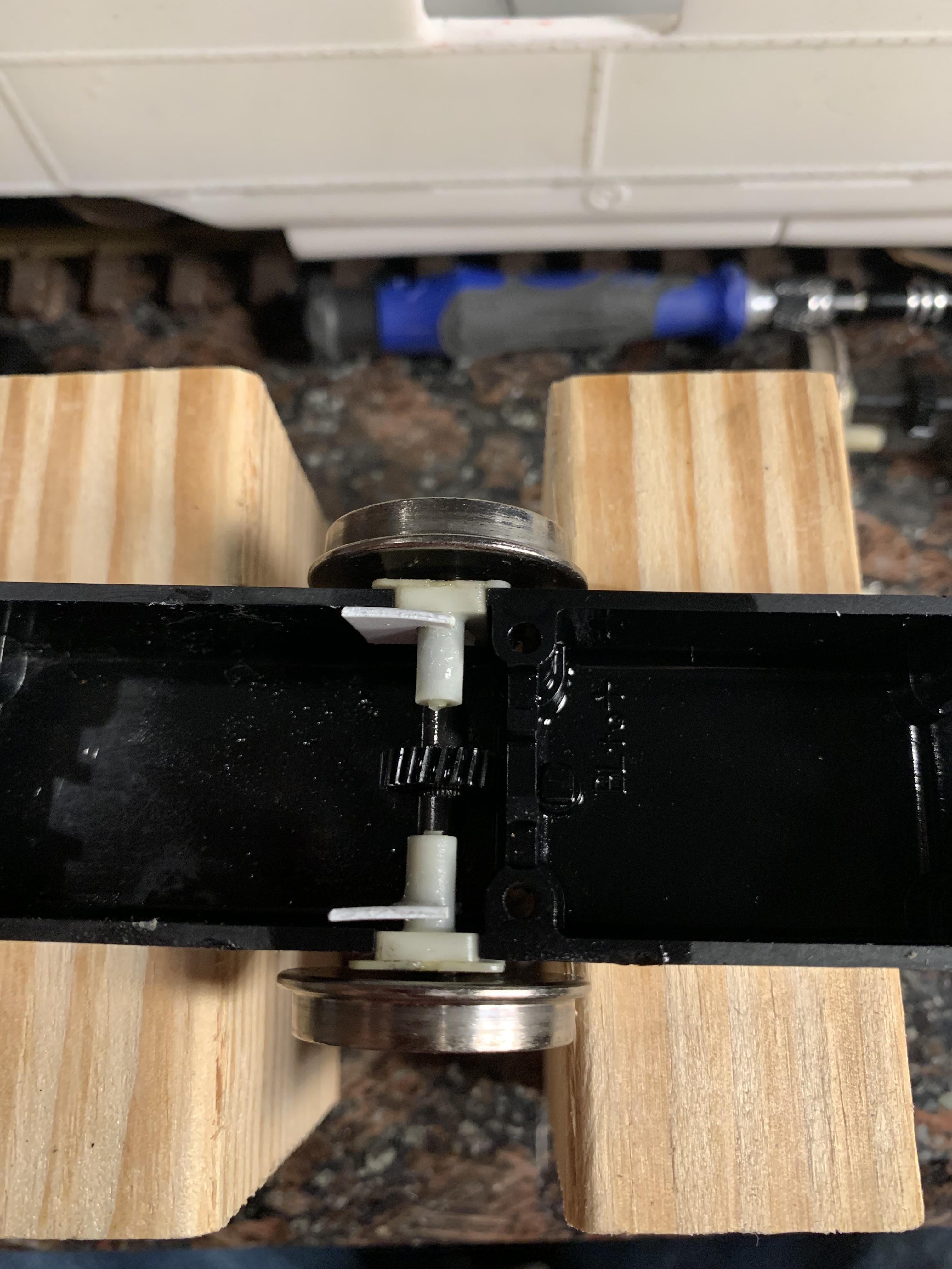

Some of you may know this about the center axle of the 3 axle NWSL block.  The center axle does not have bushings between the case and the wheel as the outside axles have.  The center one is allowed to float for tighter radii.  Well sometimes the pickup bearing will float outside the case and cause the axle to tilt.  It will not right itself, so the only way to correct this is to disassemble the block and re install this bearing.  The white tabs that you see, were glued on the bearing to prevent the bearing from slipping outside of the case.  The axles are still allowed to track back and forth without dislodging.

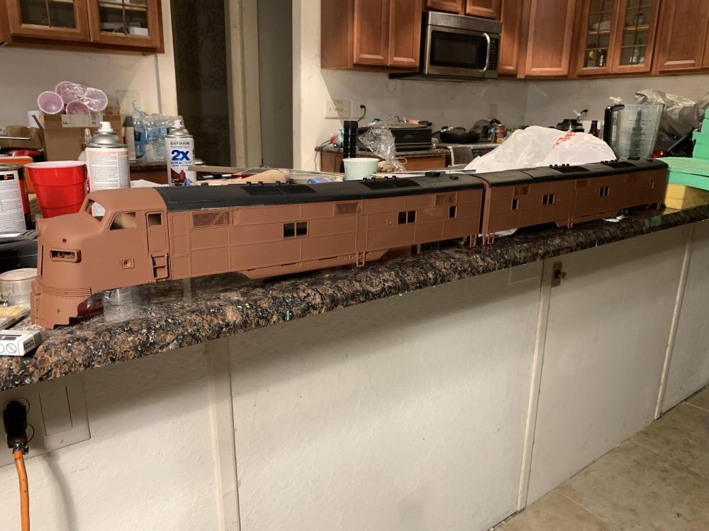

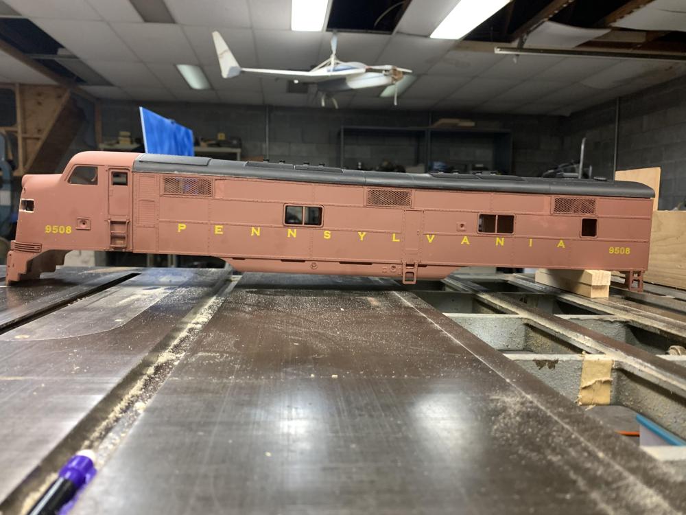

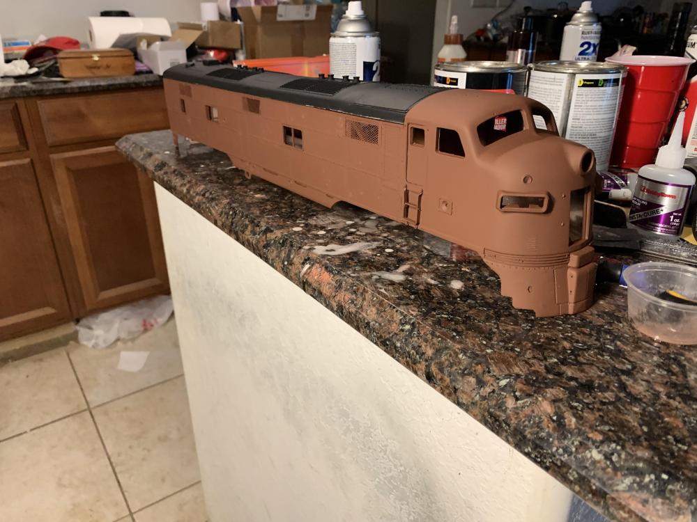

All of the hard stuff is done, now just painting and final assembly is necessary. Won't be long. Bob.

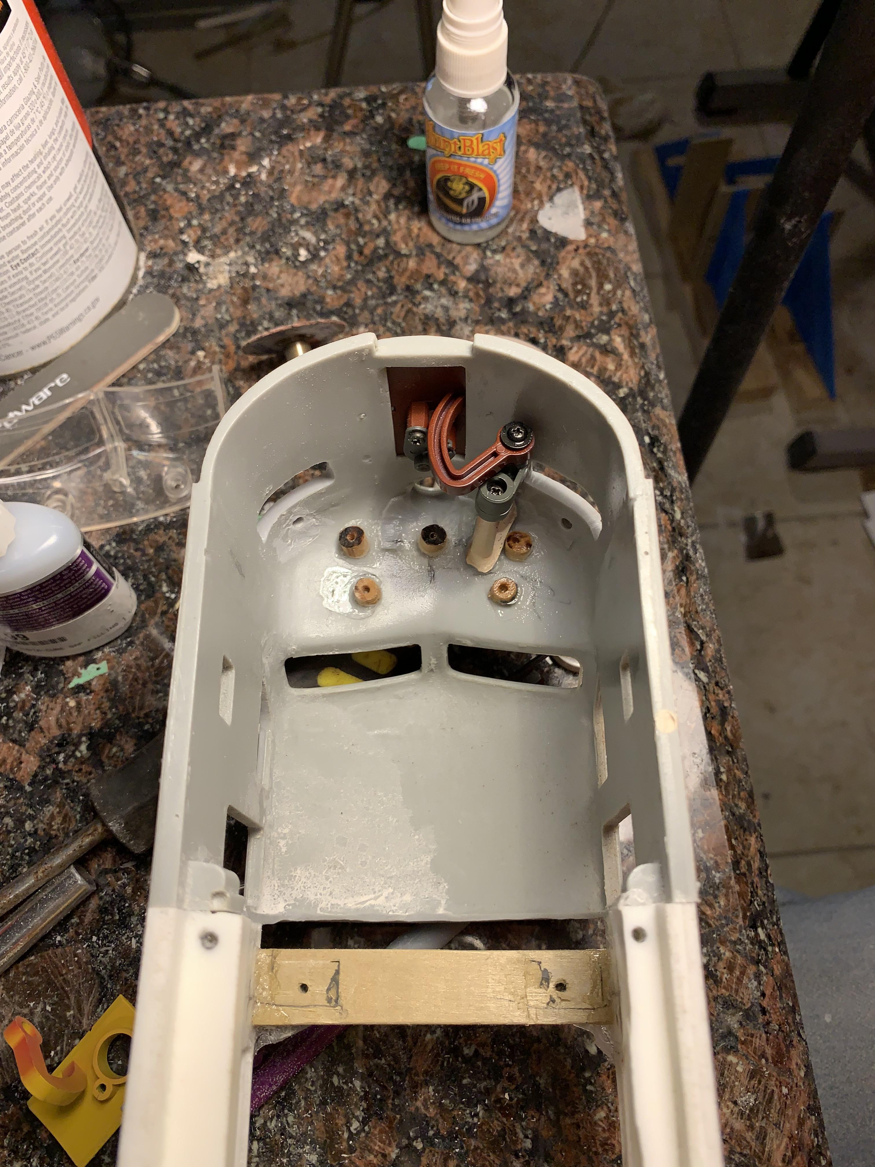

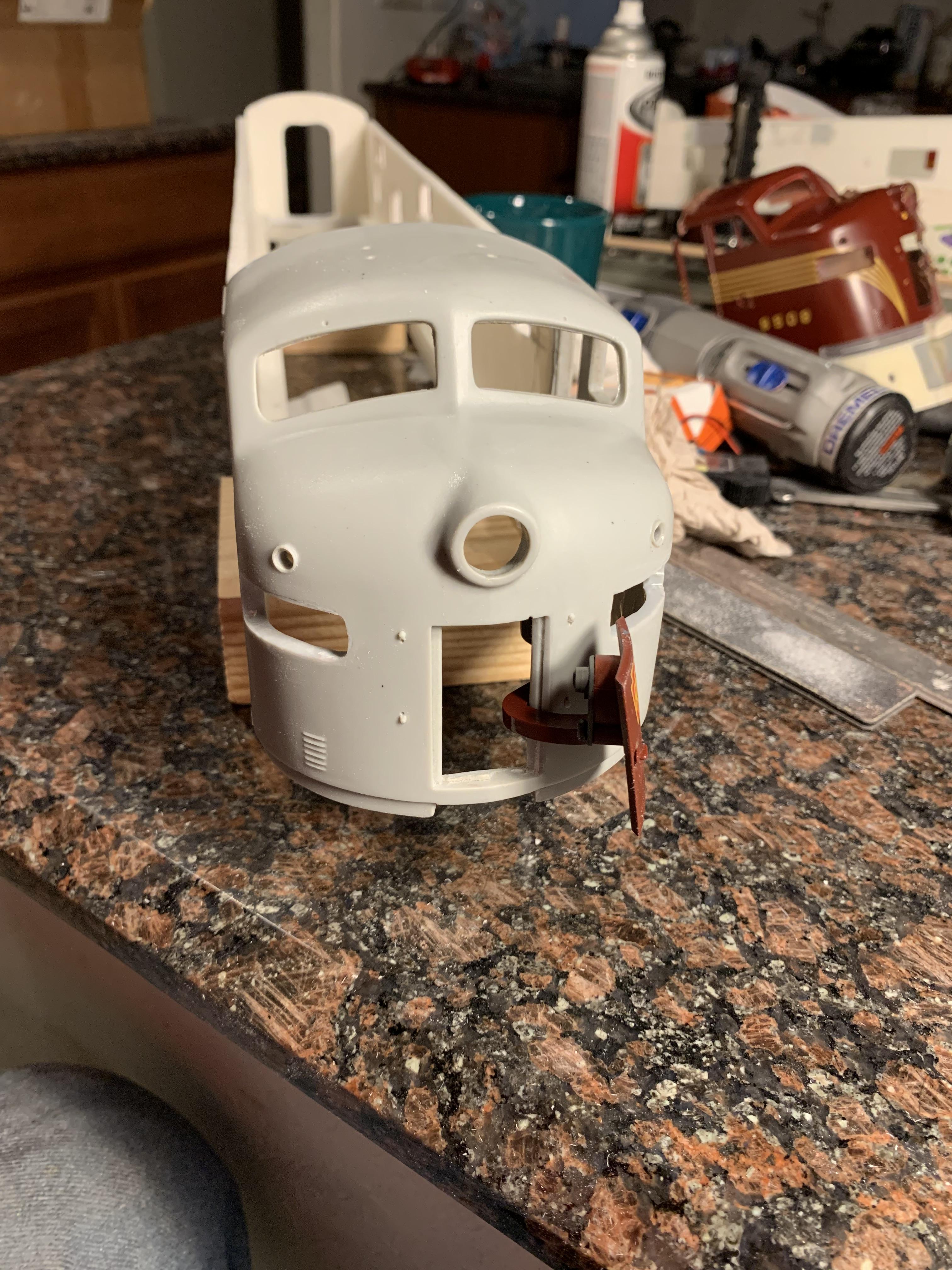

I have changed my mind about using the MTH cab.  I removed the cab and replaced it with the Rich Garich cab as it looks more accurate than the MTH cab.  I will have to construct the MTH mounts within the cab for mounting the MTH stuff. Bob.

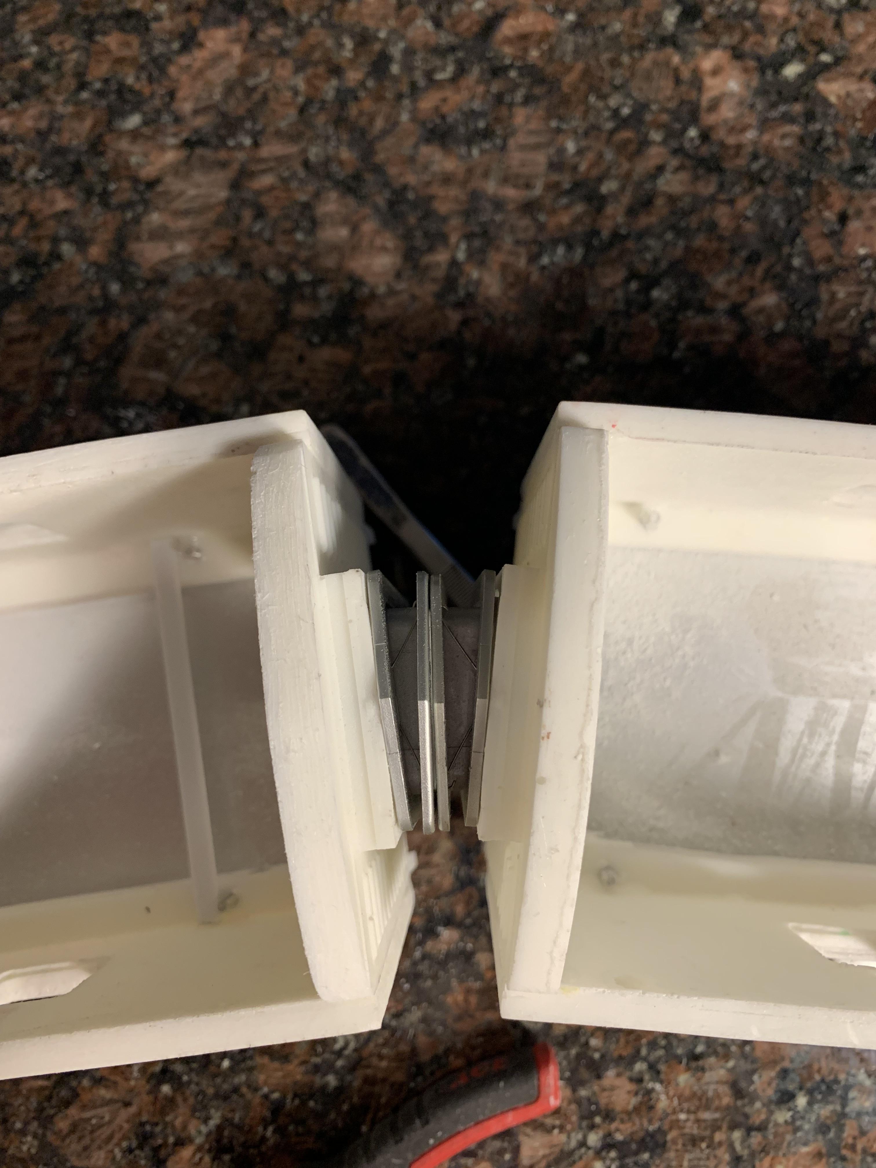

The mounts for the door, lights, cockpit have been mounted. Also the diaphrams have been fitted. This is plus for building in 1:32, even parts from other manufacturers fit. The door fits perfectly. Bob.
