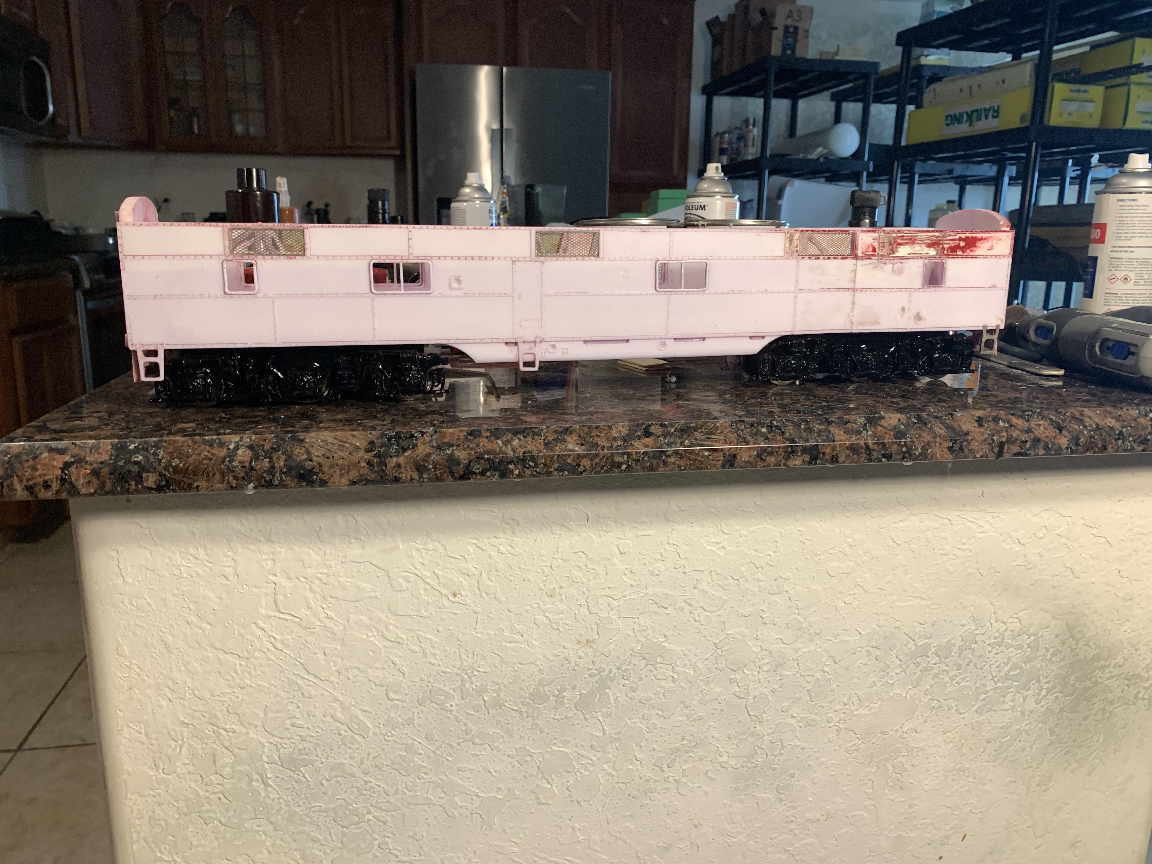

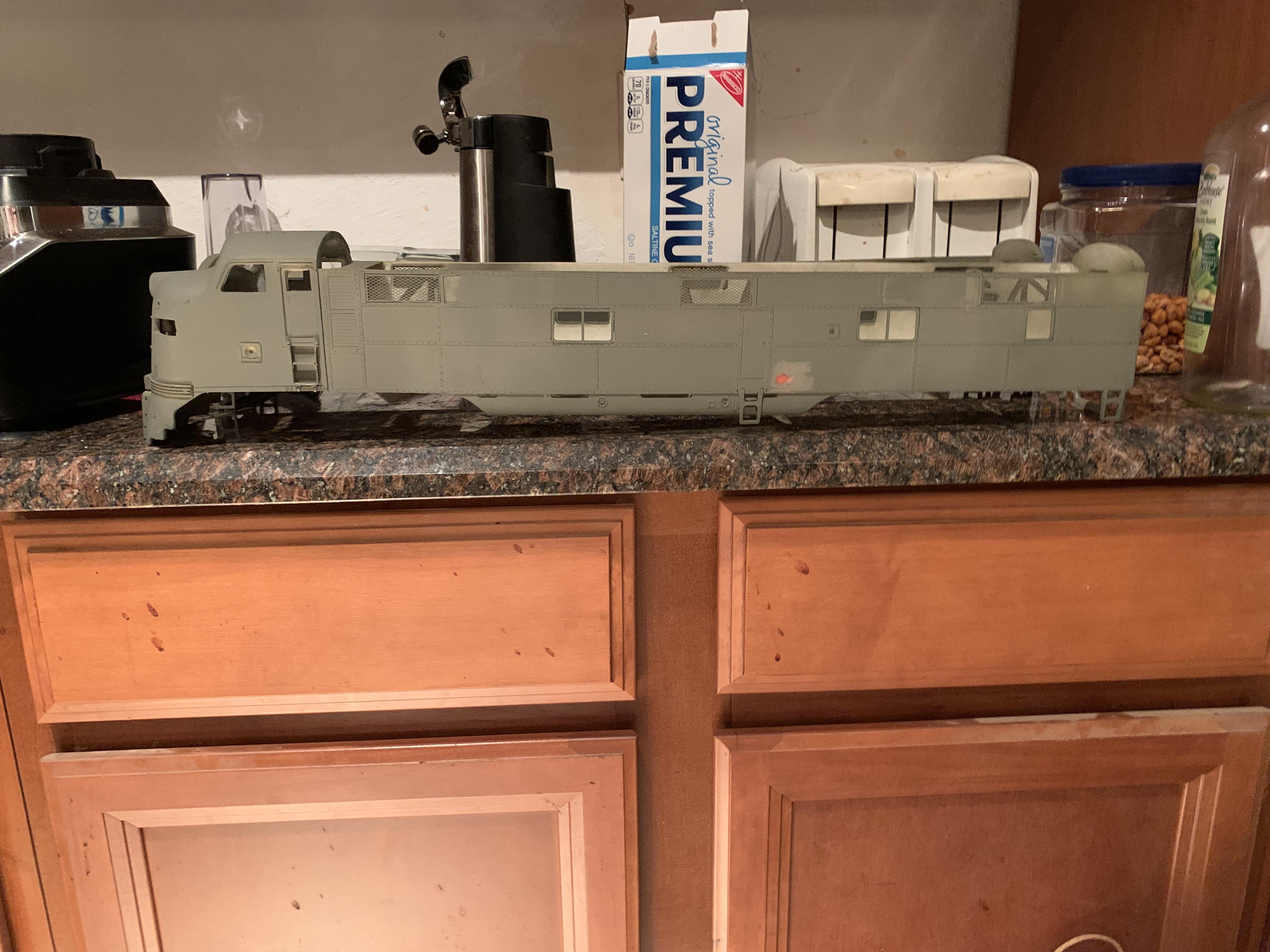

Prr e7-a and e7-b construction
You don't hear that often ..
  • Replies 53
  • Views 8.4k
Thanks, next is the paint if I can find the correct Tuscan Red. Bob.

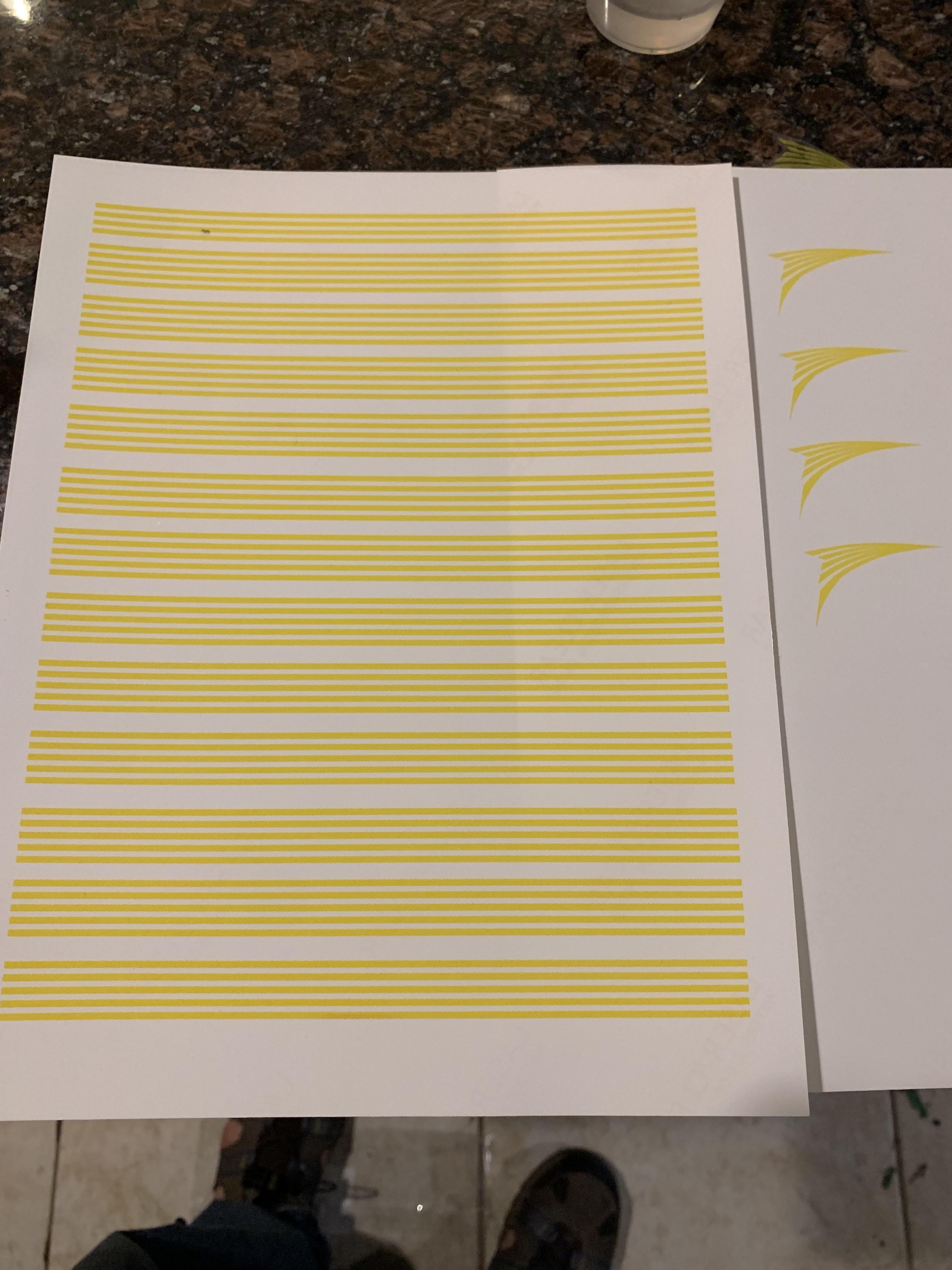

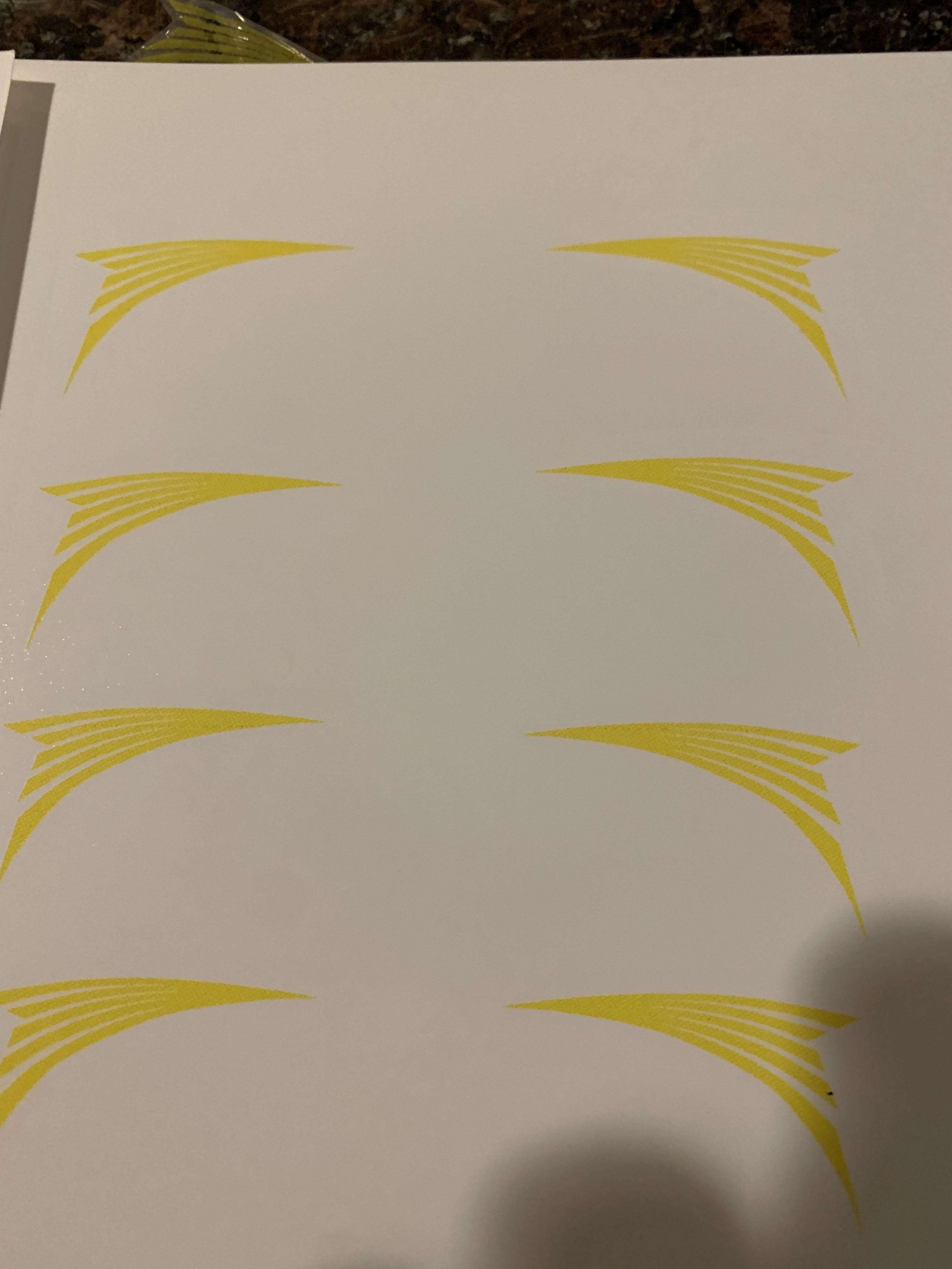

I finally learned how to use my Alps printer.  I am going to attempt to get these decals on the locos without wrinkles. The last picture was a test to see if the decal was not transparent and it is not, so it worked.  I layered the colors, white, then one spot yellow, then, two layers of the regular color yellow and then a pass with the clear cover print and the color came out opaque not see through as some of my experiments did.  Bob.
You are full of surprises ...
Yes, i kept hearing how great these Alps printers were, but until I, by trial and error kept trying to figure it out did I have success.  I now agree, for decals these printers are the best.  The best trick that this printer has is to be able to register the paper exactly in the proper place to overlay the next layer of color or clear.  I just bought an Alps MD 5000, but it needs repair, so I will have to fix it, I will let you know how that comes out.  I talked to one of the people in Japan that sells these refurbished printers and he said that the best one is the MD 1300 because it has fewer problems that any of the others. Bob.
