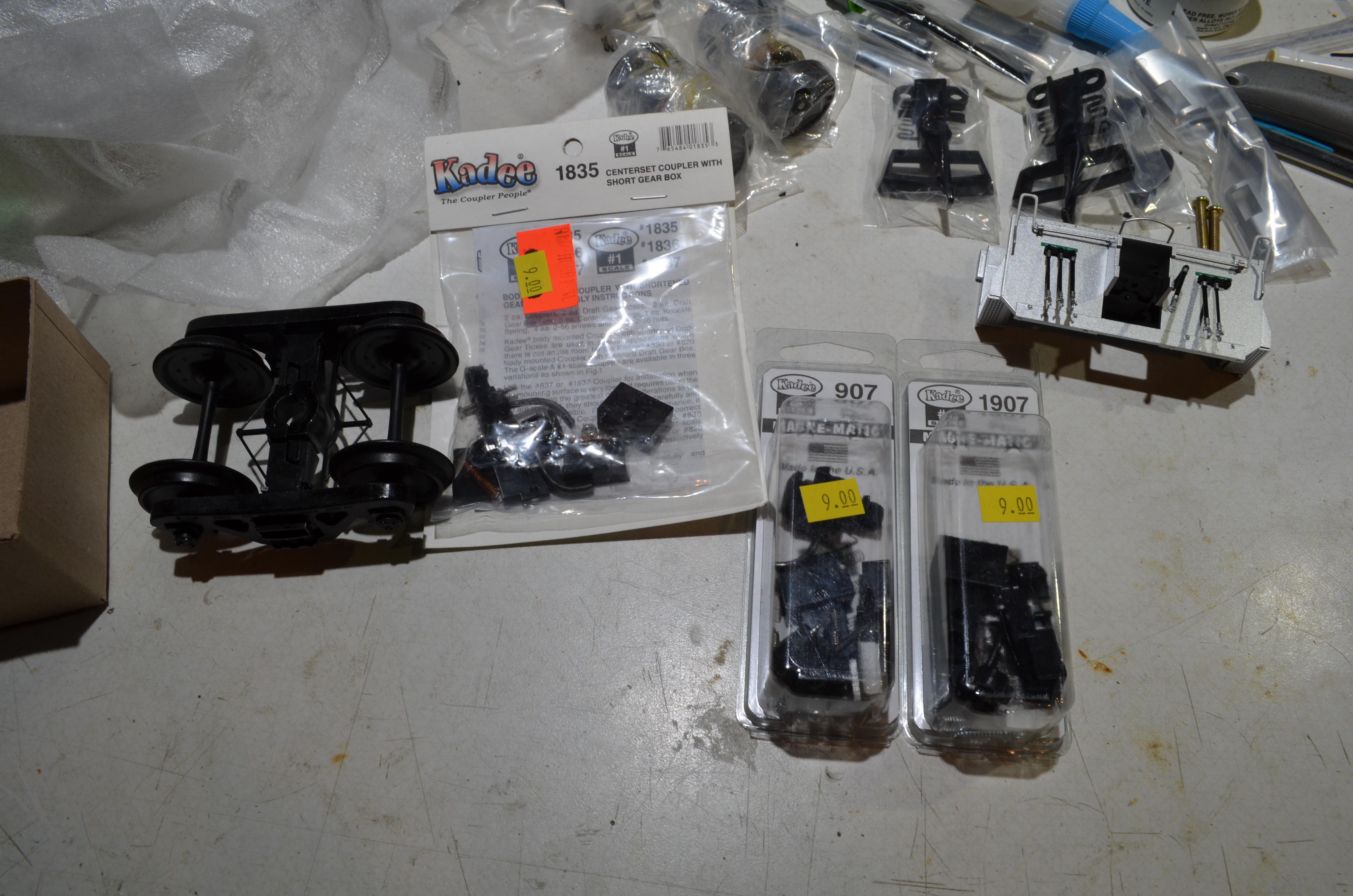

So what I found funny, is that MTH shows a picture of the KD couplers in the manual. They do not state what model # they use. They show the small box which I could not find for sale. It's probably the #835?
#835 G Scale Centerset Couplers with Short Gearboxes (kadee.com)

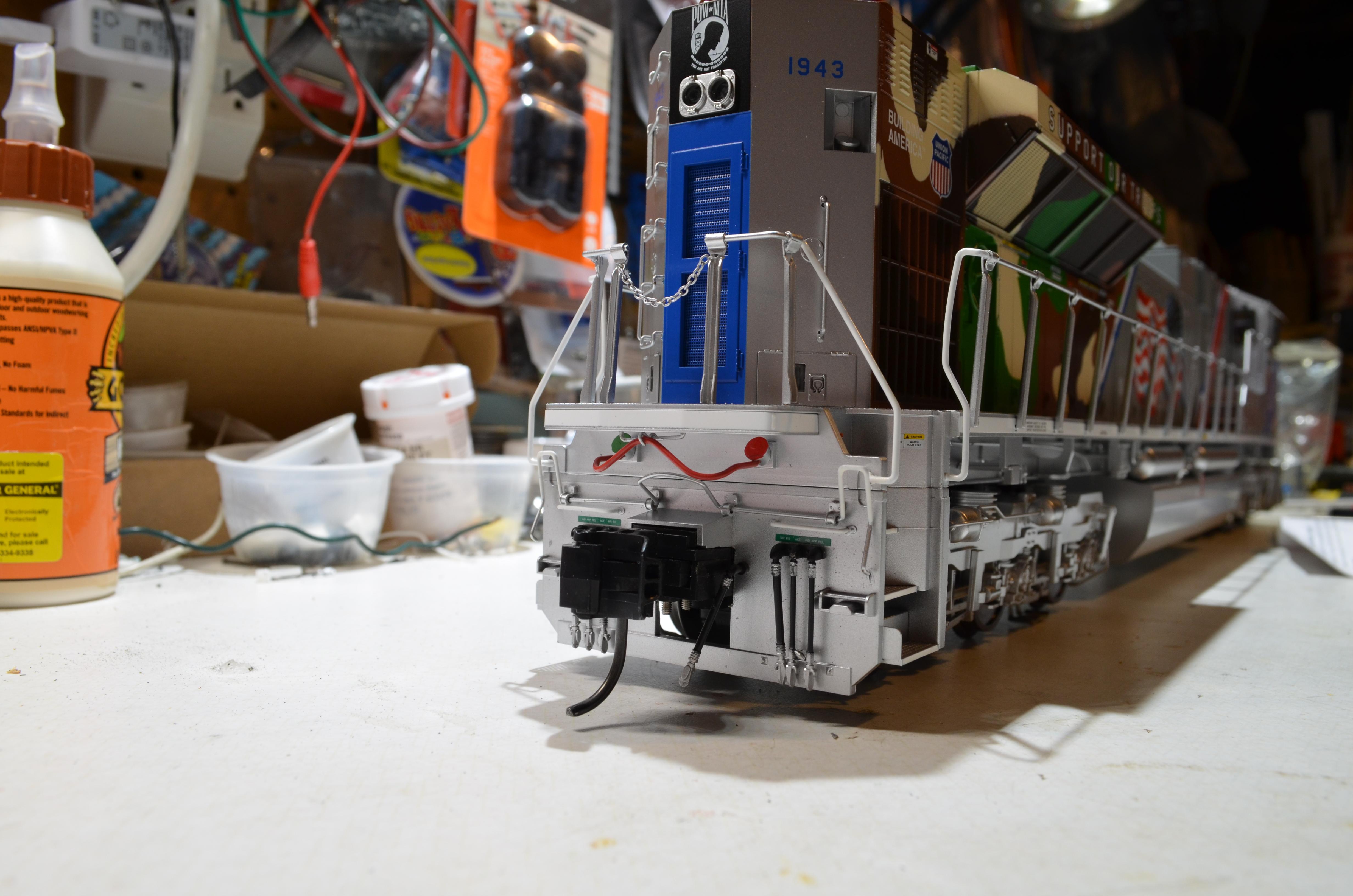

So I bought a couple different ones and went at it. All had larger width boxes than what MTH showed. I found the smaller box on the KD site but no one stocked it.

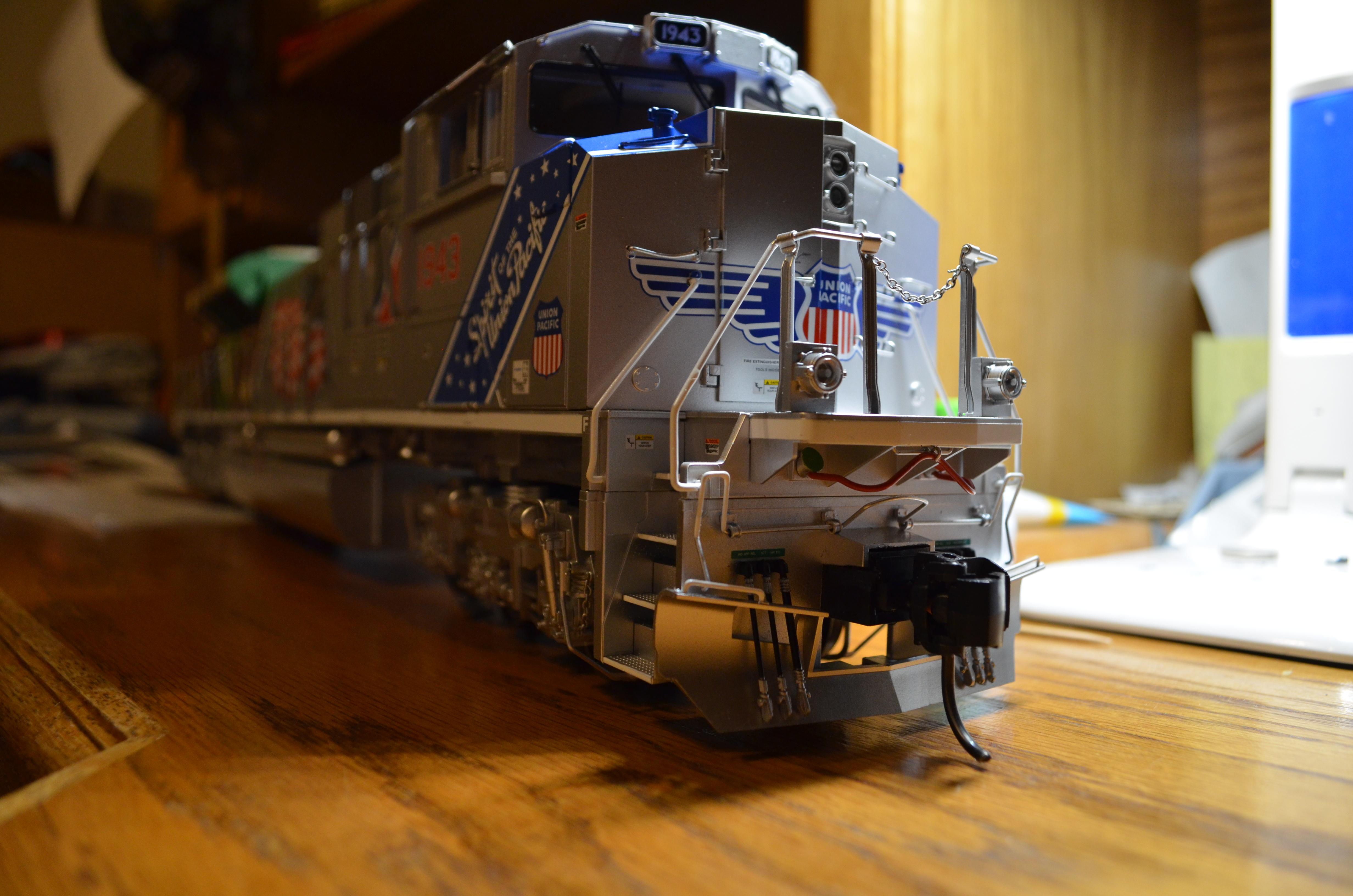

I used the box from the #1 coupler just because it was already cut short as needed. I swapped out the coupler for the larger G scale for better handling over my trackwork. I had to cut the pilot to allow the coupler box to fit where it needed to be mounted.
One note for me anyways, I think the whole box should be raised about 1/16" of an inch. I could have done that. I just went the easy route and slightly tipped it upwards for better track clearance for now. I think for the amount of work needed, I might try using the whole larger G scale coupler assembly (906 or 906R) for better coupler swing and spring assist on starts. These short box couplers only swing and are a fixed point coupler. I prefer the spring assist (long Boxes) for smoother starts pulling big trains.

I use the Gauge 1 smaller Kadees. Fit right on the holes in MTH.

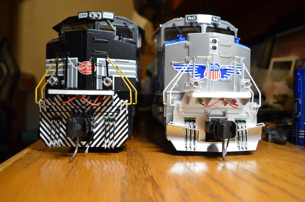

I prefer the larger G scale KDs so they match up with everything else on my RR. I now put the KD #907 on the front.
A little cutting of the pilot hole (wider), filing down the KD box lid width, and some sanding down the MTH mount adapter and she fits.
