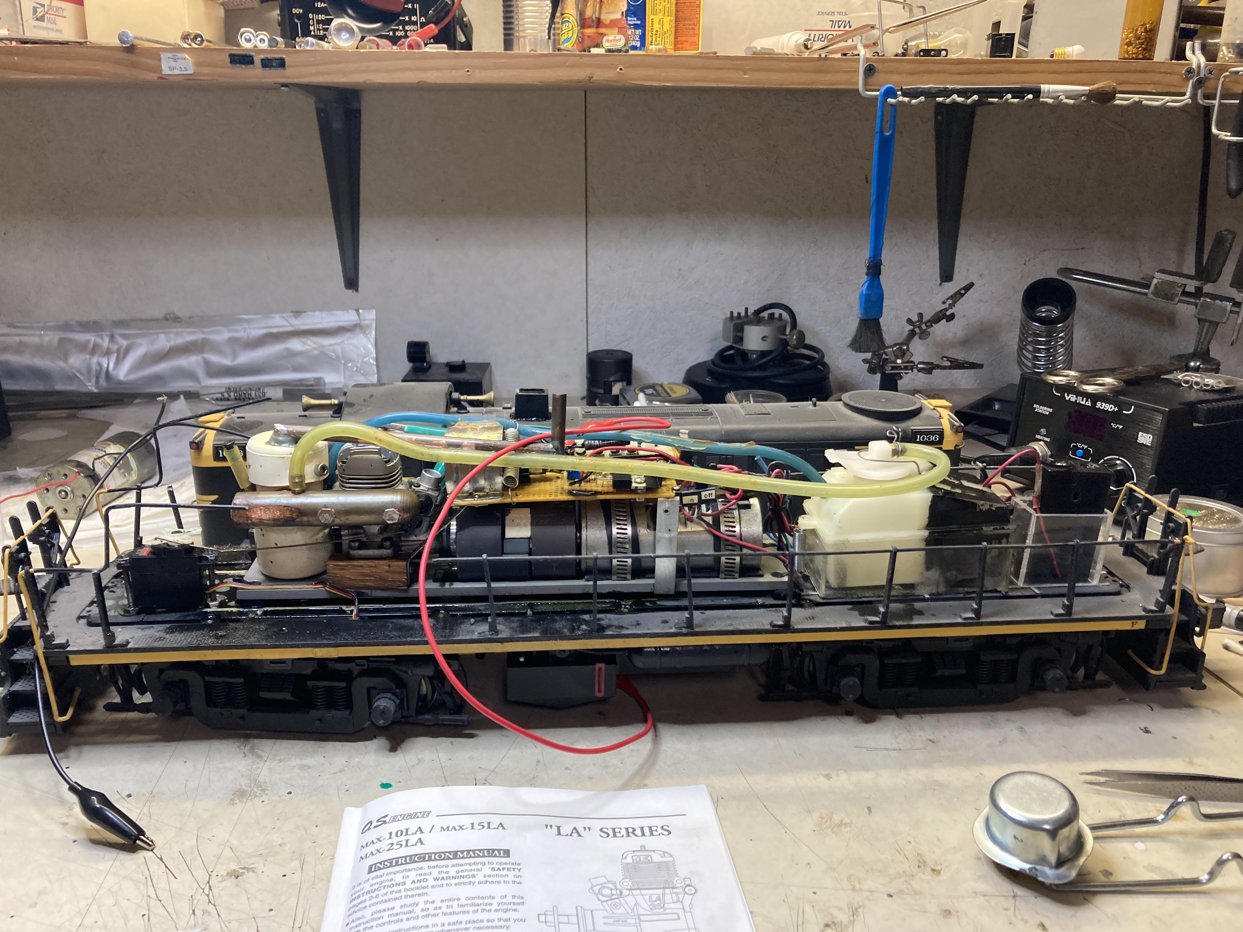

   Took this off the shelf after more than 10 years.  I was surprised to find all the electronics are still working, and even more surprised to have remembered the mods I made to it.  Still cleaning it up and testing, hoping to fire it up later today or tomorrow.
   Hideout Live Diesel designed my Jerry Hyde, airplane engine drives a motor that is used as generator.  Installed R/C so can be controlled remotely, enjoy.

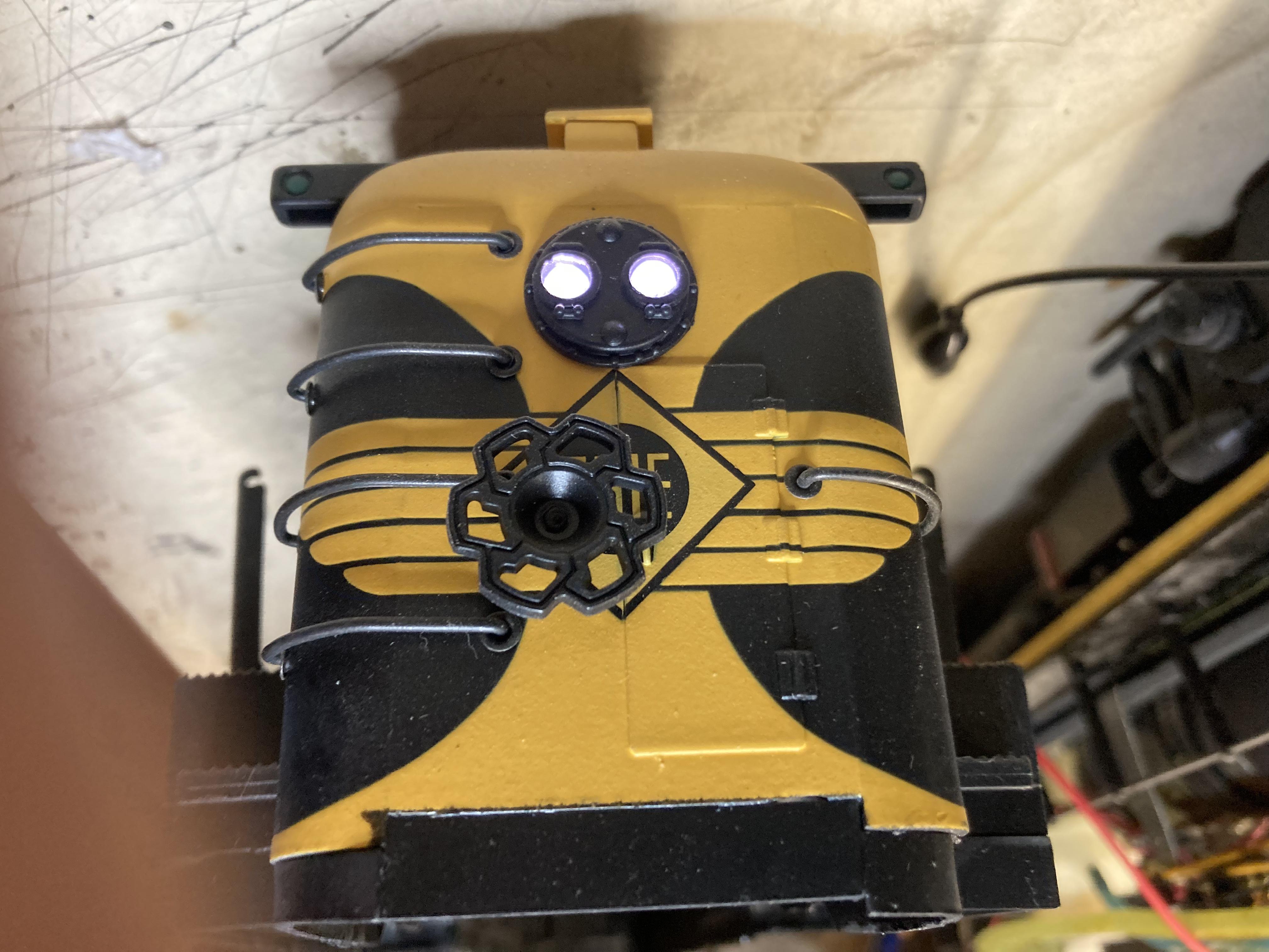

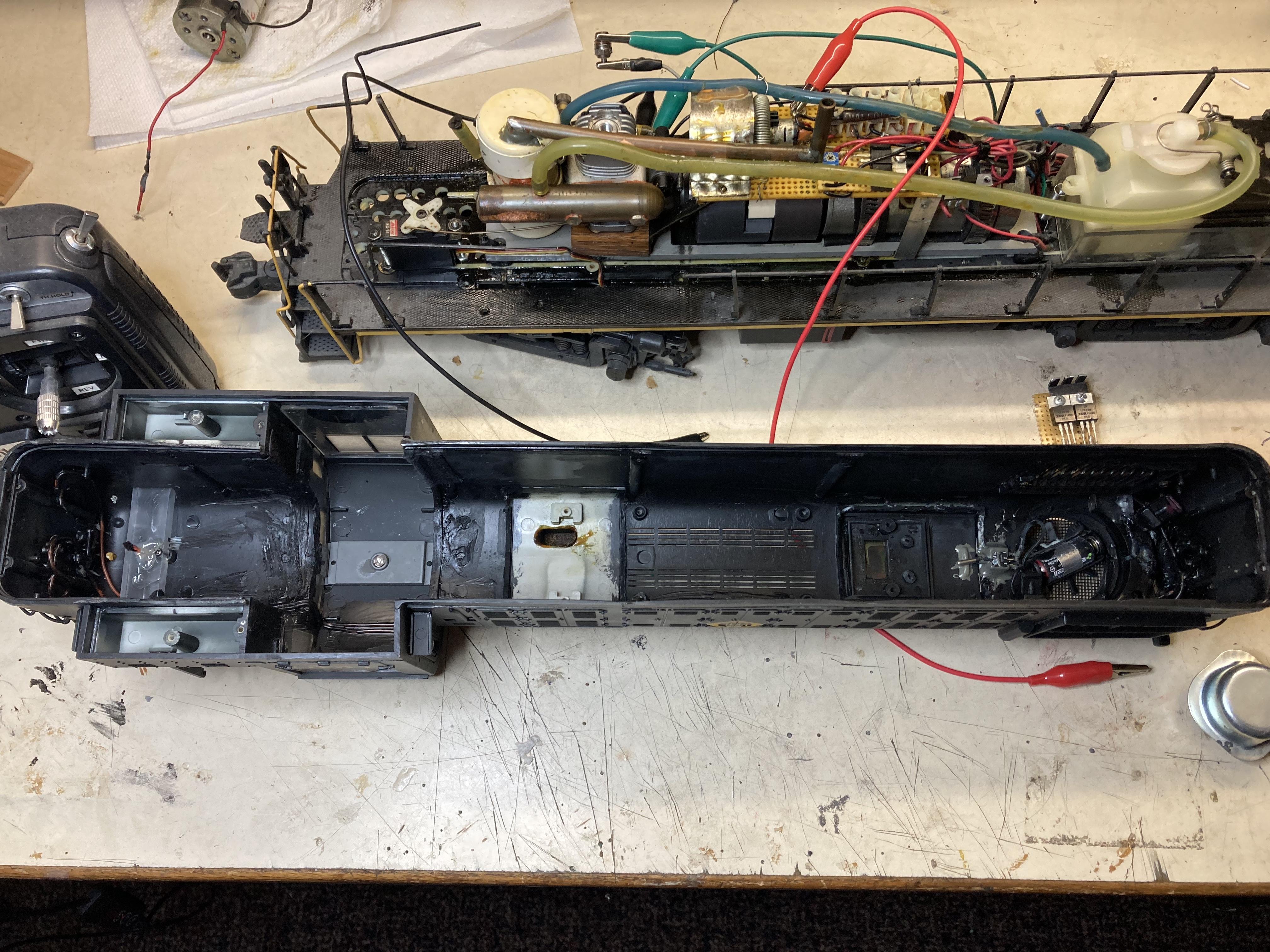

Ray, I can't take much credit, was designed by Jerry Hyde.  He sent me a box of assorted parts, the engine is my choice.  The design was hand drawn on a piece of paper.  R/C is what it is. Hardest part was  'hollowing out' the body while maintaining strength to hold it together, then squeezing it all into the narrow body of an RS locomotive. Hind sight I would have used a full body loco Taking this pic I remembered I also installed battery to operate the locomotive lights.  Despite the rude noise it is fun to watch and run. I admit, I did make some electrical modifications, other wise wouldn't be me.  Still havin' fun.

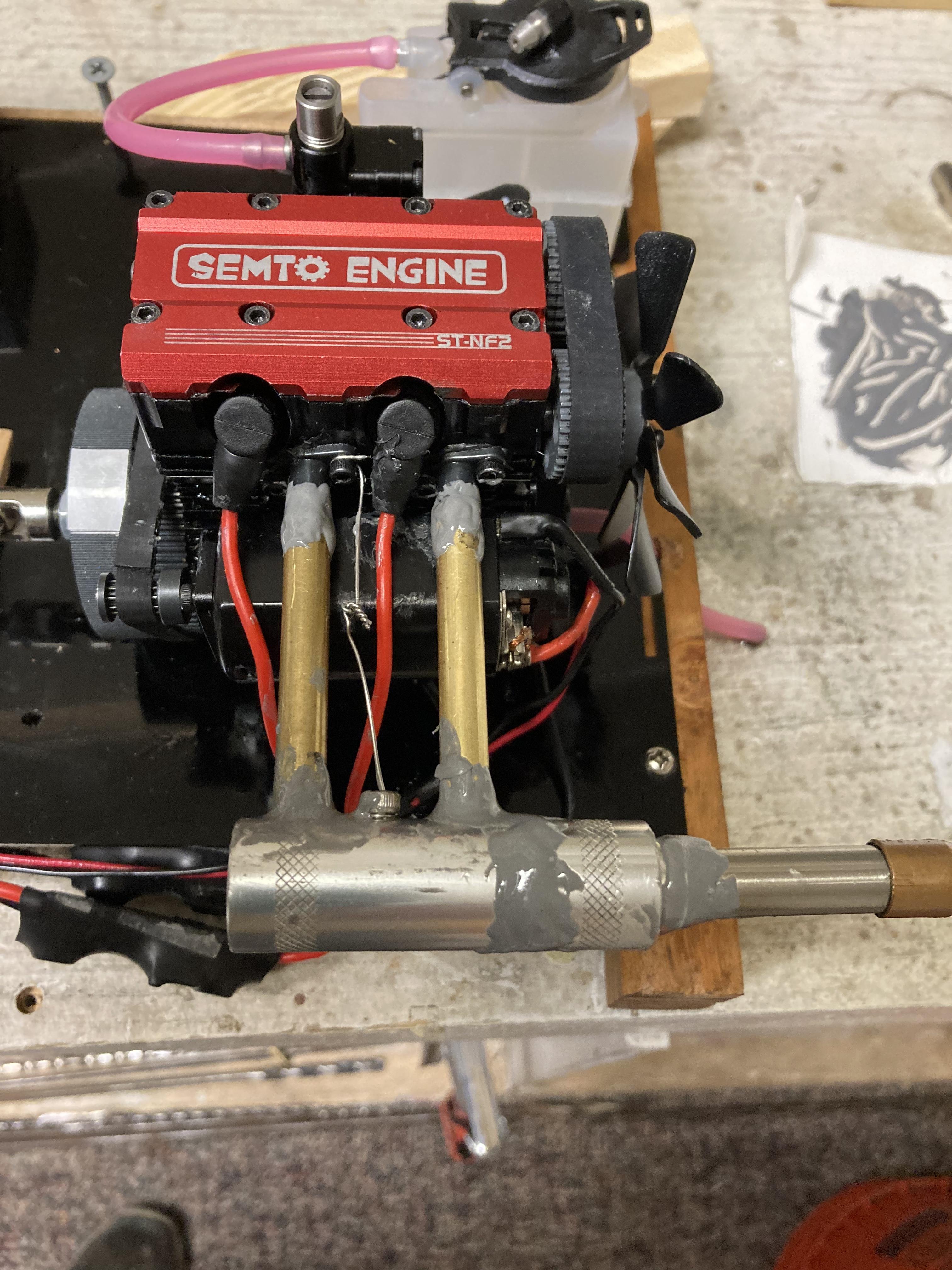

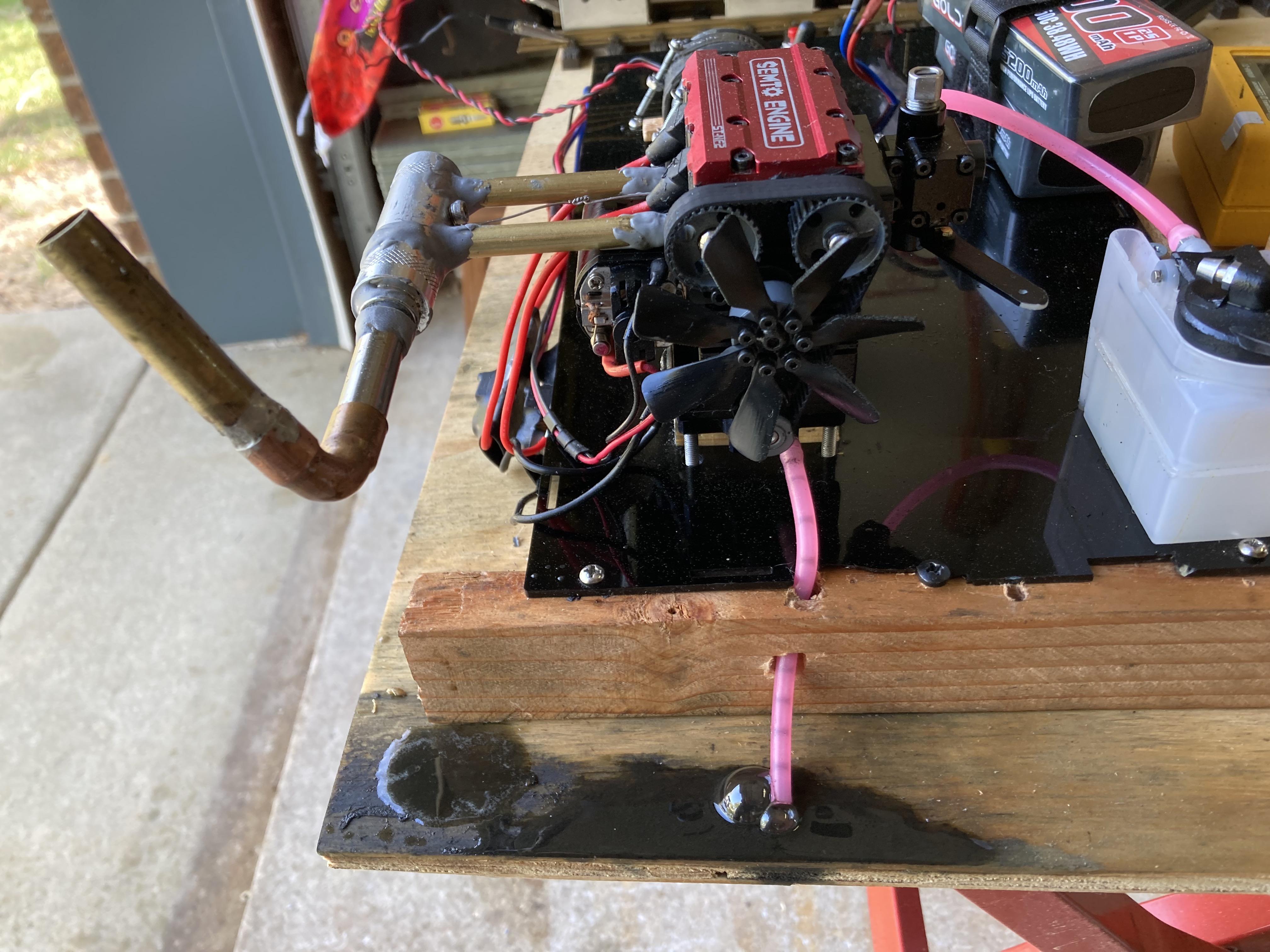

Joe, exactly what I am doing:  since it is basically a 2 cycle engine the lube is mixed with the fuel.  As is can not use it as I intend with expended oil leaking from the exhaust system joints.  Even thought I doubt it, must try, sealed all the seams in the system hoping to limit the mess to the exhaust outlet only.  Knowing how hot the nitro fuel gets, don't think the JB will hold for long.  If not, just 1 more error to add the list. Previous projects showed the nitro exhaust to be hot enough to loosen silver solder and the parts just fell apart.

SURPRISE SURPRISE, the JB held accept in one place, and that joint only had a skim over the top and nothing inside.  Ran 1 & 1/2 tank of fuel and only #1 exhaust pipe showed less than 1 drop of clear liquid on top.  Still hoping that EngineDIY sends the one piece exhaust manifold, but doubt it.  Did wonders for the exhaust oil leaks, but NOTHING for the stink, nose actually burns.   More tests needed, but for now I must TURN TO.     Have a great day all.

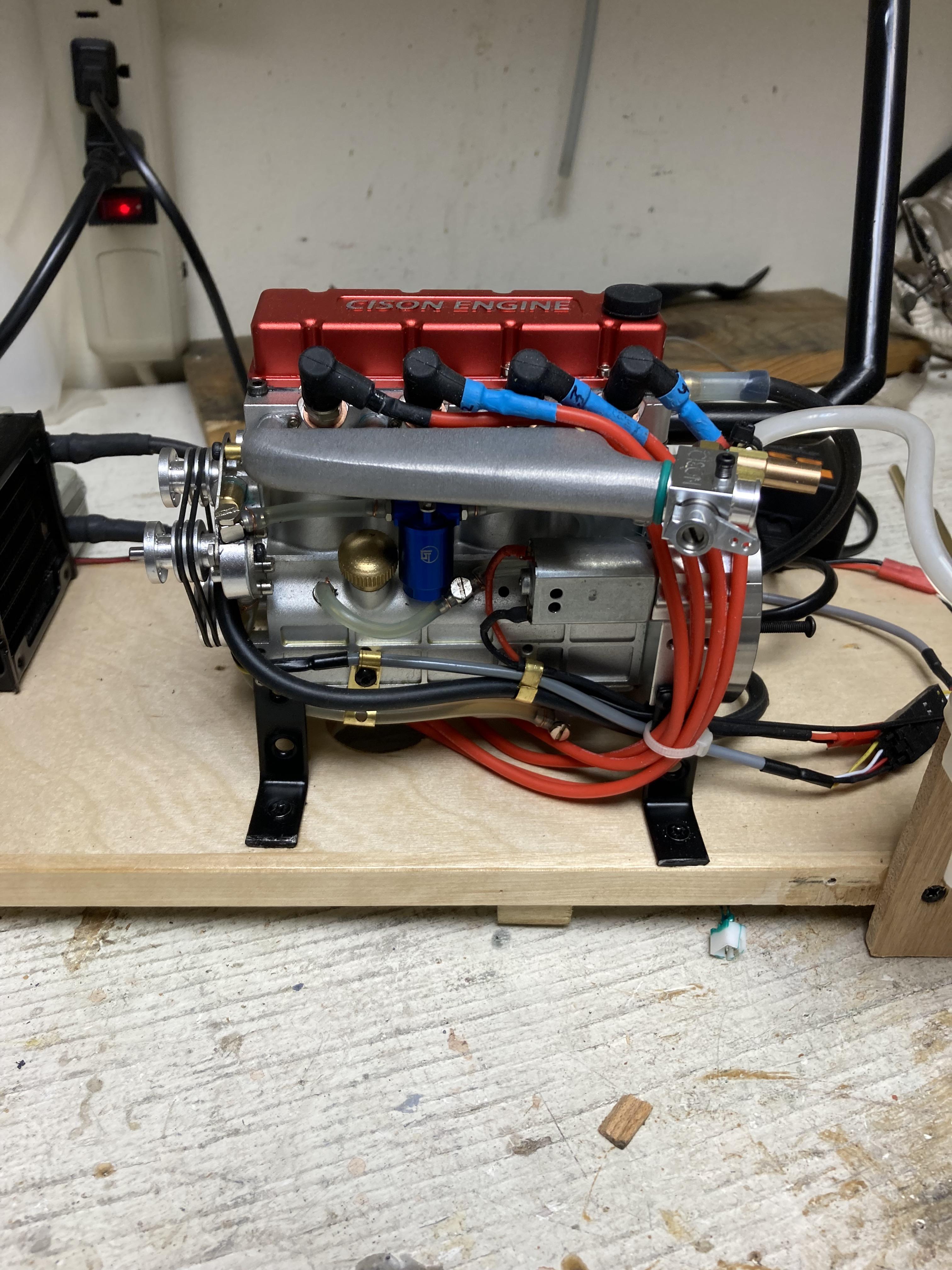

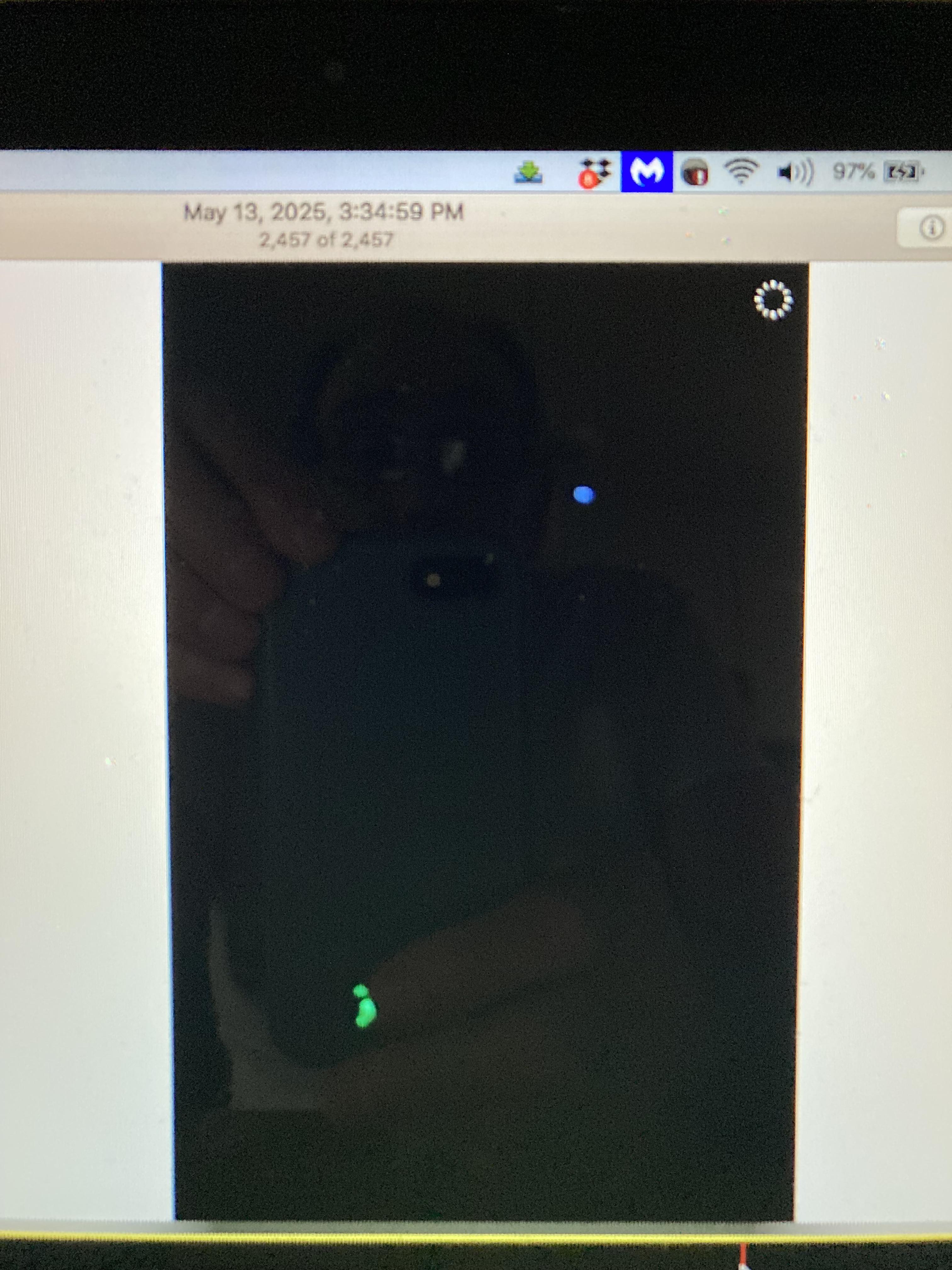

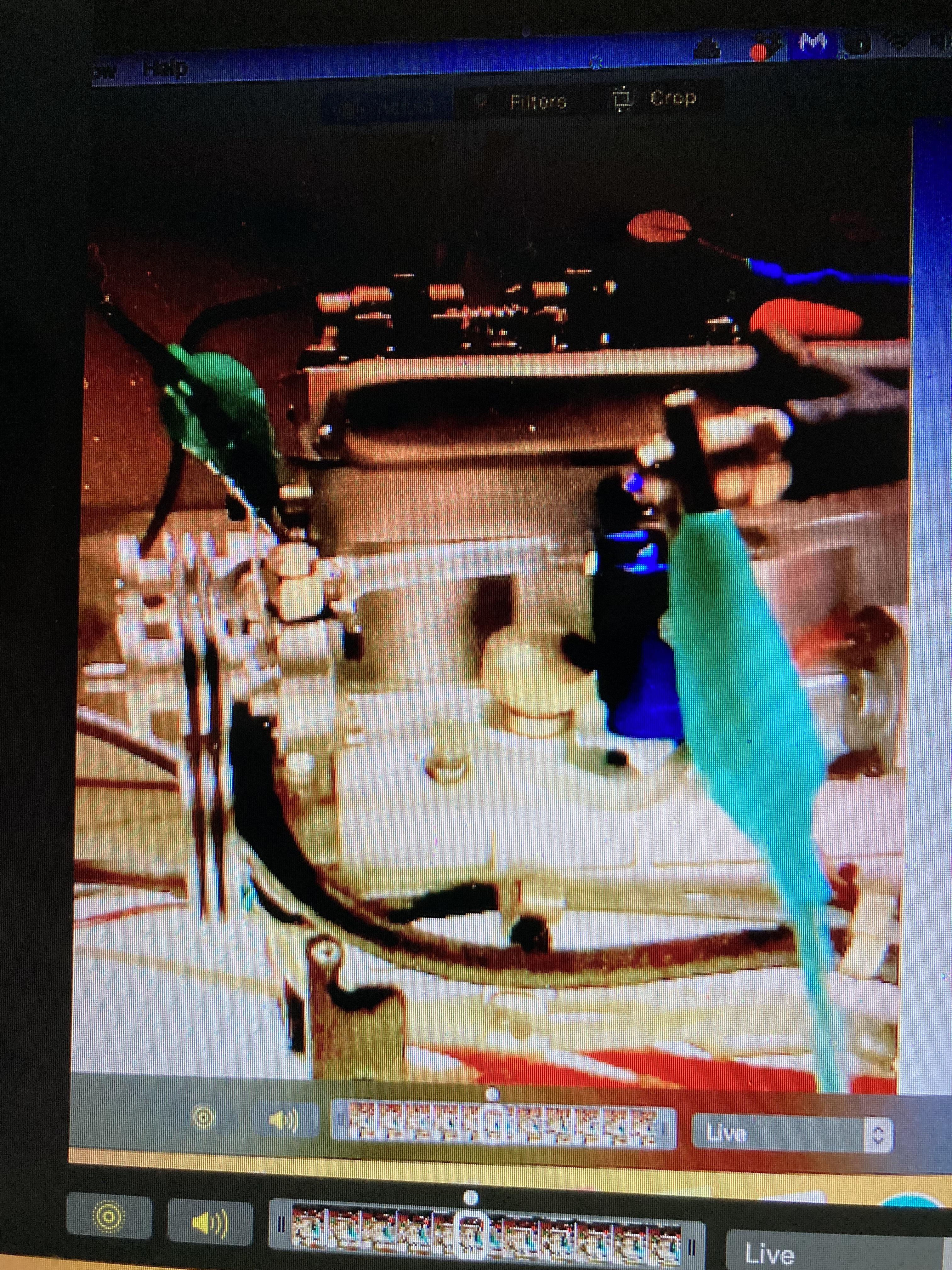

Also assembled a 4 cycle 4 cylinder engine that runs on gasoline.  Hoping that one will sound more authentic.  I am having trouble starting it.  Trouble shooting started with the Ignition system.   First one of these I have seen to needed to learn how it works. There is a sensor mounted on the block behind the fwd belt pulley  that activates the spark via a magnet on the pulley.  it flashes green and amber lights.  Ignition similar to the old Harley where both plugs spark at the same time, only the cylinder with the fuel air mixture will fire. Had to SEE it actually work, so set up demo using Slo Mo video.  First is pic of the set up for testing plug #1 & #3.  Then lights out to see when and if it fires.  As you can see when the green light flashes plugs 1 & 3 fire. The blue light is the spark plug firing.

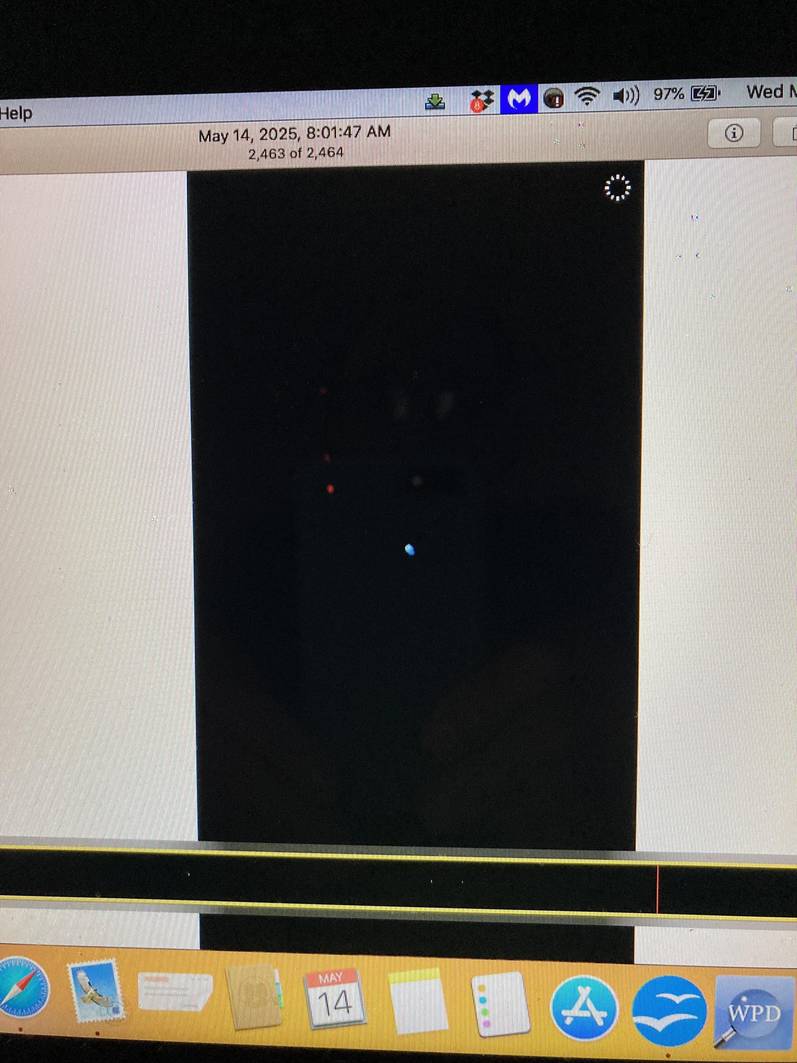

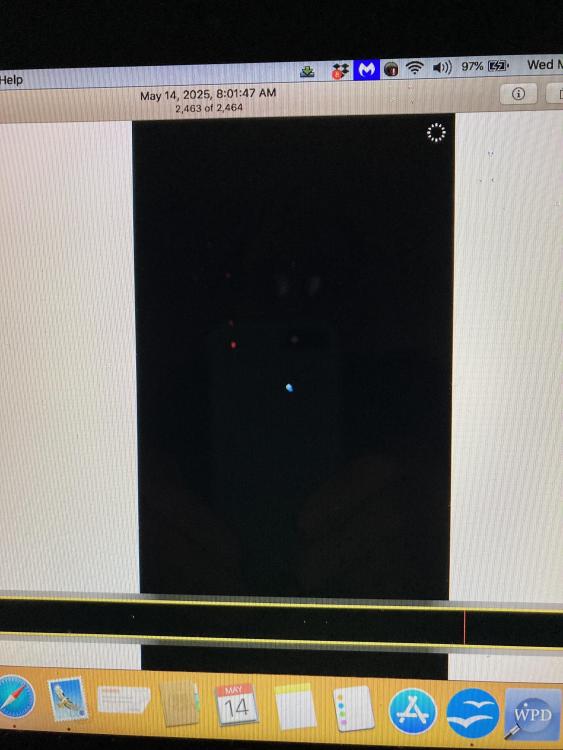

 Had to confirm the amber light activates 2 & 4,  and so it does.
 After all that I have to assume my problem is fuel delivery, which seems to be OK.  .  Now to re-assemble and insure that the green indicator is lit at TDC of #1 cylinder.  Since I presently have the valve cover off and made clear plastic side covers so I can see the crankshaft will be easy to determine TDC of the compression stroke. Any suggestions gladly accepted.    WNgVoVhaTLKi50vBxpUPww.thumb.jpg.95db0a1a045fbca530c289717be7e31c.jpg

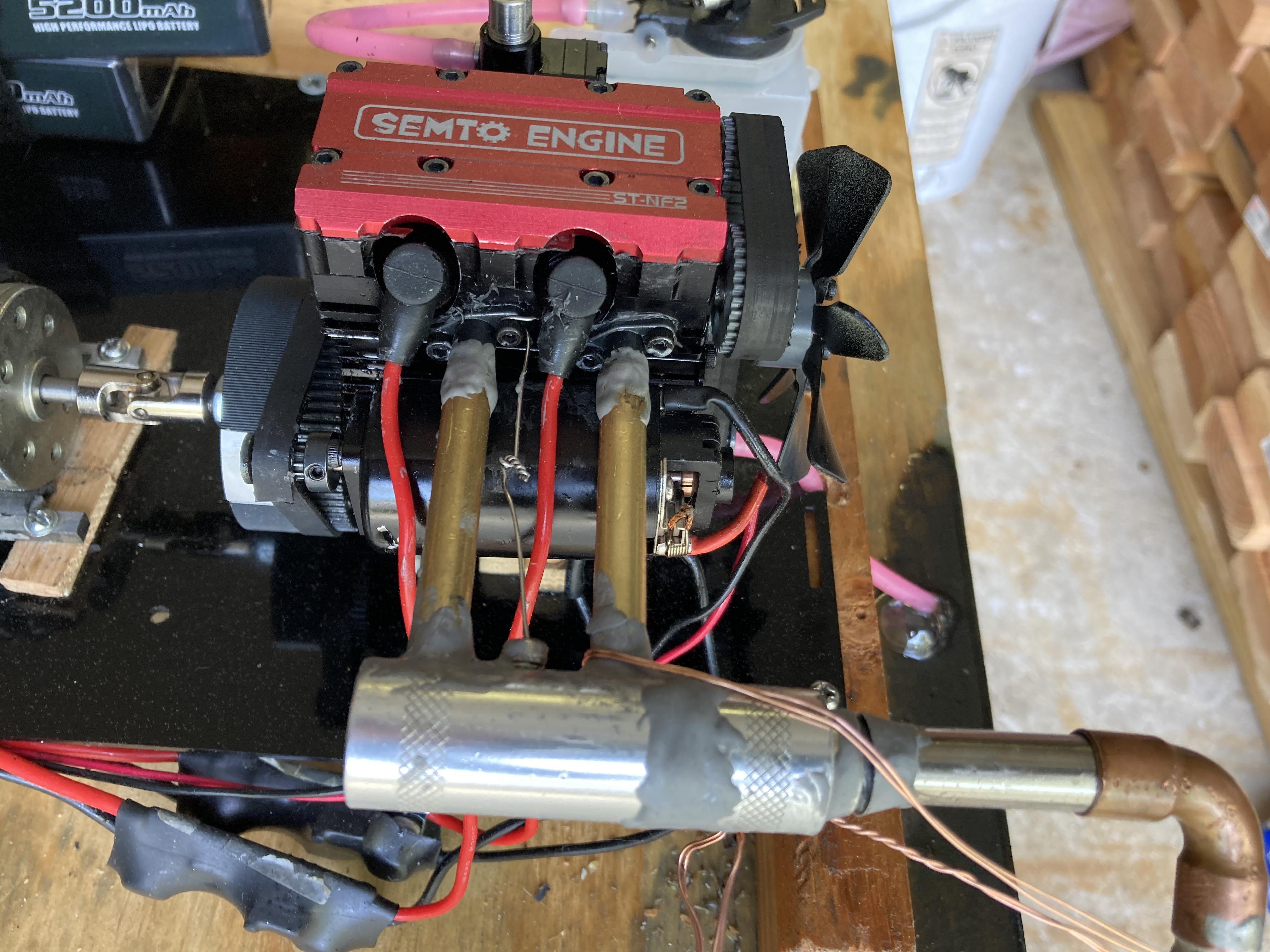

Tried to EDIT previous post, but guess there is a time limit to do so.  UPdate:  one of the brushes broke off the starter motor spring.  No fuel tank, no fuel lines and hasn't had fuel in for over 24 hours.  connected drill to crank shaft and the spun it, smell of gasoline was quite strong, so it's getting that too??  Ordered another starter motor, only $10, but takes about a month to get here.  Also played with the 2 cylinder unit and found the idle mixture screw was not seated properly so may try that one today.  Beginning to think I am into self abuse??
Made progress:  built a more solid base in hopes of it running quieter and with less vibration.  It seems to have worked.  Got the idle down to where I want it.  Even thought the vibrations are way down, the set screw holding the universal joint to the engine output kept loosening so ground a flat spot on the shaft, better.

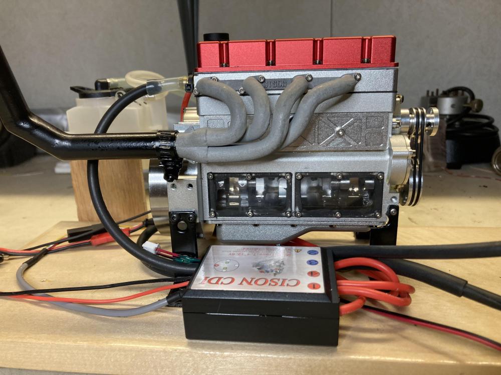

Well, more time and another engine on the bench.  BOTH of them have issues.  The first 4 cylinder, Cison, has fuel issues, came close to starting before the THIRD starter motor failed.  Even though I like the features of this, oil and water pump for lengthened running, has issues and EngineDIY is playing an Email back and forth game.  The other one is a Toyan 4 cylinder OHC that I got from Sterling in hopes of having better luck.  This one has electrical issues, doesn't produce spark at all.  Playing the same back and forth Email game, believe I am dealing with the same person even though using different Sites and Email's.  Didn't have thse issues when I assembled the Hydeout Mountain kit.  The Japanese engines ran great first crank every time, just not crazy about the sound and really want something more of th LOOK of an AMERICAN made engine.  Any comments and suggestions greatly appreciated.
