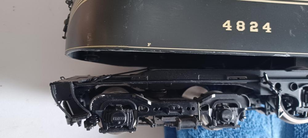

Well I finally came across a USA Trains GG1 for a decent price...and listed as excellent! Yeah right!

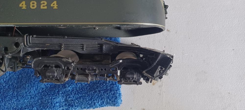

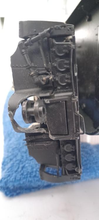

It was damaged in shipping as no original shipping wooden case. The truck frames got bent down and of course Ro has no spares.
Pilots took a beating...but Ro does have those...they think.

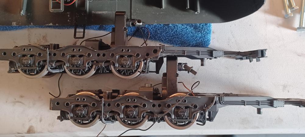

So I disassembled the engine and have one of the trucks jigged in a hyd. press with pressure on it so maybe over time I can get them straight!

Well I finally got back onto this project. I straightened the truck frames out and one snapped so I'll mechanically repair it.

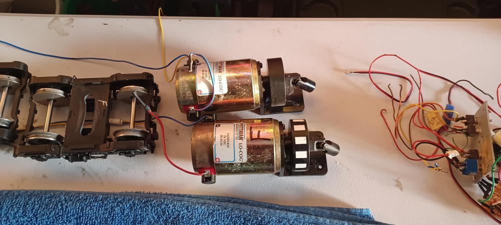

USAT used a striped tach for the OEM QSI sounds....
