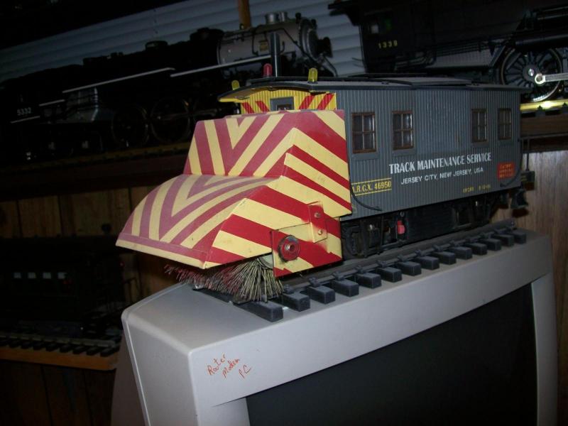

The rail broom was the one I was going to recommend if no one mentioned it. Not sure if it is still available as just a motor frame and brush.   Mine is battery operated, since I run mostly LS.  I built it into an old Aristo track cleaning car with a hood over the brush.   I made it when I had a ground layout.   Got to stop every now and then to make sure the debris isn't winding around the shaft,  will stop the motor.
   I adjusted the brush where it will also clean between the rails.          post-9-0-52910200-1401787909_thumb.jpg

Joe, it works just fine.   I usually use a Shay to push it around as the reverse motion of the brush has a tendency to push back on the locomotive  and I don't know if my rod locos can over come that.   Now that the brushes are lower than the rail it also cleans between the rails.   Doesn't take much, only one time around,  just got to be careful if any stuff wraps around the shaft,  my batteries aren't that powerful to just grind it up.  I only use it maybe twice a year.
    I know, the stripes are not equal,  looked good when I did it,   LOL    LOL
BTW, the curved area over the brush is nothing more than a cardboard tube that gift wrapping come in.  I gave it several coats of clear laquer to harden it, and DO DA.

    Your endorsement  of the rail broom is much better than mine,  I believe yours is track powered so there fore more powerful than the one I have converted to battery.  Looks like you also used an Aristo track cleaning car, did you also leave the pads on the bottom to further clean the rails???   Great Accomplishment, and thank you for sharing.
My railbroom is powered by 8 AA rechargeable batteries. Put batteries to opposite end of car from brush to get good balance. The key to get the railbroom to operate good is the elevation above the track so there is not a lot of drag on brush but still low enough to clean top of ties.

What I did was cut a grove in the brush where it would have contacted the rail so the actual brush was just at rail height and the rest of the brush was below the rail in the center and just outside the rail.   But then again I didn't have to clean the rail since I don't use rail power on the outer oval.
