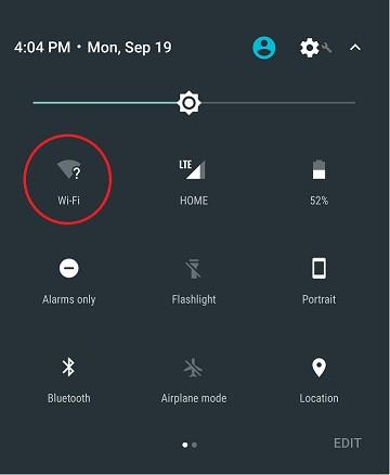

  • Manually close the DCS app in the Phone/Tablet:
    • Android:
      • Access the currently open tasks/programs on your device using normal process. (For some devices you will look for the square button at the bottom:
        • Example #1: (in GREEN)  DCS-Wifi-Android-tasks2.jpg.431e9f6711316f1a28e0207f3cf4133d.jpg
        • Example #2: (In GREEN)  DCS-Wifi-Android-tasks3.jpg.311fe7da62b9b6ae325df354598ce140.jpg
        • Note:  your Android OS may be different from what is noted above.
  • Next you will see multi-layered windows where you can then find the DCS app and press the X at the top right of the DCS app to close.

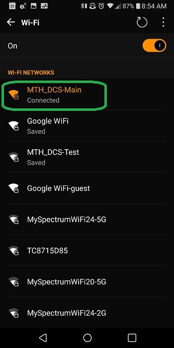

  • Confirm you are connected to the MTH Wifi network:  (Your MTH network name will vary)  (Default Password is: mthdcswifi
