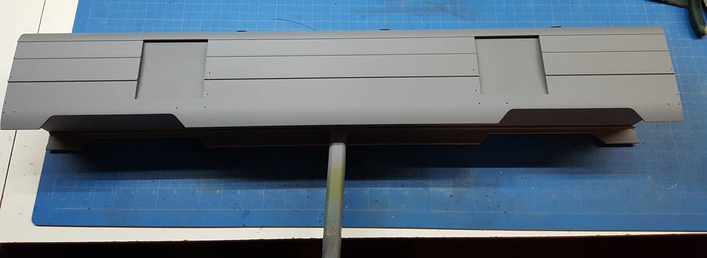

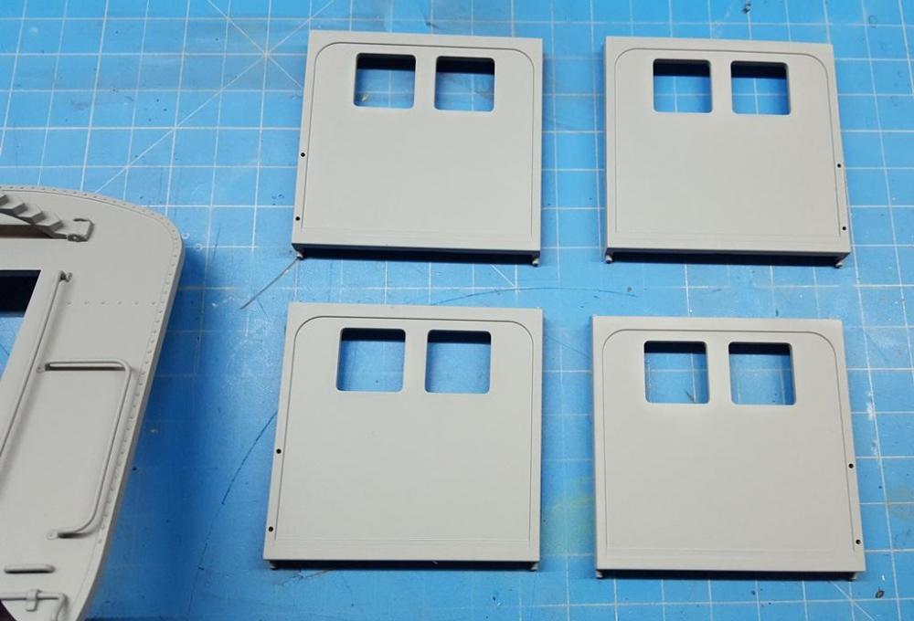

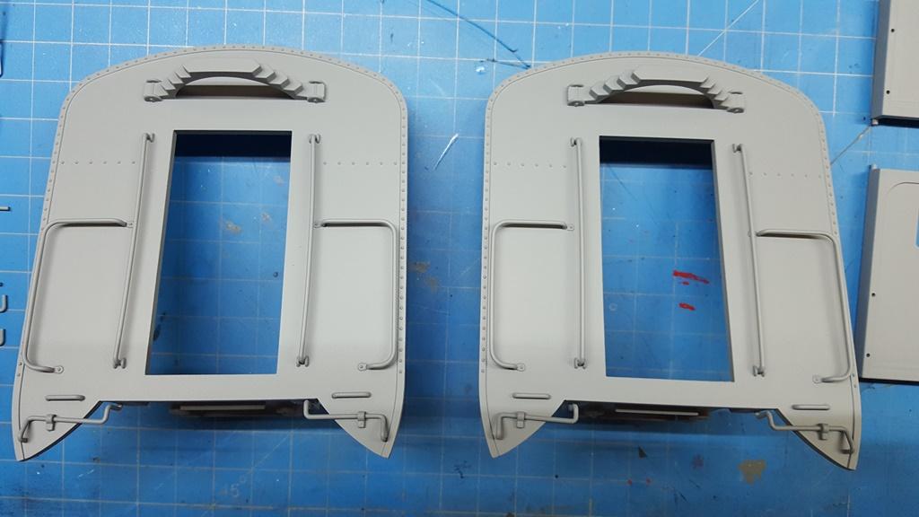

I dis-assembled car, stripped paint via soda blasting and primed with Harbor Freight self etching primer. That paint really sprays nice as nozzle is the easy press design with and adjustable fan.

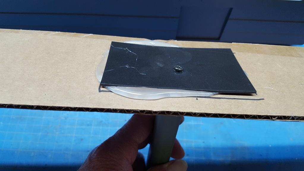

Here's how I handle these big bodies for painting. I cut cardboard that slides into the grooves in body where floor fits. Then I hot glue a wood "handle" onto bottom. Having a temporary "floor" in the car eliminates a lot of masking and the insides of car skirt are exposed for painting.
Floor slid out.
And I reinforced the top with a piece of plastic hot glued and with a screw run down into handle.
Next is color paint coats but need to wait a few more days as paint manufacturer states 72 hours between coats.
